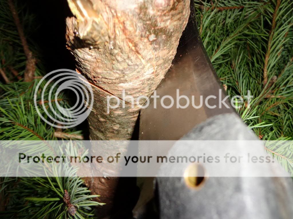

It is nice. Chopping machine. Probably wouldn't fit my hand though.
Thanks guys!! I do LOVE this knife. It bites deep and clean!!
Warrior the handle is huge, I actually thought it would be too big a handle for me but my hand lock in good at the top. I honestly think you would be fine.... you can compare it here a little to the BK9 and others....
