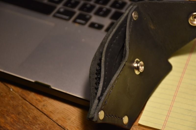

Not a great debut for the new Council Wood-Craft Pack Axe
Do you know what kinds of wood you were in? On the Olympic Peninsula there is a lot of hemlock. Hemlock can have knots that are glass hard. Any axe made will either chip or roll if it finds one of those knots. Not every hemlock knot is that hard. But you find them.
The mask does have a welt. There are rivets, too, but they are widely spaced and the bit can slide between them. I'm pretty sure that the bit nestled between the welt and the outer leather. Then, when the box was dropped or mishandled, there was enough force to push it into the threads and slice through them cleanly.
There are hemlock here, but I was mostly hacking through old-growth salmonberry, with some elder berry and devil's club mixed in. The downed branches were mostly alder. The conifers I don't know because they were covered in thick moss and partly decomposed. It's possible that there were intact hemlock knots inside some of the conifer branches. There was solid wood at the core of those branches.
Well, that was fast. I just received -- on a Sunday night -- a very nice and detailed email from a Council vice president. He had seen the photos I submitted. He said that the bit should not have suffered that kind of damage, short of beating it on concrete. His best guess was that there was some human error, probably when the company was switching heat-treating systems. The new heat treating system is apparently foolproof.
From the color of the head and bit in the photos, he said that it appears this head did not get fully heat treated.
The acuteness of the bit is the result of using premium 5160 steel, which he said will not chip or roll. The hardness is very close to 54 Rc on each Wood-Craft Pack Axe. Council has such confidence in its new heat treat system and the steel that it gives its head a lifetime guarantee.
He is sending me a replacement.
It is certainly nice that he's sending a replacement -- and new sheath -- but that he took the time on a Sunday night to give such a polite and detailed reply. Much appreciated. I guess it is a great company.
