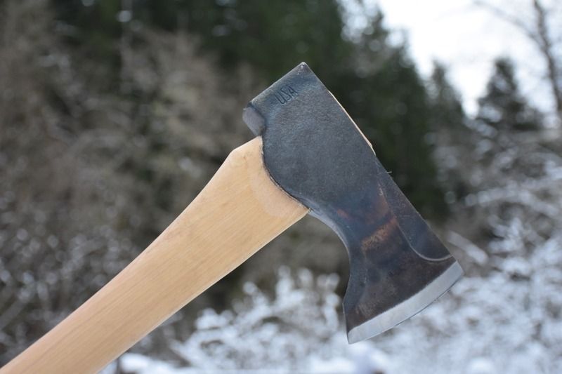

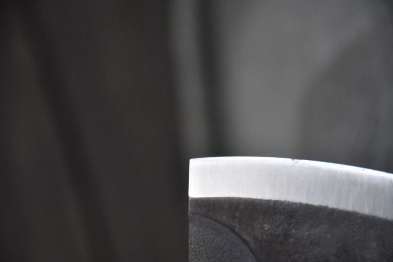

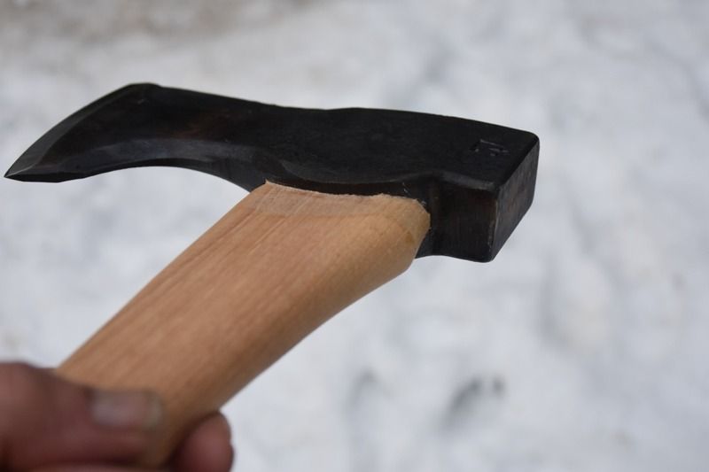

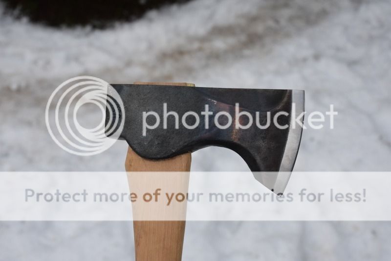

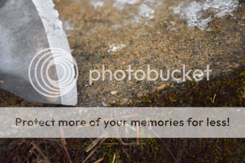

I love Council Tool axes, but I see there is something weird specifically with the axe we are talking here. I see the sheath and bit faults are too common and they continue selling these axes. Two or three days ago a friend received this axe with the same problems seen here, I suggested him to contact the maker as I see they change faulty axes without any problem.
I don't know the percentage of faulty axes but here in Europe it seems we are talking about high one. The point I want to talk about is that they continue selling these axes allthough they know they are having problems with them. I know recalling the axes you have produced from the vendors who still haven't sell them is expensive but not doing it places you in a worse situation in a long term.
I don't think the heat treatment would be the problem, I own several Velvies and all their heat treatment is perfect. Making a so bad heat treatment in a 25º bit is also very improbable, the geometry is too wide (it's in the splitting zone for our local standards) to ruin it in the scale we are seeing here. I think the problem is in the grinding after the heat treatment, during this process they will heat the bit too much destroying the heat treatment.
