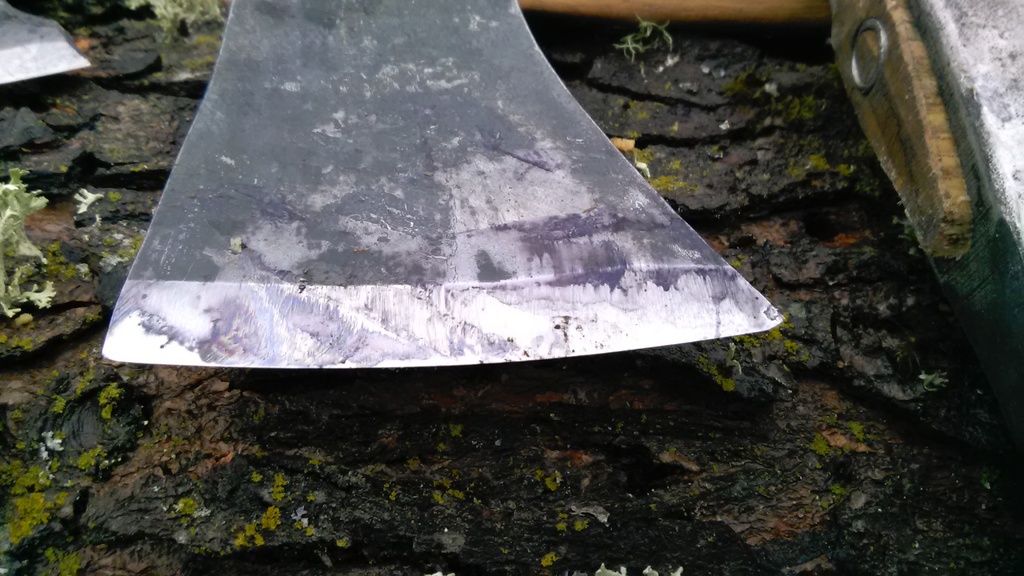

I'm pretty sure that the colors on the edge he was referring to were actually a rust preventative. Certain kinds can produce a rainbow-like iridescence on the surface of the metal.

Council Pack Axe 19 inch I think their specified hardness of only 55 RC is too soft.
Rockwell is a measure of compressive strength no? Tensile strength is at issue here wouldn't you say.
Well I got an immediate and fulsome offer of a replacement from Council Tools 5 minutes after sending an email.
I personally don't see the issue. It's an axe, and corners get dings. My GB came from that factory that way. Fresh edges are also known to sometimes be a little soft due to the heat of grinding.
But I'd like to see how your your replacement goes.
Was the board a laminate? Because those are much, much more durable and have hard spots compared to actual tree wood.
Let me be cynical. The problem is likely not the steel, the heat treatment, or the hardness, except as incidental factors. It is the ambition of the design, which appears to attempt too much. The thinnish flat grind and sharp corners, etc., make it suitable for finer tasks such as carving, while the phantom bevels and other features appear to tempt use as a general purpose axe. The design probably does nothing that the Hudson bay can't do as well or better, but it looks like it can. If these were selling for $50 or so, I'd say, it is what it is, but it really begs to be held to a higher standard, as do other boutique axes, which often have similar form before function deficiencies.
On the corners, I'd like to point out that the Michigan pattern, along with several other time-tested designs, has rounded corners. That is not for looks.
