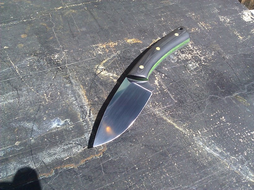

I bet man!! I love this one below, i saved the picture soon as i seen it LMAO
Heh.
You know, I REALLY like that one too... was making it for myself - had it about halfway done - and then some dude PM's me and says "hey, how about a 100% Mountain knife??" Well it's better off where it will be used, so I ain't complaining. ;)

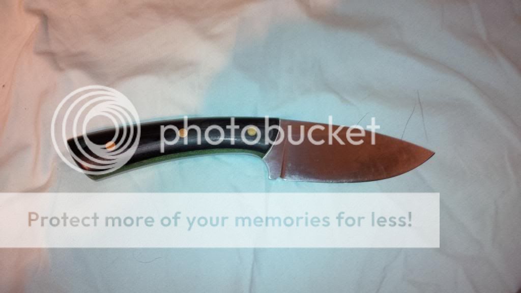

Just wanted to show off what I've been working on today.
My first time making wooden knife scales and attaching them to a blade. I learned a lot. Like make the extra trip to the store and get the 30 minute epoxy instead of just using the 5 minute stuff you already have. Man that stuff set up quick and almost ruined my whole project. Think to much hardener came out. What a mess.
Anyway, I picked up a few pieces of nice wood at the store this weekend in preparation for some Becker projects I am planning to do. While I was waiting for the etchent to work on my new laser saber 16, I decided to mod my Gamestalker.
Put some ebony scales with stainless pins and a brass lanyard hole. If any of you have this knife then you know that it is a skeleton tang. I cut a pice of ebony the same thickness and shape of the two inner cutouts and epoxied it in with the pins.
Here's a few pics of what I have so far. Gonna do some more sanding on it but this all I could stand for today. Wanted to get enough done so I could at least use it.
Looks good from here! Of course I can't be 100% sure without it in hand....
