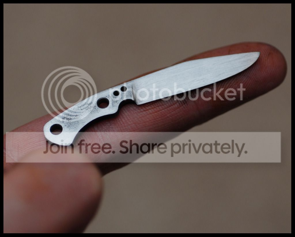

Thanks Jonathan and Xander. I got caught with my pants down on last years Mini KITH with only 1/8" (Or Thicker) steel on hand this is just under 3/32".. Hamon? what is a hamon? ;)
either you have a HUGE finger or that's a really small knife :D
I love it, way to go....that's encouraging right there !!! is that 1/16" drill bit on the top two holes??
haha! I do have a huge finger, and yes 2 holes 1/16" and 2 1/8" not too happy with the placement of the small ones this may be a trial run.
What I have done in the past is drill all my holes first and then lay out my profile. Sometimes it easier to bring th edges in to center the hole than to put a hole in the center, especially on guards and pommels. On that US M3 I did last year I think I made 3 guards and two pommels after the numerous attempts to get the punch process figured out.

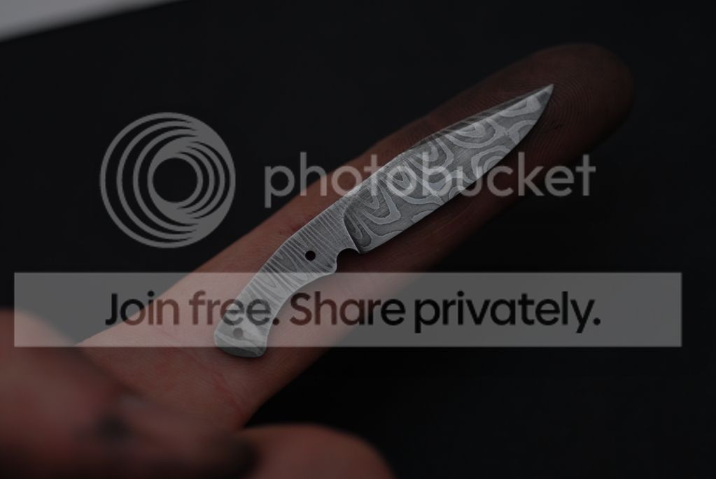

Saw this today and gave it a try. First mini. I believe there's an assumption that it will be soooo much easier because it's so much smaller. HA! Total misconception for sure. Humbling and exciting. Started a damascus bowie with nickel silver bolsters and mammoth ivory scales. This should be fun.
Great to have you! Show us your work, we all love pics here! Yeah, the finish work goes easily because it it much smaller, but trying to start with 80 grit really leaves deep scratches on such thin stock! I usually start by roughing in at 120 and jump to 180 for the bevels then 320 and up for finalizing shape. I try to go to 600 pre HT.
-Xander
Well I took a bunch of pics but only a couple came out. Could it be because the camera lens is about 5inches away from the subject material?
This was taken for scale. Blade is raindrop pattern damascus with tapered tang. Bolsters are Nickel Silver bought at Blade last year. Scales are mammoth ivory, they have some great color hiding under that bark.
Took this after heat treat, sanding to 1000grit and etching in ferric for a while. Bolsters have been worked on a bit and the mammoth scales have been flattened and dovetailed to fit the bolsters. Going to pick up some sterling wire to pin the scales on. Do not want to use anything as thick as that 1/16" stuff I used for the bolsters.
That's what I got so far. May make some changes along the way. Considering a sheath, but not sure. If I could find a baby snake to use on the sheath I just might do it. It was fun grinding the bevels. These li'l guys heat up quick. And it's hard to put them in the knife vice to hold while hand sanding.

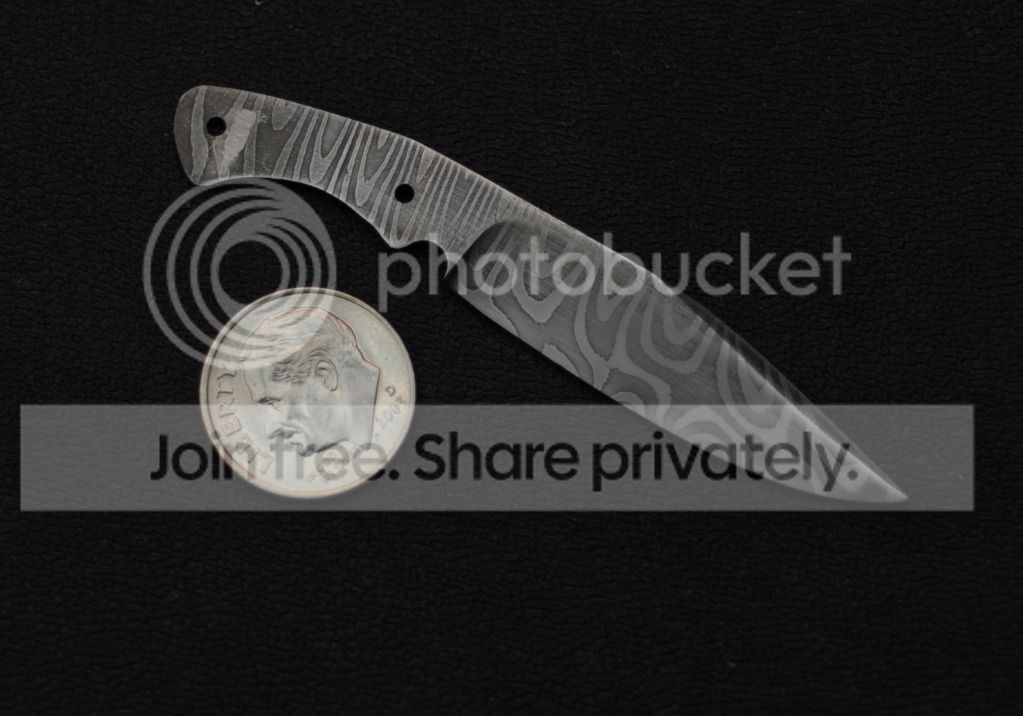

I spent some time in Oregon with Mike Turner forging for 3 days. He had a piece of 13 layer - 15n20 / 1084 Damascus that was 5/8" square and he twisted it up to approx 6 twists per Inch.
I pounded a small piece of it flat and decided to use that as my Mini KITH Material... My fingers are burnt!
Specs:
Steel: 3/32" - 13 Layer 15n20/1084, Twist (Mike Turner)
OAL: 2.34"
Blade: 1.34"
now to the handle.
Ryan that turned out sweeet my friend, I love how the layers are nearly 90 degrees on the handle and you where able to 5 stars on that little blade. Nice work, shame you have to handle that and cover up that tight twist.
Nice job on the damascus Mike. I will do my best to leave a little of the ricasso poking out to show that pattern.
Well if I did not go crazy and twist that billet in half trying to get that as tight as it could you would have never had that piece ;). Now get back to work :p.
Haha, It is Tempering... cool your jets Brother!
