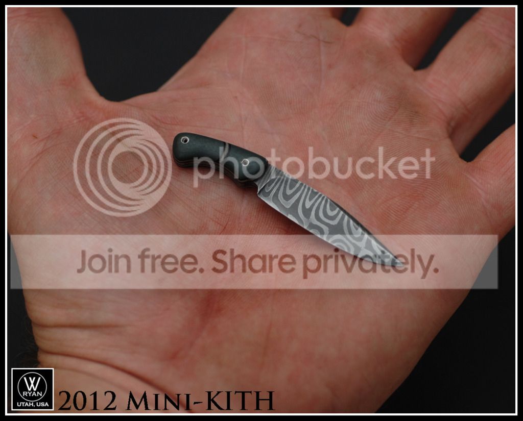

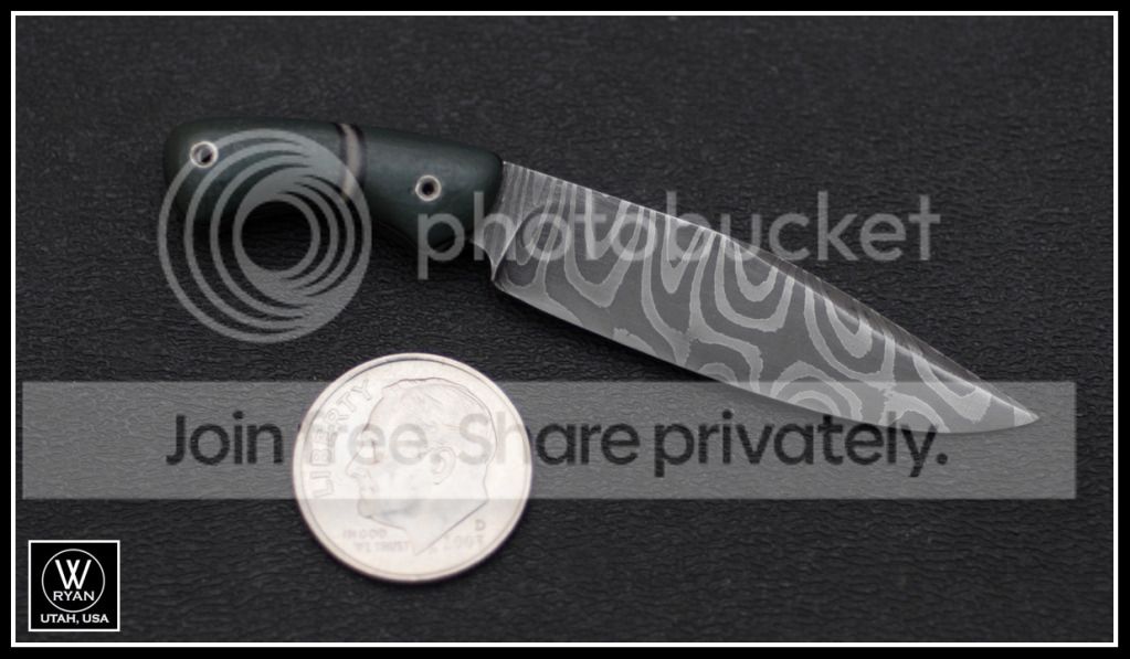

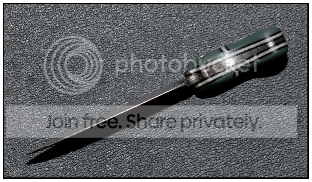

BTW, very nice knife, Ryan... but seeing yours reminds me why I chose not to use damascus... you can never get the pattern to scale down to a size that makes the knife look full sized.
