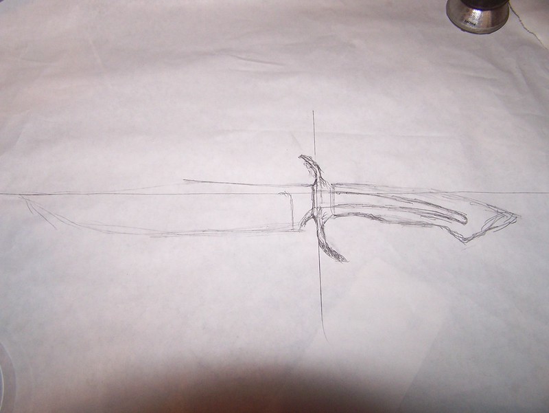

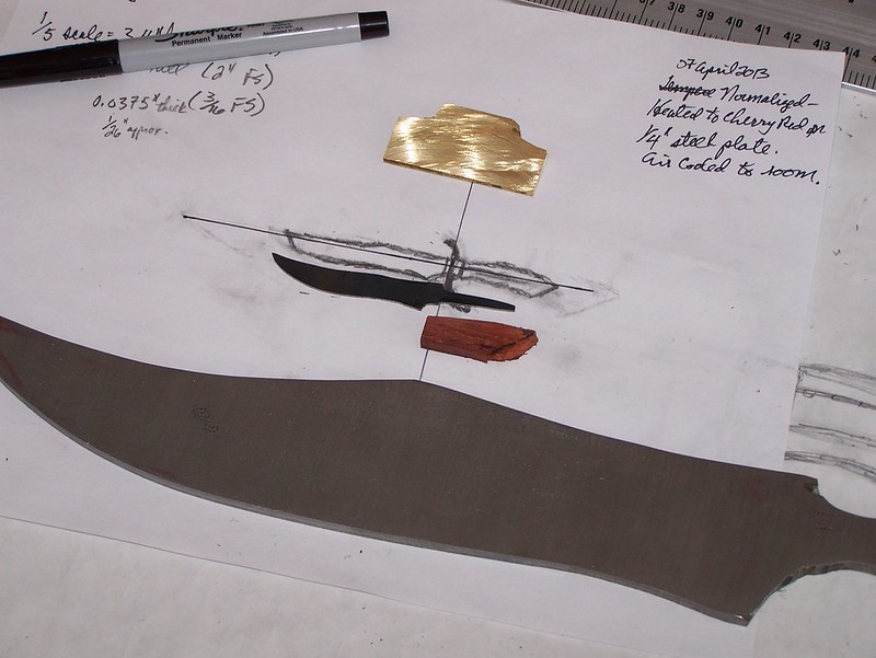

OK, I guess I'm the Keener here. (I'm really excited about this!!!) I had some time to start working on the knife today, and based on some family issues, the time to play was appreciated.
This is the drawing of the full size knife: I am making one for myself and for my brother as B-day gifts. We are born a few days (2 years) apart, 21 May 1973 for Mike, and 26 May 1971 for myself.

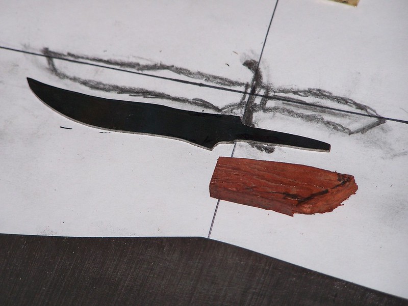

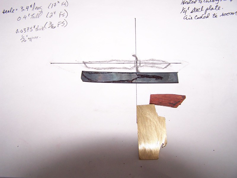

Here is the steel marked out (it is an industrial planer blade from my uncle's cabinet shop. He said it was "high carbon German steel," which I an assuming is a D steel derivative. It rusts, but much more slowly than anything else I have, excepting stainless of course. The size was nearly perfect for this project. If anyone has any ideas what the steel "probably" is, I am looking for suggestions here. I normalized the steel, bringing it to a cherry red on a plate of 1/4" mild steel, and air cooled.
The handle is Padauk and the guard will be brass:
Compared to the full size blade:
I am open to suggestions and feedback.
Looking good!
Deffinitely try some testing with that HT schedule. Possibly, an old American made file will be a good choice if you're using reclaimed steel. If you need, I can send you a small chunk 1084 in 0.130" thick.

I have about 48" of this steel. I will try a few pieces in different oils and water to see what hardens without breaking. I have several known steels here, but this was perfect in size. I will get the model of the planer and see if I can get the material specs from that. It is definitely a VERY good steel. I have 15n20 that is a bit too thick, but I can stock remove or forge it closer, as well as some 1084 which is double the thickness I need. To be clear, the blades are 24" wide, and were from an industrial power planer that had adjustable knives for radius planing ($20,000.00 tool). This steel is not a "probably a good steel" and has cut miles worth of hardwoods. They are the upgrade from the standard L6 steel. They just couldn't be sharpened anymore as they were getting too small.
Its not so much if its a good knife steel, its knowing exactly what steel it is so you can HT it correctly. Now fr minis gettin it close is more than good enough. I usually HT mine with just a plumbers torch and quench in water or canola oil. I may even torch temper the smaller ones just to a straw color, although I might try the Sheffield method with a piece of steel cherry red and just lay the blade on it to temper.
If you can get it to harden and then draw it back just a bit, I see no issues with the steel for a mini.

How about if I do a second blade in 15n20 and decide which one to use after heat treat? I need to figure the planer steel out, as it will be good for straight razors if I can sort out the HT.
Sure, I usually have several going at once and just decide which one to use for the KITH.
