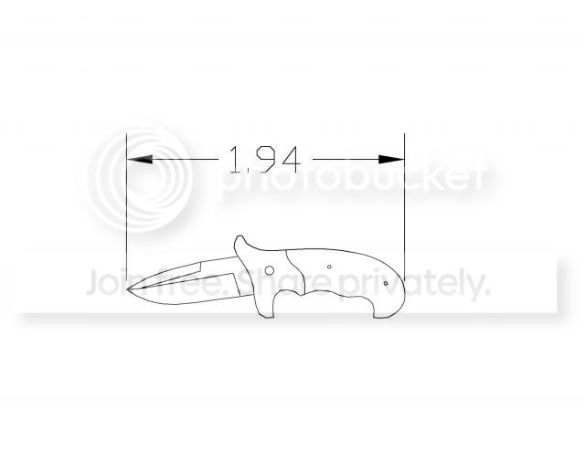

I think ill shoot for a friction folder a little under an inch long closed. Anyone have any suggestions as to a particular model? Id like to make this an "exact" scaled down copy of something (copy of the profile anyway).
Thanx for not calling me a weatherman, lol!
I think you should find a knife that you really like, and make it. That size sounds just fine!
-X
Just a quick sketch...doubt i can pull off the bolster/handle compound curve..Ill most likely make it 1 pc.
The first knife show I ever went to my favorite table was Khalsa's. I just love his lines so ill try and pay homage to this design of his in the spirit of the KITH.

In my case , I do not know the actual dimensions of the knife I am scaling down. My method was to copy the image of a finished knife I estimate to be about 4 " closed. I loaded the image into a 1 inch scale in auto cad then just traced around the image. voila, quick little sketch that is pretty accurate. Perspective of the camera creates problems of course but the differences are negligible imo. This would work with illustrator or other "free" programs I would guess.
