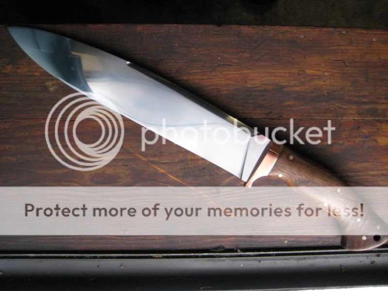

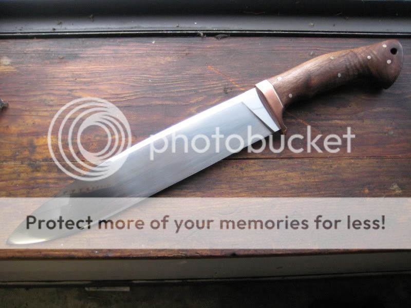

I majorly screwed up. The idea was to peen the pins and have them ever so slightly domed over the wood. But I sawed a couple of them too close to the handle, and the other ones were at such an extreme angle due to the contouring of the handle that I couldn't get a purchase on them. But, I doggedly hacked away trying to peen them over, which I did, but very messily. Gouging out chunks of the handle and otherwise making a disaster of things, I decided to cut my losses and scrap the original idea. So, the pins are now flush with the handle. They are peened at their ends for the most part, so I think they'll do their job of keeping the handle together.
