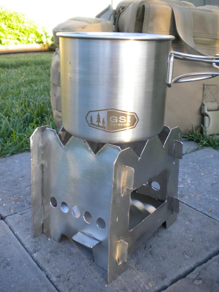

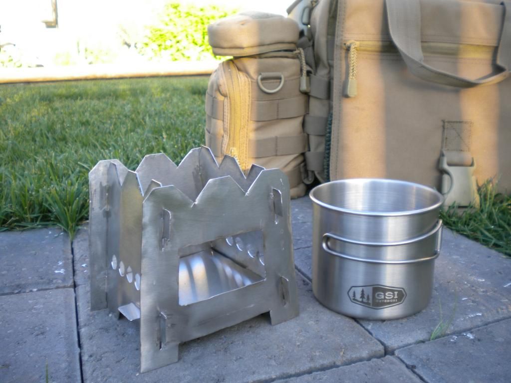

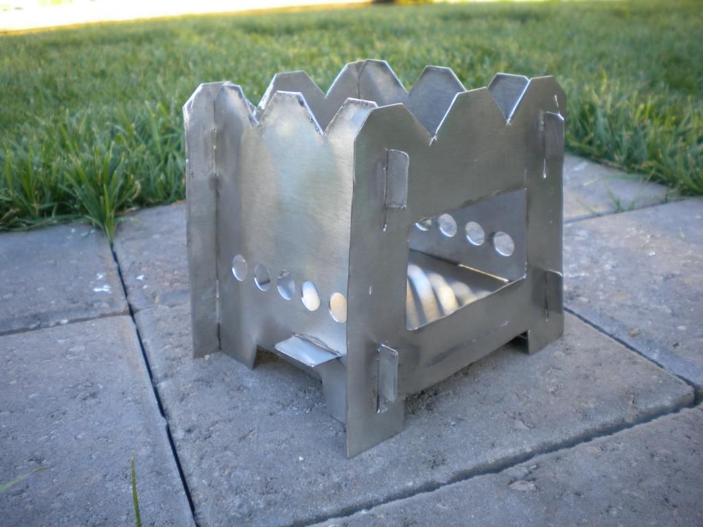

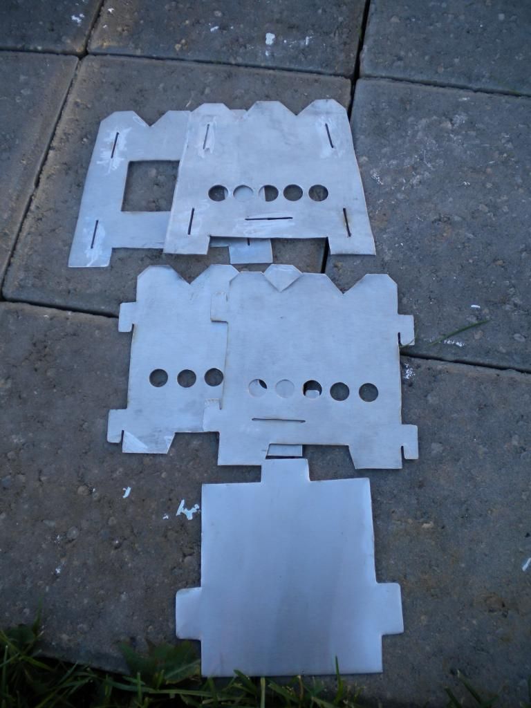

Well, due to all of you Emberlit fanboys around here (that means you Dubz) I've been seriously jonesing for a small wood stove. However, since I'm a cheapa-, er, I mean, since I like tinkering around and building my own stuff, I decided to give it a shot. Spend last night perusing the internet for ideas and plans. A supplier gave me a scrap piece of 22ga. stainless for free. Spent this evening cutting it out with a pair of tin snips and dozen Dremel cut-off wheels:

It looks pretty rough; but it's more of a "see if I like it" kind of build. I still have to sand all the sharp edges off of it, and maybe make a screen or something to lie on top so my glacier cup can sit properly. I'll probably end up buying an emberlit anyways if I like using one enough. I think I'll head to the river tomorrow morning for some fishing and give it burn test.
