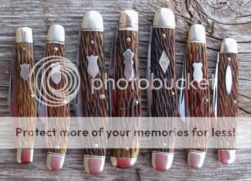

I've used Formby's Lemon Oil for a few years, after seeing a recommendation here in the forum. This group has been oiled a few times, and I think it keeps the bone looking nice. Sometimes old jigged bone has developed dry spots down in the jigging grooves, and it seems to keep it from showing quite as much. I like the shine it puts on the scales too.
