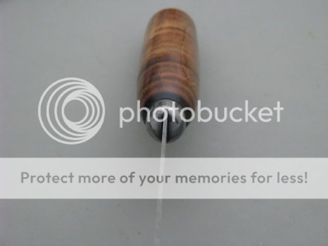

Here's a shot of some fun little old fashioned ferrules/end caps I've been working on for some small knives, all forged over the end of a 1/2 inch round mild steel bar from copper and brass tubing.
Neato Tai. How much time does it take to do that? Can you describe your technique?
I did a little bit of metal spinning back in my collage days. I recall I had to anneal the copper and it was assbackwards from the way you do steel. Does your process require in process annealing? I had to do it quite a bit actually, but I didn't really know what I was doing.
Now you got my gears spinning....
Yes, I had to anneal the copper ones several times. To anneal the copper I take it up to a red heat and quench in water. The brass tubing was so thin, that I only annealed it once at a black heat, but really couldn't move the brass that much. It was just too thin to do much with.
Basically, I leave a bit of material sticking up over the end of the bar/mandrel and forge it over in several steps, a little at a time. I clamped the mandrel in a vice, so that the tubing would only slide down as far as I wanted. The end of the round mild steel mandrel, can either be flat or dome shaped. Of course you want to start with a good fit between the mandrel and the inside diameter of the tubing. When you hit the tops the sides tend to pucker out a bit, so the sides have to be kept in check with some light planishing (while on the mandrel). You can do that part over a flat anvil, but I used a swage block with a half round depression for better support. The only other trick that helped close the ends up, was to upset the ends of the tubing first, to give the ends a bit more beef and support. You can close the ends up as much as you like, just go a little at a time. I filed these down, but for some knives the forged surface might look even better.
If you start to get cracking around the inside of the holes on top, you need to file them back a bit past any of the cracking before you proceed or go any further.
It doesn't take long to do one, probably about an hour. I dind't actually time myself though.
Please make a tutorial for this. At first I thought you were forging the sides down but I guess you are forging the top over. I take it you are welding the edges?
No welding or soldering on them. Yes, the tops are forged over the top of the mandrel. I didn't take any pix of the process, so I'll just have to try and explain it the best I can.
Maybe next time I do some ferrules, I'll remember to take a few pix.

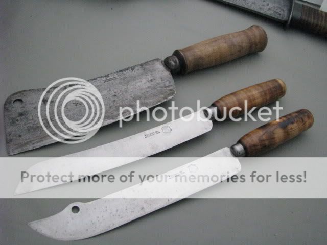

Here's some nice examples from steel. These were made by Ray Richard's grandpa.
