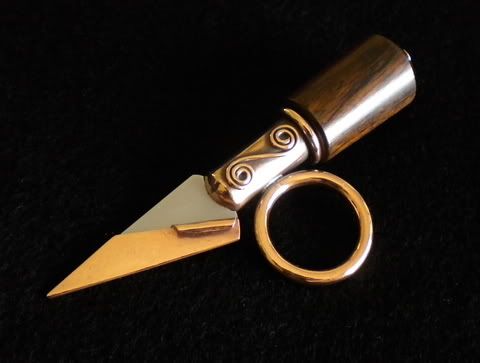

Here's a tutorial on the sinking method, but it's used more for “shallow” domes. It's hard to get the "depth" for these kinds of ferrules that way and the tooling is more trouble.
http://www.followingtheironbrush.org/viewtopic.php?f=9&t=946

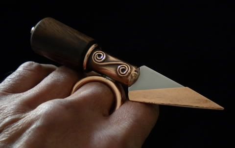

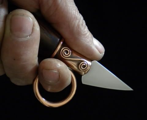

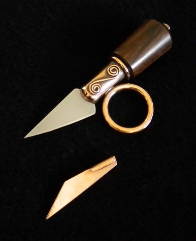

On the last one I just got a super tight fit on the mandrel, didn't need a vice or stop or anything. I just held the mandrel in my hand, and used a jewelers anvil. There's really no limit to depth this way. You could do oval with the same method. It's easier to bring the top over than the sides down, when you want depth.
I was in the hardware store the other day looking at copper end caps for ferrules, lol!
After seeing this I guess they would work, kinda ghetto though!
Nice work Tai!
Here's what I came up with.
Not bad for an old hippie!
