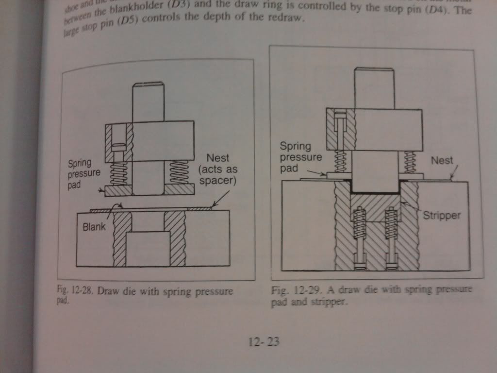

Can these also be done "backwards"? What I mean by that is start with a flat sheet and raise them into a ferrule? Are there any gotchas to watch out for doing them that way?

deker, I don't see why you couldn't make a male and female die and do them out of flat sheet metal. A piece of pipe and a smaller diameter solid bar would give you an idea if it would work or not.

I hadn't thought of doing it that way. I was thinking more along the lines of attaching a disk of material to the end of a mandrel using a screw and a small hole in the center of the disk and then forging the "washer" back around the mandrel. I couldn't figure out how to keep the edges from puckering. I guess if I used two dies and sort of stretched the sheet into the cup shaped die that might work (like how they make soda cans) that might work...hrmmm....

Theoretically, sinking them from a flat disc into a deep female die could work. The only things you'd have to watch out for are getting them stuck in the die or tearing through the disc... not sure if it would really be any easier.

As far as getting stuck in a female mold just use case lube for reloading ammunition. Many wildcat loads are either necked up or down in dies using the same principle.

As for sinking them in a die, you will need pressure pads. If you do not have the pressure pads wrinkles form, and you can only flatten the wrinkles, but never get them out.
You can see in the diagram on the right the material moving into a draw die.
