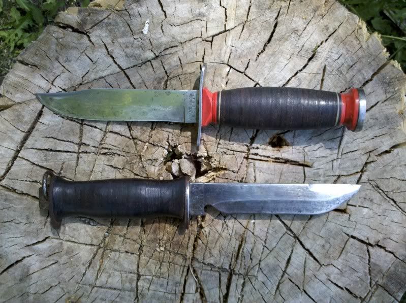

Couple of group photos of Surveyors
Super knives Jake. I have not heard the name Surveyor. Could you define the name a little more? What knives does it include and where does it originate?
