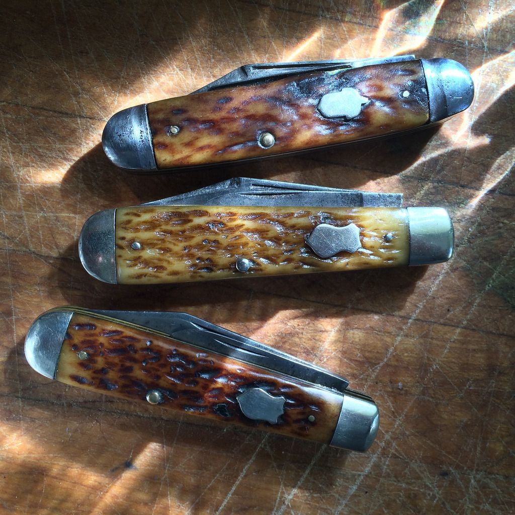

Some Catts with the "Worm Grooved" jigging. The "Hensel" (see top of page) has it too. ;):)
As i understand Mr. Noyes post, Rogers made the jigged bone for both Cattaraugus & Robeson. The jigging for Catt. was called "Indian Trail" and the jigging for Robeson was called "Worm Grooved" and these are not identical; quote C.N. "There are distinct differences."
kj
kj
Joe,
I understood Charlie to say the distinct differences were between the Robeson jigging and Cattaraugus jigging. To be honest, I thought that "Indian Trail" jigging and "Worm grooved" jigging were different jigging patterns, however, this article made me think maybe not. The Rogers produced handles relates to mostly hunting knives and kitchen cutlery, if one reads the Levine article the way I did.
So - is worm grooved another name for Indian Trail or merely a description of the Indian Trail? :confused::confused::confused::)
I still suspect that Catt made their own versions of the jigged bone, since they put it on a large number of their pocket knives and because they were a rather large manufacturer during their day. More than a few of the pocket knife manufacturers used other suppliers for their hunting knives, so possibly Rogers produced the grooved bone on them to be consistent with the pocket knife jigging? :confused:
More muddy waters to confuse, I believe. :o I would be interested in hearing more from the members here. ;)

The several Cattaraugus knives shown above have grooved bone handles that are, I think, significantly dissimilar to that found on Robeson knives.
I posted two examples above. Here are some more:
I don't think the grooved bone on any of these Robesons is like that used by Cattaraugus.
Robeson may have made their own bone handles. I do not know. I do know that molded "jigged" synthetic handles were supplied to them by Rogers Manufacturing Co, suggesting the possibility of a previously established sales relationship re' jigged bone handles, as well.

I guess we are back to square one on the jigging of the Robesons and Catts. :o
Maybe we can just assume the jigging was done by the manufacturers until we find out different. Primble logic. ;):D
