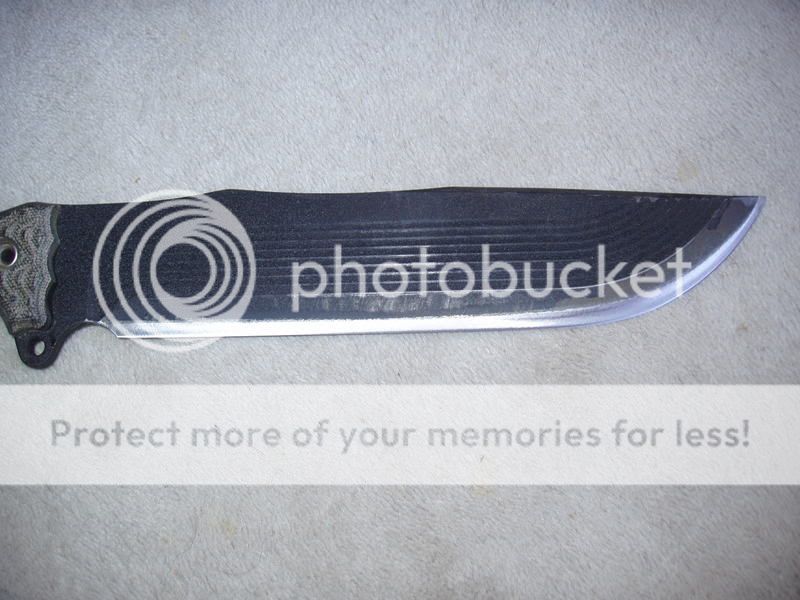

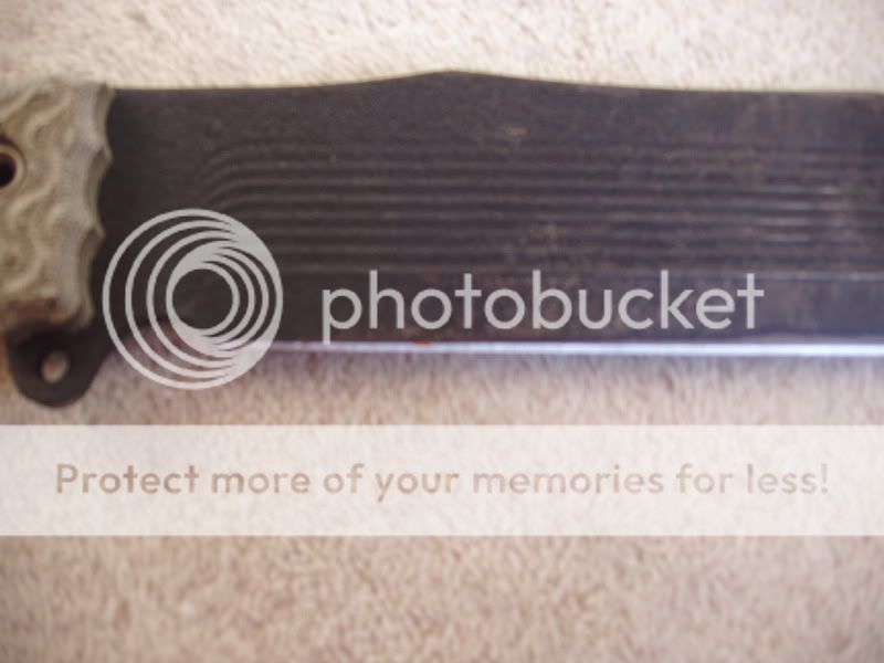

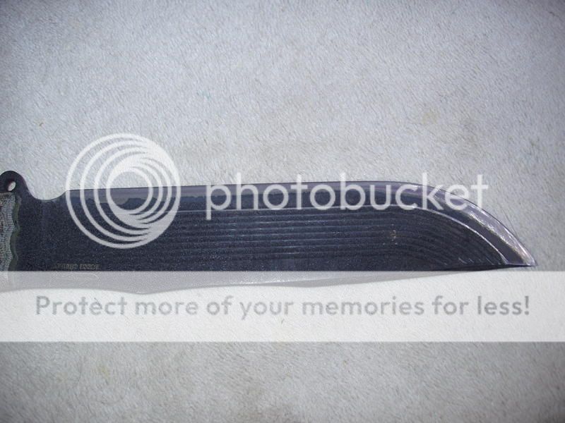

Sorry about not keeping up with everyone..but this is what I've got so far.....
My FBM was VERY DULL....several days of hard work (chopping brush and roots) all with the factory edge (pic just before I started shapening).
Then I went to work.....I started with DMT X-course...about 3 hours the first day...still only had a bur on part of the blade...30 min the next day (started a second bevel YEEK...), another hour and I had corrected back to one bevel and had the bur full lenght of blade. I then moved on to 320 grit sandpaper for about 20 minutes, now I just started with 600 grit (see pics below).
I plan to finish up this weekend, but even just as I started with the 600 grit I could shave hair....WOW, never thought I could sharpen a big blade anything close to this...THANKS MAN, YOU'RE THE BEST.

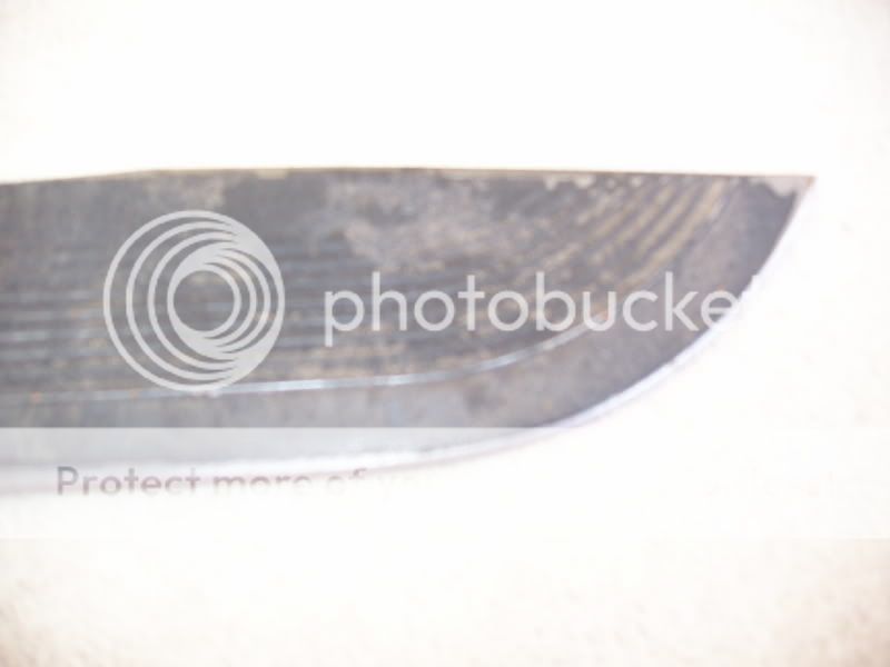

I also noticed that one side removed more metal near the tip, is this normal? The view from the top of the point is almost perfect (before one side was ground differently)...is it possible I just evened out the grind? Or is it more likely I just need more pratice when switching sides?
Note: your comments about "Feeling" the where the stone contacted the blade made all the difference...I've used a DMT for years...meixed results...but when I paid attn to the feel I could hold it the same every pass and get the results I've always wanted.
PS: The start of the second day (started a second bevel) I wasn't in tune with the FEEL... and caused more work for myself...I went back and marked it with ink to ensure I had the FEEL right before trying to correct my mistake, worked great.
I'll try to post more pic's so any comments are welcome (from anyone), thanks again.
You are going to freak out when you go back and do some chopping with the big blade. My CGFBM gained more than any other knife so far from a sweet convex job. If I remember correctly BAN did some chopping with my "cheap" CGFBM and was impressed. Way more bang for the buck than fatties.
Great work and thanks for the feed back about the "use the force and FEEL the stone thing. I was not sure if I was explaining that clearly enough.
