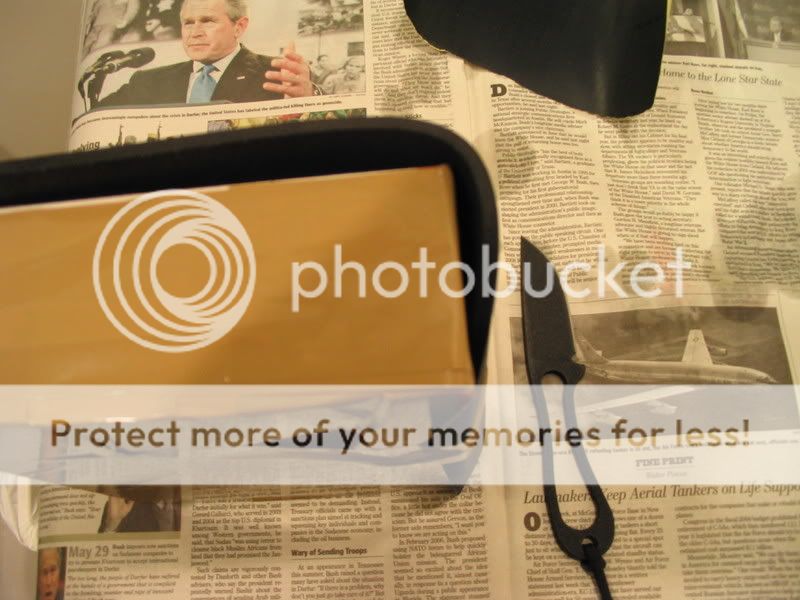

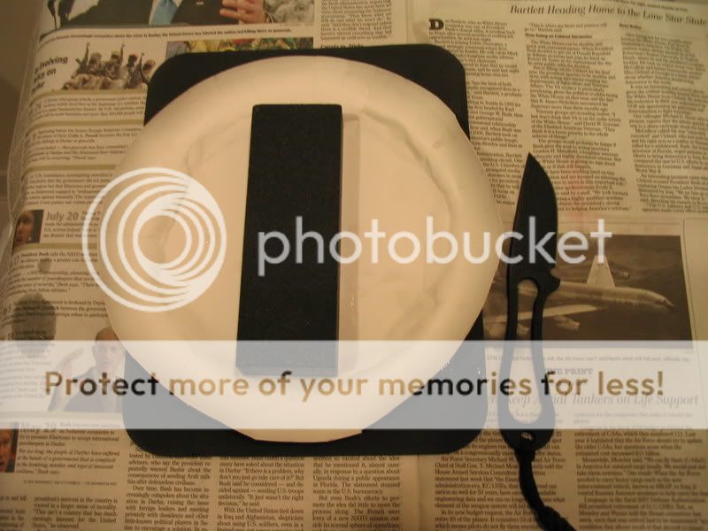

Just finished up my Rat Warden :)
I did exactly as you instructed JAB, except I began with a 200/600 waterstone instead of the XXcoarse dia-stone. The waterstone worked GREAT for such a small knife and bevel. I could definetly see this waterstone getting old on a larger blade like my BATACLE. The 200 grit cut quick and the slurry made a decent low grade polish on the edge. The 600 grit made quick work of the scratches and smoothed out the edge. Here are a few pics I took of the set-up and some of the progress. The edge bevel doubled in size from the reprofile. It started as 1/32" with little smoothing of the coating behind the bevel. At finish with the waterstone it was a hair over 1/16".
The set-up

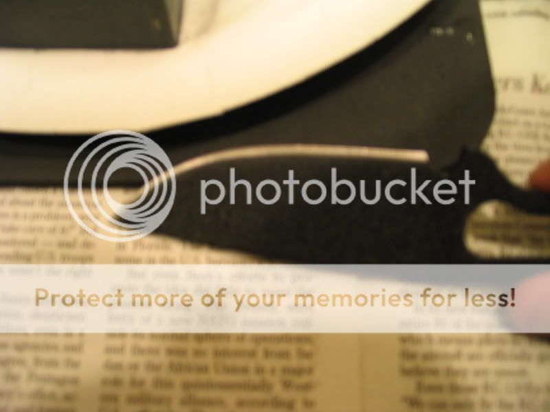

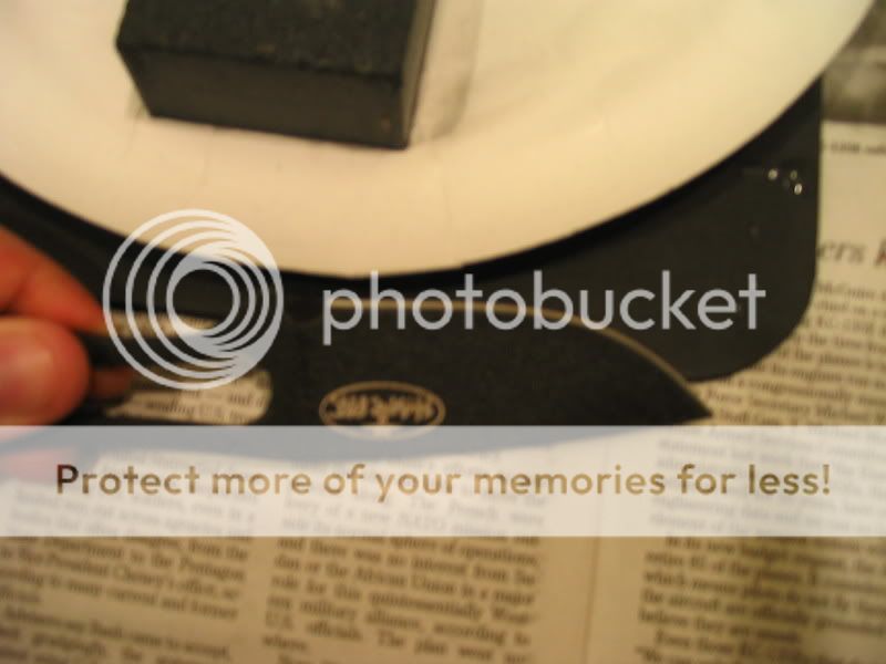

Primary bevel intact

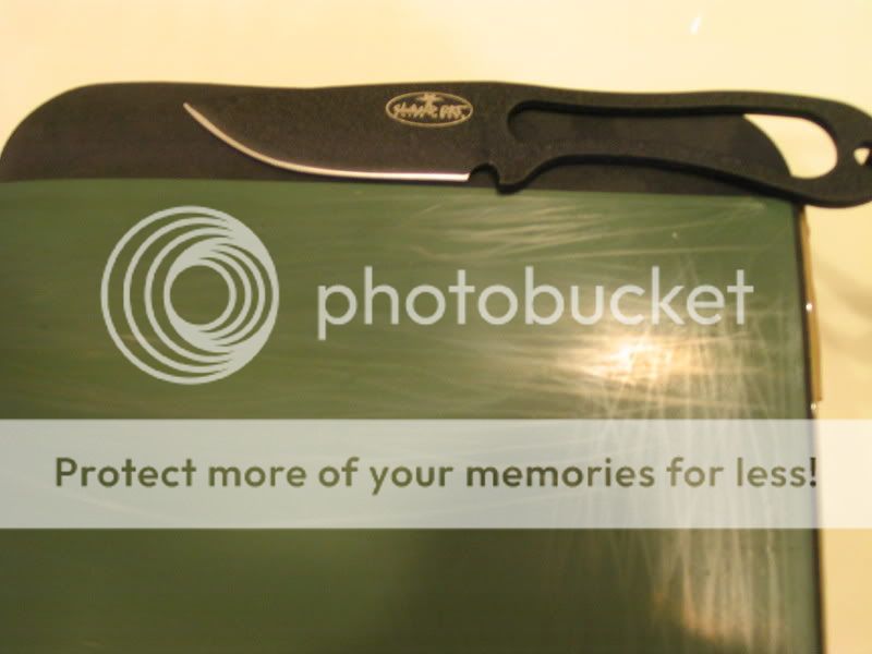

New primary bevel

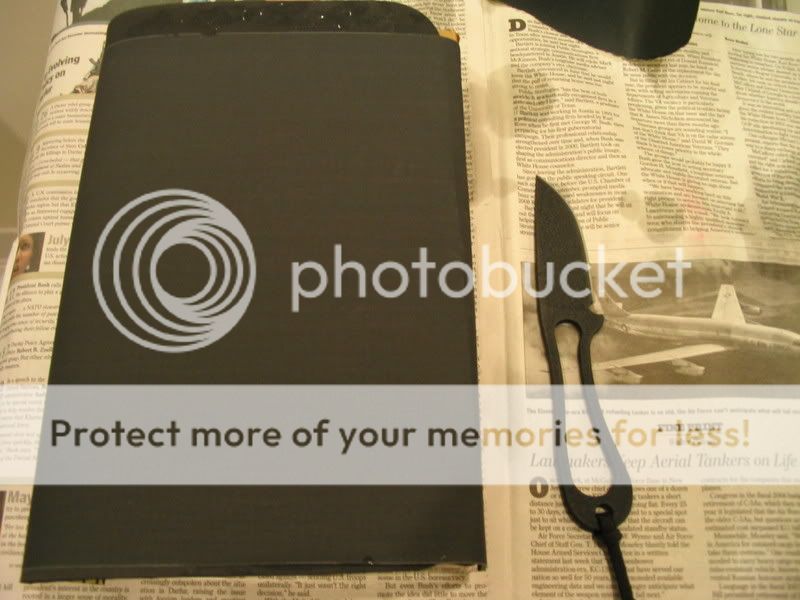

Sandpaper set-up
Showing the "stage", took the USPS box that Bully shipped the warden in and covered it in brown plastic tape. Then taped down the paper w/ mousepad underneath CHEAP AND REALLY EFFECTIVE, and really easy to change grits
The secret weapon, .5 micron sandpaper!!!!!
For sandpaper grits I spent at least 5 min on each side with 600 wet/dry to take out all the scratches, and progressed to 1000 from there. Took about 10 mins to polish up the edge and from 1500 to the .5micron was a snap. The bit about developing touch/feel REALLY helped with the high grits. There is a vast amount of difference in sharpness when you work with the back of the bevel. I think all the times before I was working from the middle forward and rounding the edge. Not anymore ;)
