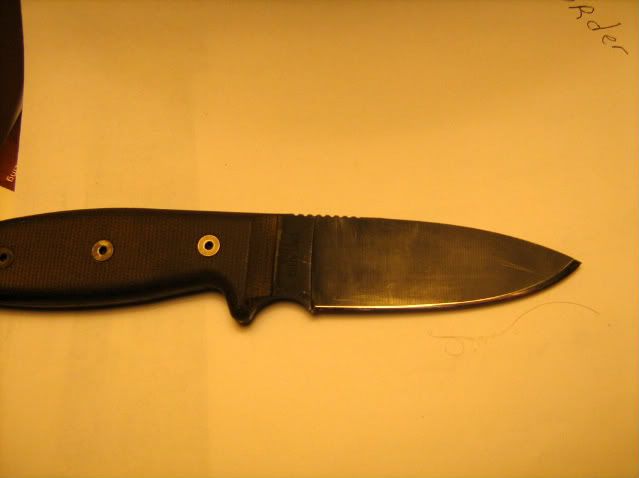

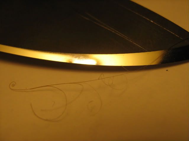

RAT-3 1095 steel, I had to regrind it after breaking the tip so that's the reason for the different shape. While posting here I was also reprofiling, I set the angle to around 12 to 15 deg. finished with spyderco uf ceramic and gave it a light polish with 1 micron diamond paste. It took 42 minutes to do by hand.
its also very sharp:D
It would have taken less time but I changed the angle from 20+ to now less than 15. This is what I call "easy to sharpen"
