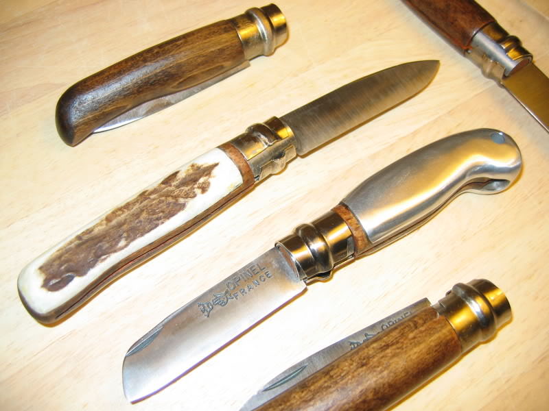

I like the easy open notch. How does it feel when you hold the knife in it's open position?Here’s a #6 I modified a little bit. I rounded off the bottom of the handle and added the easy-open notch.![]()
A bit of a warning, if you take much off of the point of the handle on the bottom, the tip will be proud and you’ll have to remove part of that as well.
It feels fine to me, but I don’t typically use my knives for any prolonged time. I just generally cut or slice something and put it away as opposed to whittling, skinning a large animal, etc.I like the easy open notch. How does it feel when you hold the knife in it's open position?

And on that note, here's a pic of 3 of mine (No. 08 size):

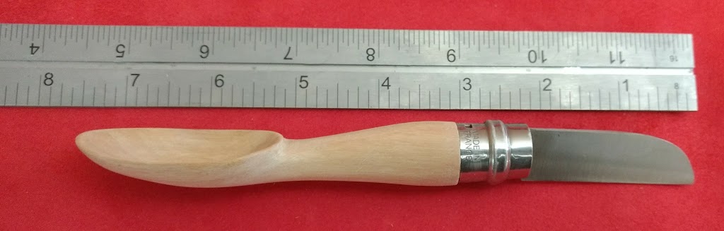

Outstanding work sir.This one started life as an Ebauche model. I had to fill part of the blade slot so the spoon wouldn't leak. So I made the blade into a sheep foot.
I used a cheap harbor freight belt sander to do the grinding, with a container of water to dip it in, to keep the blade cool.
I think that if you go for a lambsfoot shape, you would be taking material off the back of the blade as well as the end. That might require removing material from the slot side of the handle, so that you could still get the blade open.
