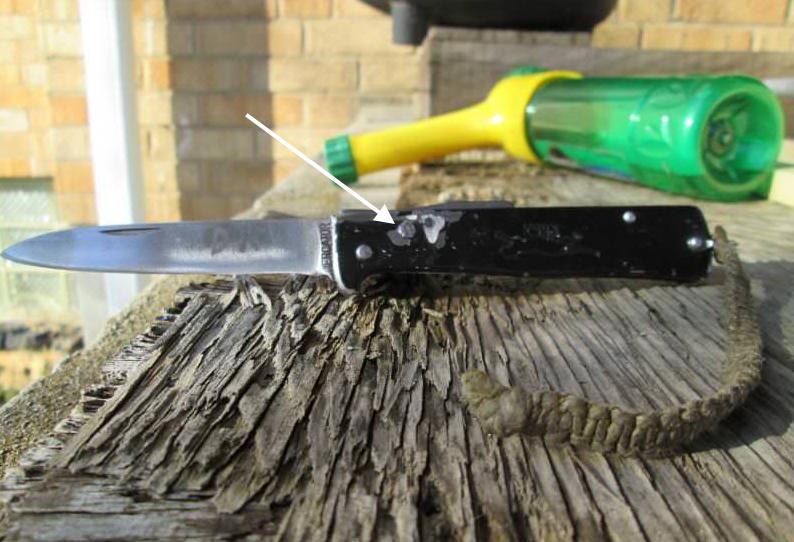

That's freaking awesome. One of my pet peeves in a folder is when the tip hitting is what stops the blade closing instead of a proper kick. I love me a Mercator, but that knife is an example.
Here is a pic of a very beat up Mercator where I have installed a pin to act as a stop in similar fashion to what you did.
I had better pics of better knives I did this with, but Photobucket is holding my pics for ransom now. I can't get them even wading in and putting up with a plethora of nagging ads.
