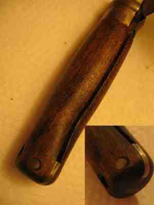

Finally pulled the trigger, went to lee valley to get a Mora and found out that everything was either discontinued or out of stock, settled on a No 10 Carbone Opinel. I haven't decided if this is the first of many or the first and last. Everything I have read about these was true enough, thin blade, precisely ground, easily sharpened, sharper than hell but ive never been so cut up in my whole life. The combination of it being beyond razor sharp and the hinge being like a bear trap has led me to cut most of my finger tips, half my knuckles and the meaty parts of both my trigger fingers, ive had to start leaving it at home because my hands hurt so much I cant open any of my knives that aren't waved. Carbon folders are not super common so I wasn't wasting an opportunity to do a forced patina, a combination of apples, mustard and vinegar. I also stripped the finish off the handle and tried dyeing it dark brown, which failed, so I settled for a linseed oil finish, which went so so. Searching for modified Opinels brought me across pics of models with cut down handles and tanto blades which has me thinking, we will see if I survive this one first. What do you think? $22 (I know, I paid to much) and about 2 liters of blood, this is what I get.

That looks darn good! You've sanded it, oiled & finished it, patina'd it and, mostly importantly, you've shed your own blood on it. That definitively makes it your own. :thumbup:
I've noticed the pivot on my 'carbone' No. 8 is also quite stiff, more so after I used it for slicing some fruit. I bought it along with a stainless, Walnut-handled No. 8. Strangely, the Walnut version's pivot has never varied in smoothness or ease of opening/closing, although I've used it quite a bit more at mealtime (slicing apples, especially). The beech handle on the carbone model seems to react a lot more to changes in humidity. It's been a bit rainy here, and the pivot gets all-the-more stiff on days like this. All this, in spite of the fact that Opinel varnishes the beech handles on the carbon models (I'd think it'd resist the moisture more; but I'm not seeing evidence of that yet). And the Walnut handle comes completely raw, no finish or sealer on it (go figure).
I've since sanded down my Walnut version, and sealed it with some Watco Danish Oil (mixed formula of linseed oil, varnish and mineral spirits). Worked at least a bit better than I expected. It's got a nice 'almost glossy' satin sheen to it now, after some additional buffing.
I'll probably do the same with the beech handle on the other one & see if that makes a difference in moisture absorption.
BF member Jackknife has recommended using Vaseline in the pivot to stave off the moisture & such (ETA: Opinel even recommends this). I've heard it works pretty well, but haven't tried it with mine yet. I'd hope it might help lube & loosen the pivot a bit, too.

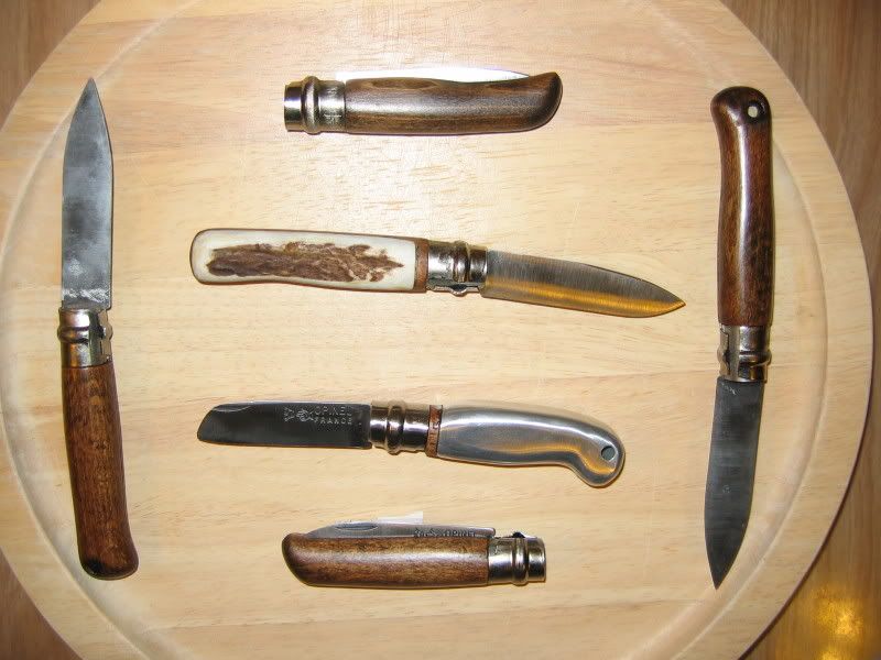

Wow, these are gorgeous. Could you break down how you went about adding the antler scales to the one and the silver to the other? I'd be interested in trying that myself

Well, on the antler scales I just filed a flat on either side of the handle, starting with a bastard file and going to a somewhat finer file as I got close to my goal so as to keep it even and square. Doing a good job on this is the key.
Took some Elk antler I had and ground the face flat. Elk is best to get a somewhat flat-ish piece for scales as it can be huge. My girlfriend got this piece fairly cheaply at a now defunct Elk ranch in Minnesota. It was cheap because it was a big broken up piece, still good for scales.
I epoxied the pieces into the flats I had filed and clamped it up to dry. I did not try to fit the scales anywhere but against the flats I had filed, the main flat and the small flat area at right angles to that up near the lock. Everywhere else was sticking out hugely. Once it had dried I then belt sanded the whole mess (and it did look a mess) into shape.
Hand sanding with finer sandpaper, some stain (with a small paintbrush), and many coats of tung oil and I was done.
On the "silver" piece, well, that's actually aluminum.
With that, it helps that I'm a machinist. I milled a groove in a piece of aluminum and then just ground and filed the Opinel to fit in it. The Opinel didn't have a bunch of wood left and it was pretty fragile when I glued it in. Once the epoxy set, it's all pretty sturdy and I've put it through some fairly tough use.
Once it was all glued in I ground the aluminum to shape and buffed and polished it. In this case, since aluminum conducts heat so well I had to do a little at a time so as to not make it all too hot. I work on this stuff a little each morning before work anyway so it was all good.
Again with the stain and tung oil and paintbrush.
Hope this made sense. Ask me any questions.
