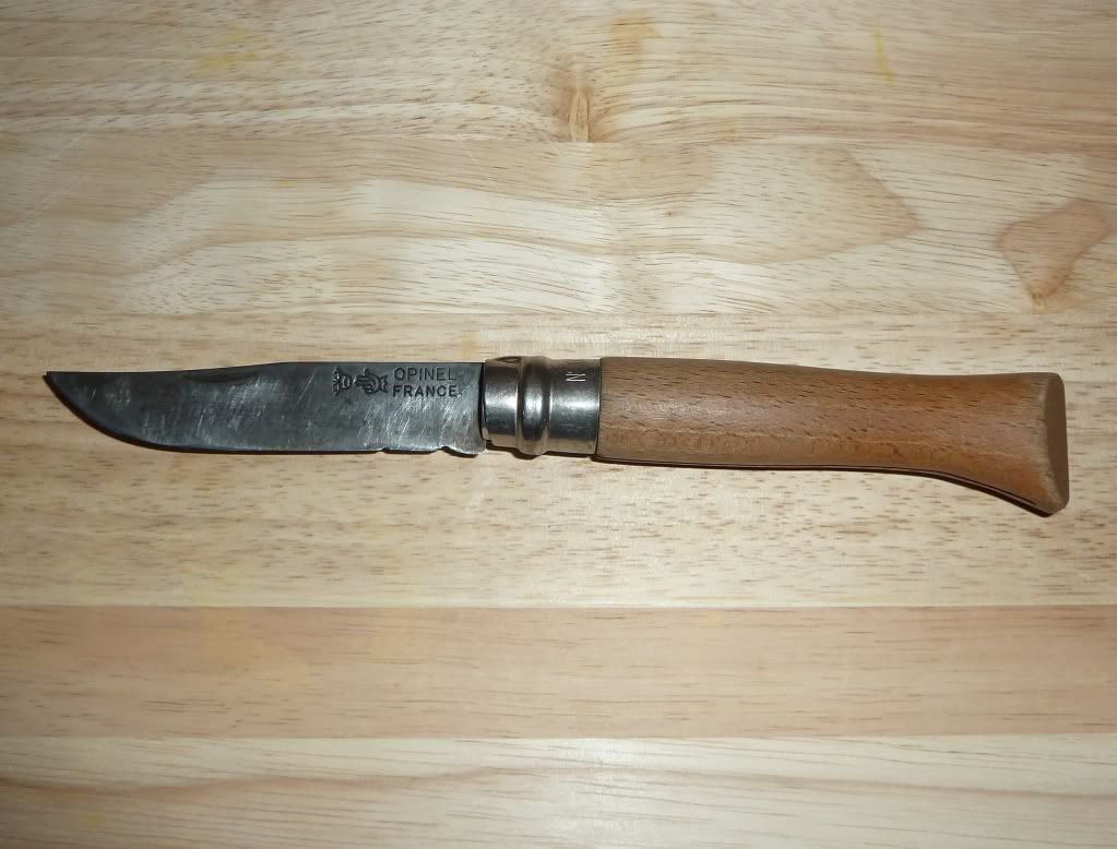

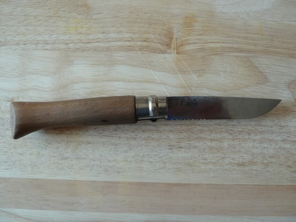

Easy-open notch on my Opinel No.8 Carbon. It's my do-all farm knife. :)

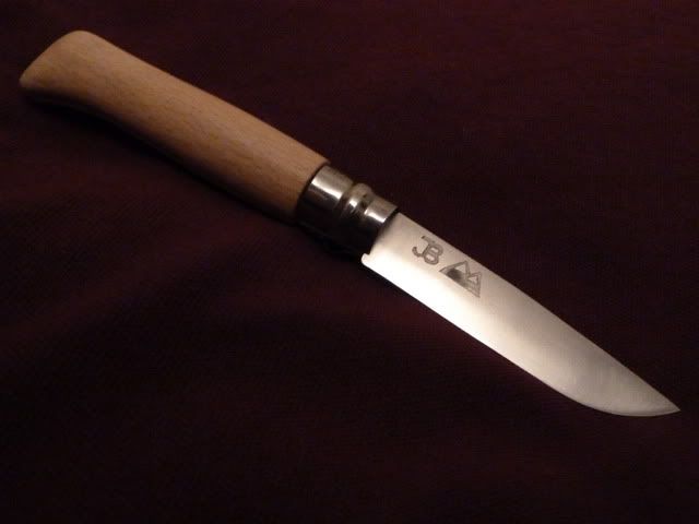

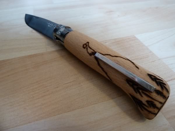

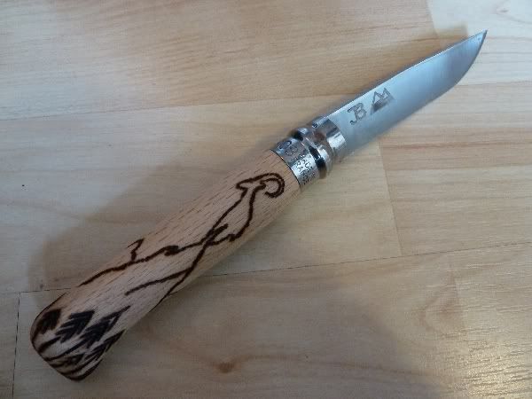

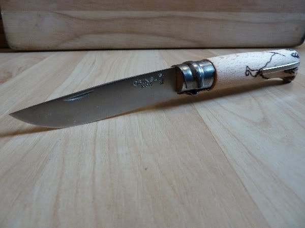

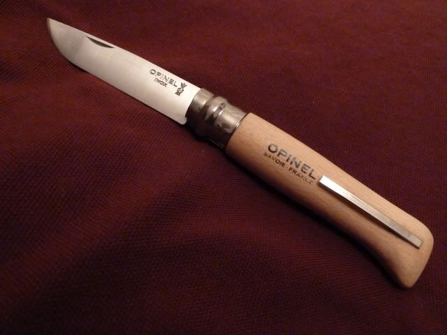

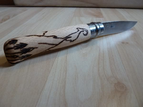

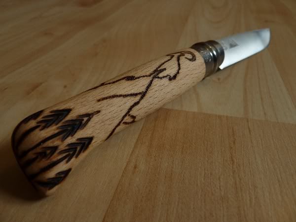

Update:
Modifications made to the original No8:
-Added a pocket clip
-Polished the handle/changed back of handle
-Converted it from a clip point to drop point style blade
-Added an inscription in the blade
-Added decoration to the handle
-Finished handle with oil
Some pictures:

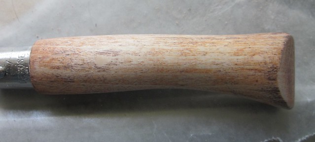

I got so inspired by this thread a while back, that I had to go ahead and do a mod myself (No.8). Thank you for your ideas.
I went with Blue Sky's direction and made mine more squared at the pommel and finished the wood off with some tar + line seed oil + balsamic turpentine (1 part each mix).
I really like how yours looks, "rustic" yet also distinctive.

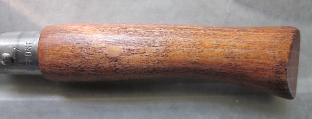

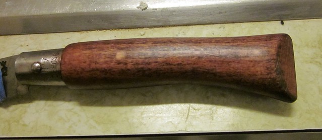

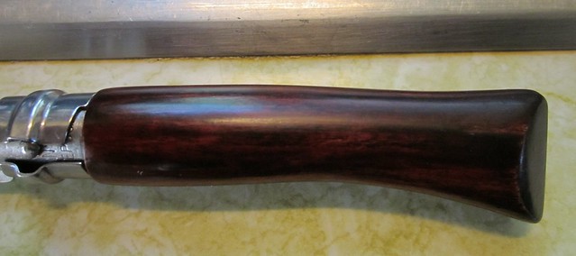

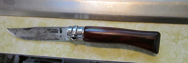

I spiffed up the handle on my carbon No.8 (from a post answering a direct question about the same, over in Traditional):
For my first pretend attempt, I lightly sanded the handle and colored it with a brown sharpie (bottom knife below):
Which of course rubbed off (not a bad thing-- heh):
Next, I sanded the handle again, removed the locking ring, and applied MinWax Wood Finish (yellow can), Red Mahogany. However, the finish used on the handles of the Opinel Carbon knives goes deep-- altogether a good thing, given that most people will leave them as-is. It's nice to know the original finish is good and deep. I thought I'd sanded it sufficiently for the stain to take, and the handle color looked nice and dark, but after allowing the handle to dry and buffing it with 0000 steel wool, I had this:
I then sanded the handle more deeply. I didn't go any deeeper than this because, while I wanted to remove the orangey-finished parts I did not want to alter the shape of the handle. You can see the original finish, plus the places the new stain actually soaked in(!). I intended to apply two more coats of Red Mahogany stain then finish up with Helmsman's Spar Urethane:
After the two coats of stain, buffed with 0000 steel wool, I had this:
At the store to purchase the Spar Urethane, I discovered three things:
1) The Spar Urethane didn't come in the small(est) can, and I didn't want to buy more than 8oz
2) The label on the Red Mahogany Stain sported a recommendation for the above urethane, but warned against using Polycrylic, leaving me with "regular" PolyUrethane
3) I spied the PolyShades on the shelf, stain plus PolyUrethane all in one. Specifically, MinWax PolyShades, Bombay Mahogany Satin-- "Stain and Polyurethane in 1 Step."
Ta da!
The PolyShades went on well enough that I'm confident it would have worked from the get-go, saving me many steps and frustration. The resulting finish is smooth and non-tacky. It feels a little more plastic-y than I would prefer, and I can see how/where I would apply the finish more consistently if I had a do-over, but I intend to simply Use the knife from here on out, and anticipate the finish breaking in well.
The handles on the stainless Opinels seem to have less of a coating, which I suppose I will confirm if and when I decide to PolyShade my No.8 Gardener's knife, seen above. I'm thinking of doing that one in a slightly lighter shade, perhaps American Chestnut or one of the Maples.
~ P.
Thanks, I like it too! :) It's not too big and not too small.
The handle is just large enough for me (size 10) for comfort and a secure grip for carving etc.,
yet small and light in the pocket.
The handle is oiled. I think I will still take some wood off the handle to make it a bit "Laguoile" - style.

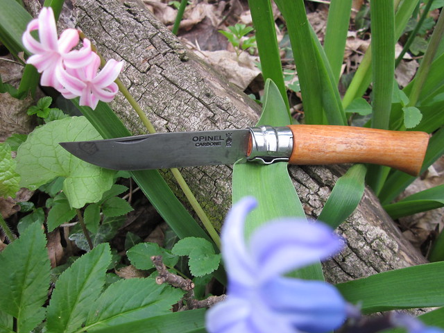

I've checked on woodworking sites and as well as I remember beech is a wood which IS a problem to stain. It's a good hard wood, but doesn't absorb stain well. The answer, as shown in Pertinux's post, is a stain which kind of coats the surface instead of being intended to soak in. (polyshades)
Another answer which I have seen on this board and tried is to lightly scorch the wood before staining. I did that on the #6's below. I lightly scorched, stained, then used wood hardener. I prolly didn't need the wood hardener since I scorched pretty lightly but I can be anal.
Now, the stain didn't look as deep and rich as some other Opi's where I've stained and stained and "rubbed it in", but I did these pretty "quick and dirty" and a different stain may or may not do better.
