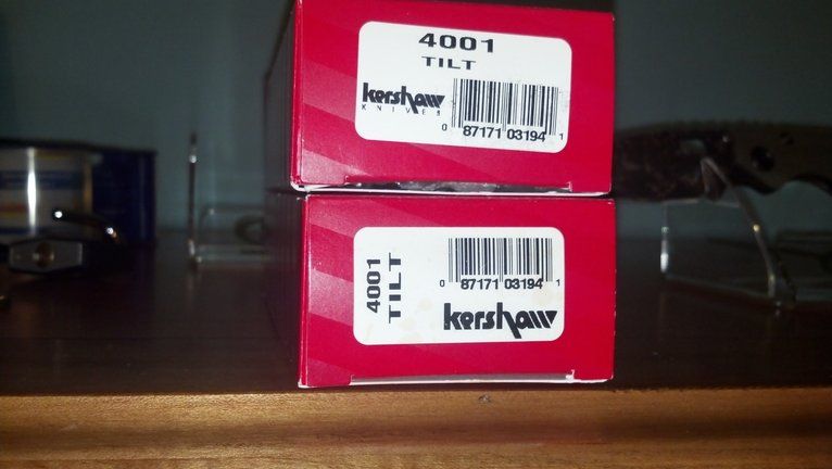

So Got my New DLC today...So I got #069 and #020...Some interesting differences..#020 has a Matte looking CF scale, It came with a Zipper Pouch and the Box is Different...Weird!
The #020 box is on the Bottom
Yummy...TiLTs. How many have you owned now? 15-20?? Also, what's on the ZT stand in the background?
