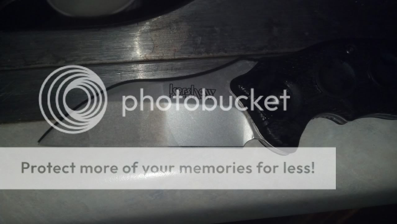

Well I sacrificed a kershaw blade tonight as a test mule for acid wash. I'm prepping to acid wash my 560 blade and tested 3 different concentrations on the needs work blade I'm feeling the middle one gives the best look.

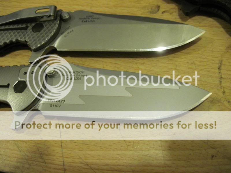

Got my 560cbcf, it's everything I thought it would be and more! pics will come soon.
Are you just going to acid etch it or are you doing a stonewash on top of it? If you are stonewashing it, i’d go with the darker finish. The finish tends to get lighter when you stonewash after acid etching. So i’d etch it a little darker than what you want the finished product to look like.
Thank you for that tip steb yes I do plan yo stone wash it afterward just a little tho I want it to look a little rough.
No problem! I’m sure you know about putting the nail polish on certain parts to keep it from ruining the tolerances/edge right?

ASM I would acid dip, then sand, then dip, then sand you know a couple times to get it nice and deep where its not going to rub off easily.
