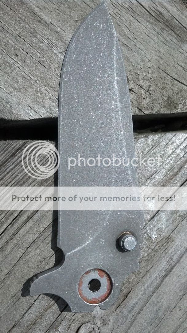

Well at a stopping point for tonight its been etched 4 times wet sanding between color is almost perfect I had to put it "together" to see how it looked. Tomorrow its going to get a very light stone wash and a nice long afternoon of sharpening and that will be end of story here is a pic about 2-3 dips in.

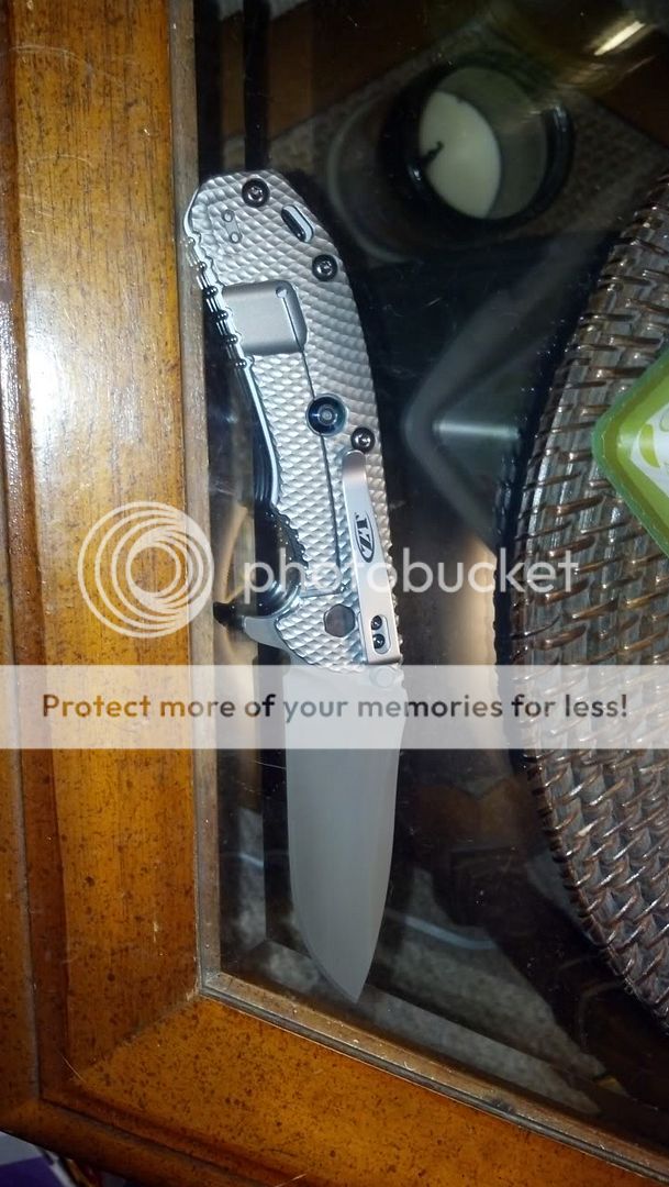

And a somewhat assembled pic just for looks

That's gonna be sick:D

looks great so far! If you would have put the resist on the edge, you could have saved yourself a lot of time sharpening, and saved the edge steel from being eaten by the acid.
I tried to save the edge with the resist bit it was really uneven so I said screw it and took the resist off. The solution is ferric chloride with a 90sec soak then light sanding. And repeat 3-4 times last time no sanding gonna let the stone wash save it. And I was pretty sure that the stone wash was gonna beat up the edge so I'm actually looking forward to re sharpening it.
Update blade is in dryer getting its stone wash currently cant wait for the timer to go off and see what I have created
