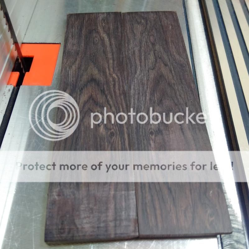

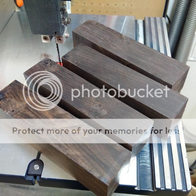

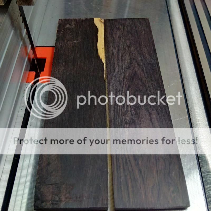

Sorry to keep bugging you with dumb questions. Are these all African Blackwood?
Thanks. The one I cut has more grain than the others I've worked with as does the the lower and upper blocks. They were all in the same bag that was given to me so I assumed they were all the same.
