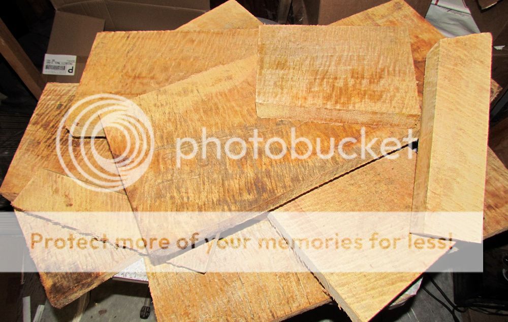

This is some fresh Mango I am cutting up now. Over the past few years I have cut a lot.

The mango I showed in the photo is fresh cut. That means that the moisture content is still over 35%.
