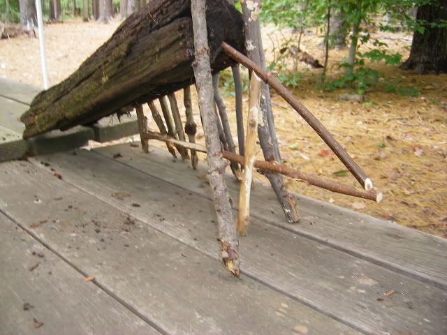

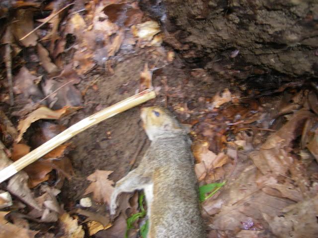

I'm at work right now. I made all five (to cover up to the 5th of Oct) over the weekend and set them yesterday at lunch. I just checked them and I had two of them tripped and one dead squirrel. One for two isn't bad for this kind of trap. I reset the tripped ones and came back inside. I'll check them again tomorrow. I am all caught up with five traps and will post pics tonight when I get home, including the successful trap.

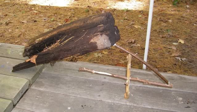

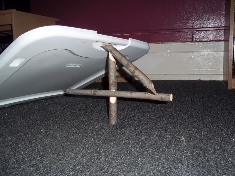

I have noticed a few problems with some of the traps posted.
The vertical stick must not be below the deadfall which can slow or even stop the weight from falling.
The trigger stick isn't long enough on a few of these. With a short trigger stick the animal will not be far enough under the weight and will probably be able to react quickly enough to escape.
The weight itself must be fairly wide and at an acute angle to the ground. A very thin weight is easier for the small animal to dodge, just as a weight that is to high off the ground. A wide heavy weight that is fairly close to the trigger works best.
I don't want to come off like I'm telling anyone how to adjust their traps but the things I have mentioned are hard to learn without actually setting the trap and killing something. If we practice making the traps, refining the triggers, ect... then we should also know the practical trapping knowledge that will likely make these traps more successful. Again, I'm sorry of this is coming off the wrong way. I just want the skills of trap making to be more rounded so that we can see more successful traps here on WSS.

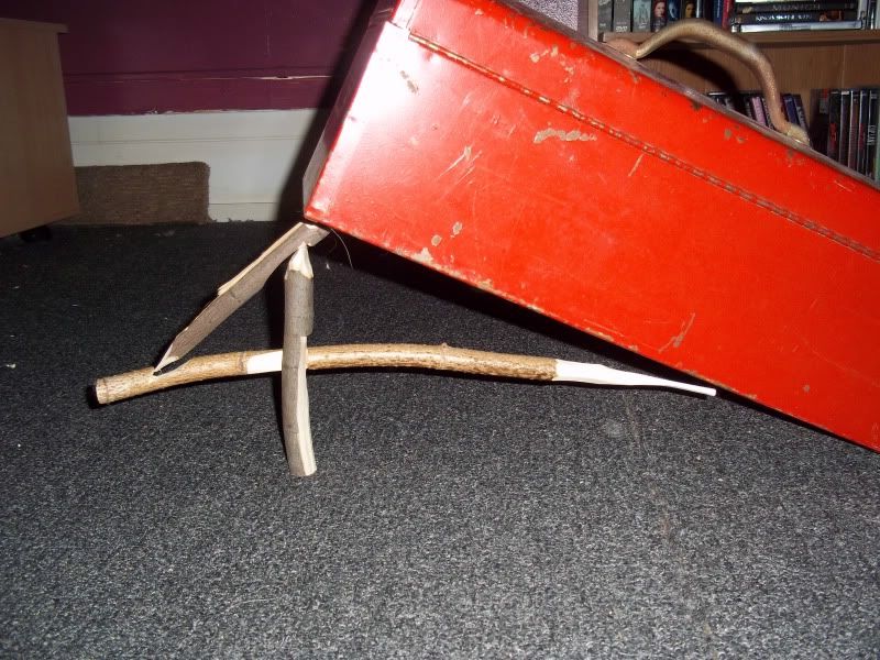

This is my second trap. The upright isn't tall enough. Sometimes the trigger would touch the ground before the trap was triggered. Easy fix = set the upright on another piece of wood.

1. The diagonal piece (I call it the lever) is key to relating the weight of the dead-fall to the weight of the trigger. The longer the lever is past the upright stick, the more force it takes to activate the trap.
2. When setting dead-falls it can be useful to put a couple of blocks under the weight, not touching it, but placed so that if the figure four collapses it will only fall an inch or two. This will keep your trap from being beat up, an possibly keeps your hand from being smashed by a rock. Once the trap is set, move the blocks.

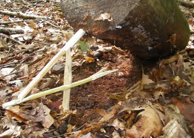

first trap
after sticks stuck in ground to prevent escape from one side and log placed against other side

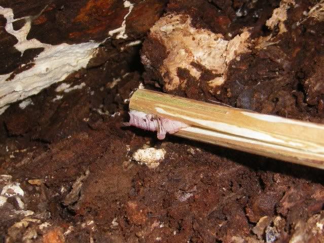

bait for first trap-red mushroom that the chipmunks love

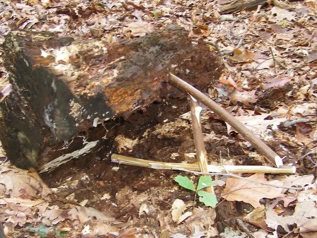

Trap 2
bait for trap - the nut is wedged in there very tight
Trap - this one is wide enough that I didn't need to place the barrier sticks on the sides

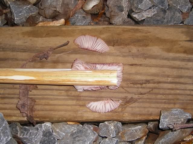

Red mushroom that I used for bait- the ends are trimmed to make sure the squirrel doesn't just eat the sides and leave

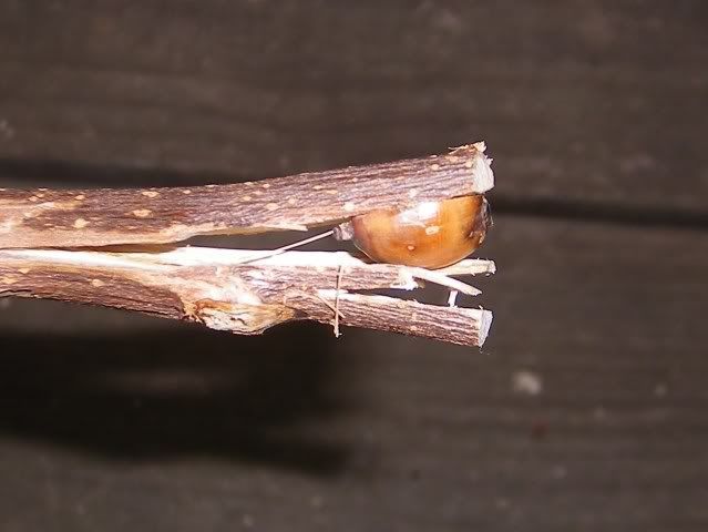

bait for trap- in the second pic you can see where I trimmed one side flat to help it create more friction

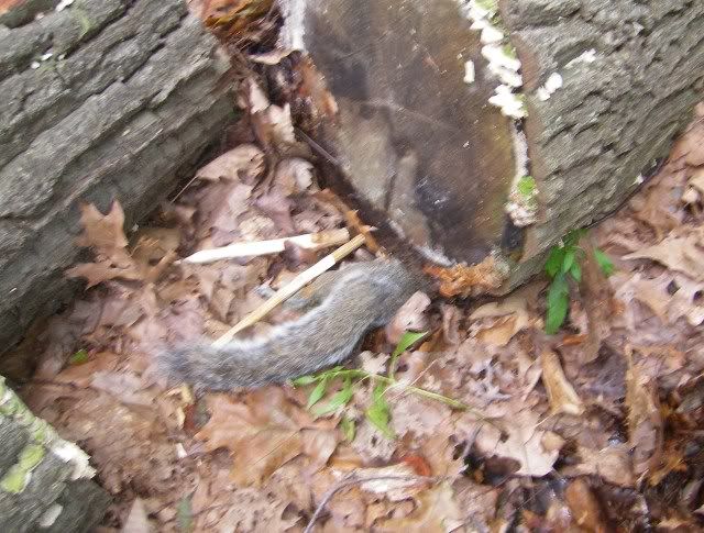

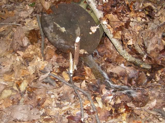

Sorry, forgot to put my kill pics in the last post. They were taken with my phone so they are a little blurry because I forgot to wipe the little lens off, Oh well.
Kill #1- trap baited with small acorn. Set at 4pm, checked at noon the next day after archery practice
Kill #2- baited with red mushroom wedged in split in baitstick. Set around 4pm, checked at 9am
