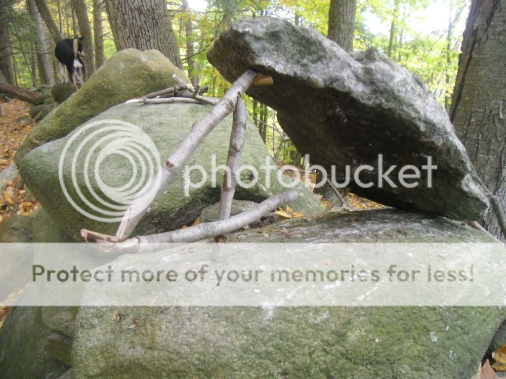

But at the same time with that notch like that you are limiting if the animal happens to raise its head, then spook because or the resistance and jet just as the trap falls.
I like Ron Hoods way of shaving off the edge under the trigger, in this you tube video he discusses and shows how to do what I'm talking about right about 3:30.
http://www.youtube.com/watch?v=seAevIIfUxY
Very nice. Yet another idea and possible improvement. I love it.

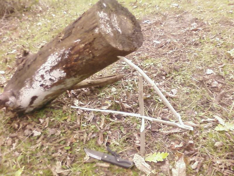

I feel like I'm cheating a bit because I've had to build some traps out of commercial wood, but it's better than nothing.
#16 (Yes, I did use that crappy knife for this one)
#17
#18

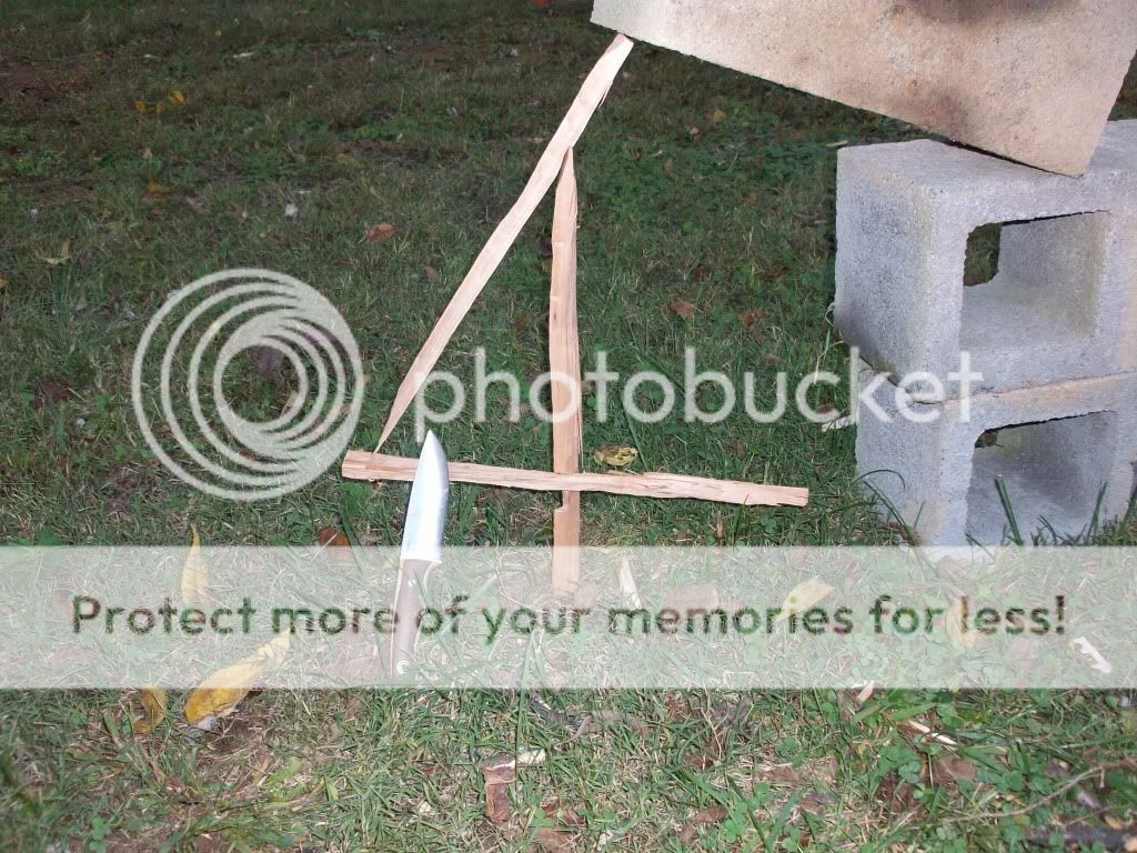

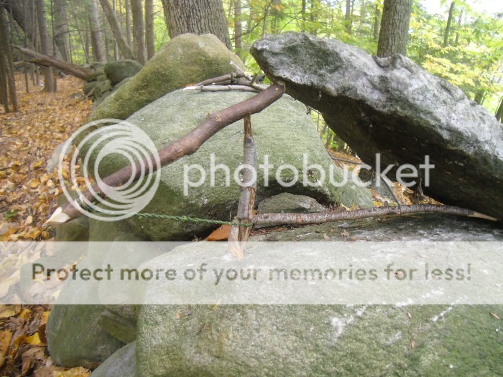

One quick figure 4 tonight for me to. But also a bird snare to! Pics to follow.
Nice one scab..Ojibwa bird snare
Coyote, Thats the way to set ''em brother.. took me about 6 months worth of smashed fingers to figure it out...
I shot a video yesterday making a fig.4 step by step..got all the carving on film but theangle was no god on the trap set... I'm going to try again over the weekend. I made a few today I'll get up in a bit. too.
here's a quick 2 min fig. 4
and a paiute (i know it doesn't count) utilizing some quick make shift natural cordage
I admire the physics behind the paiute, and I fel it can be made more sensitive
but for quick and dirty results, and sheer versatiltiy on account of cordage not being necessary, I have to give it to the fig. 4
nie cordage on the ojibwa.....what'd you use?

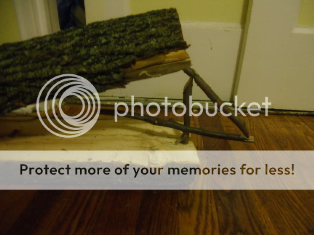

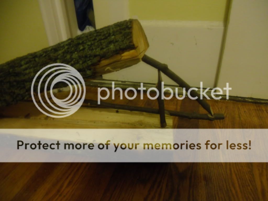

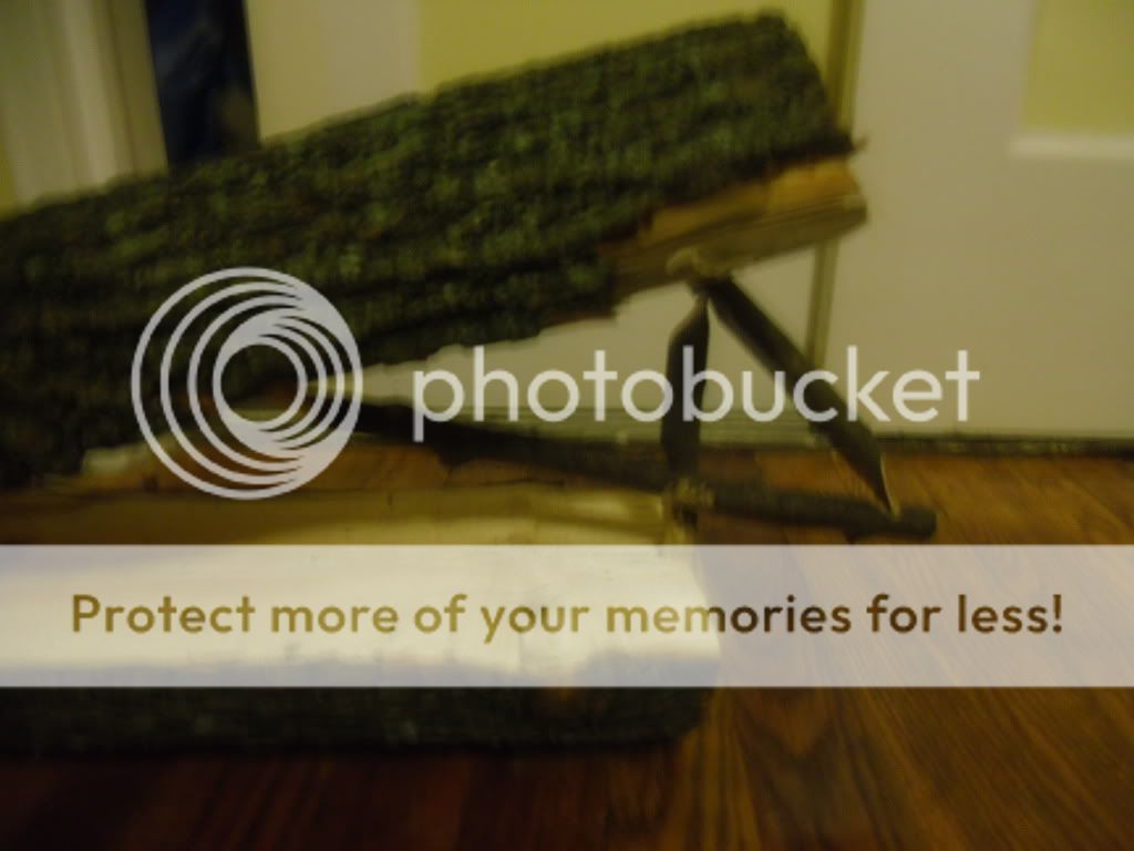

I'm falling a bit behind, but I cranked out a few today. Only two qualify as figure 4's. I'm not sure what the third one is though. Maybe you can help me decide.
#19
#20
Here is the oddball. After seeing Skab's Ojibwa bird snare I started thinking (always a dangerous thing) and made some sort of Paiute-Ojibwa-Figure-Four Hybrid. Maybe I could call it a POFF Hybrid if Marion wouldn't mind:D.
I thought that It might be difficult to set, but it really was pretty easy. The trigger is about equally sensitive in any direction, and I found that the melted tip on a strand of paracord was enough to lock everything in place.

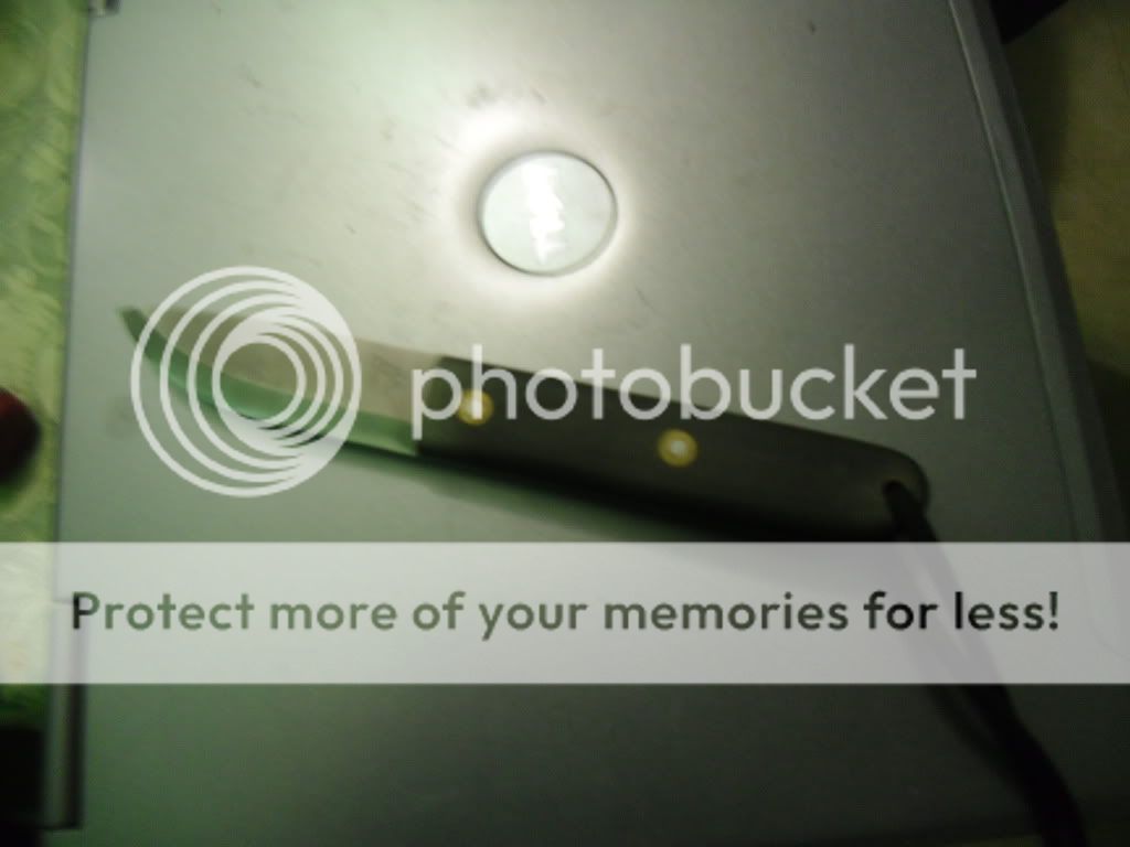

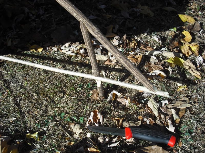

Today I made my figure four on the banks of the Erie Canal. I couldn't find a deadfall to save my life (unless I pried loose one of the paving bricks:rolleyes:), so I simulated a weight by pressing down with my hand. The knife is my 1950s'-era CaseXX Serpentine Jack.
