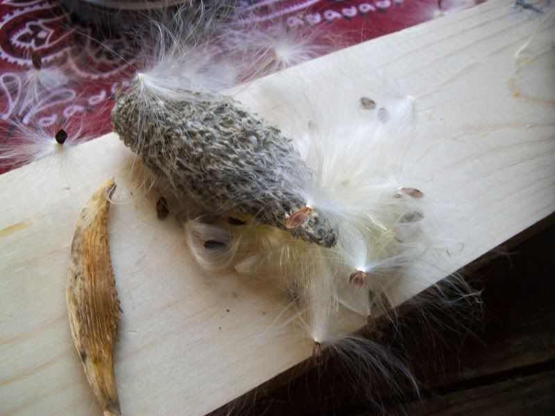

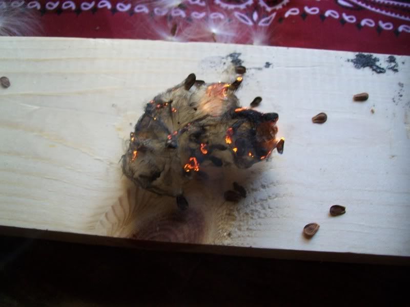

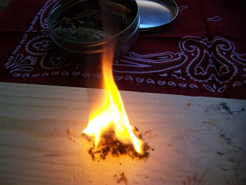

First up is some fluff from Milkweed pods. Its a flash tinder and requires the use of an extender of some sort. Honey Locust thorns, or wood shavings. This stuff goes up hot, and quick.
Next up Fatwood. This stuff burns forever. I got this chunk from an old pine that got cut down in front of the courthouse. Urban Survival I guess...:D
Seriously, I wish we had this stuff around here.
more to come...

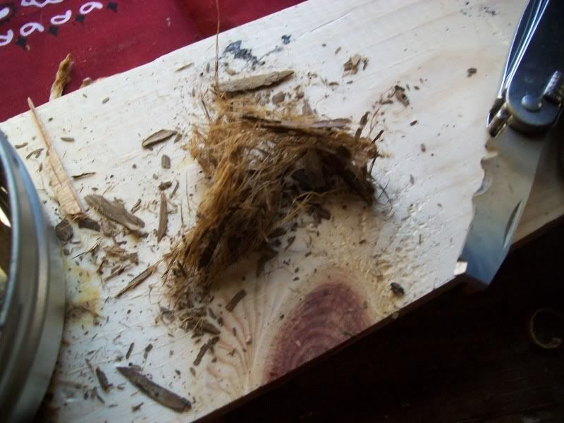

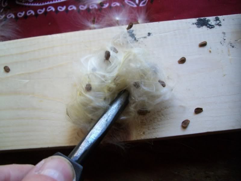

The centers from milkweed pods. Takes a spark nicely from a flint and steel, and a ferro rod. This stuff turns into a nice coal, that with a bundle of dry grass or cedar bark will blow to flame. This one might not count to some, but I consider it a natural tinder.

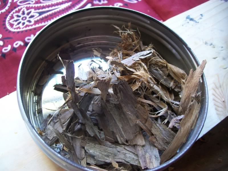

Good ol Cedar bark. My favorite nat tinder. Grows everywhere in MO, and is good year round. :thumbup:

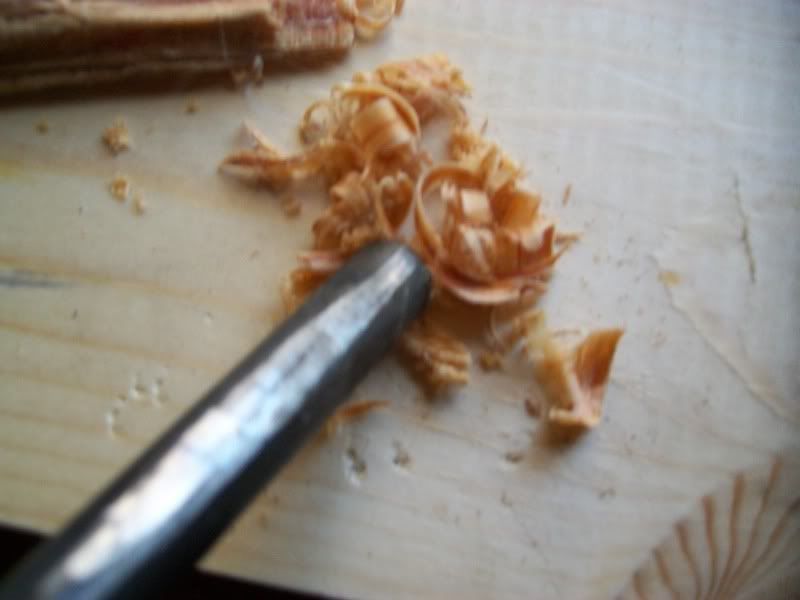

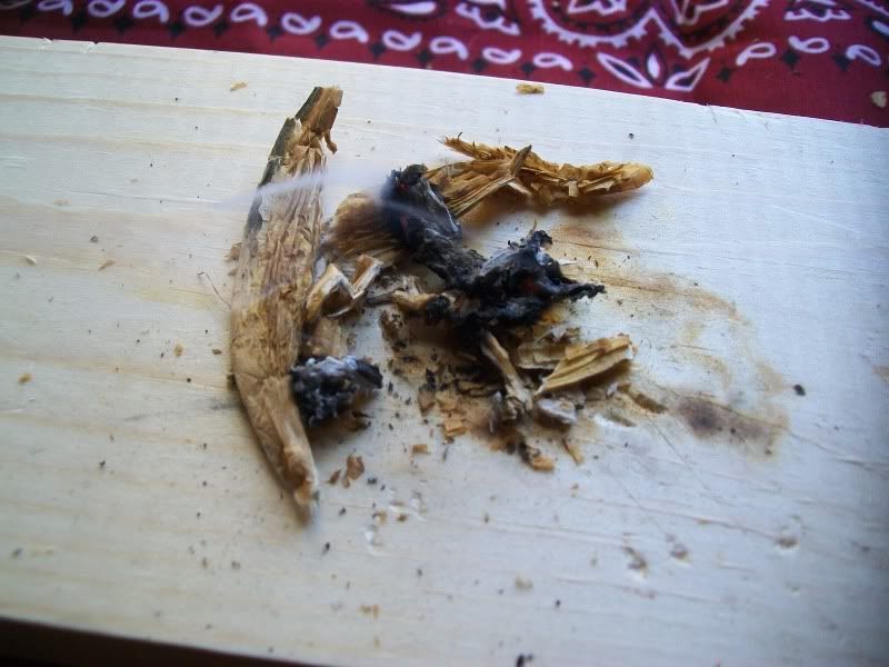

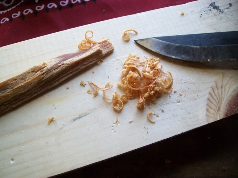

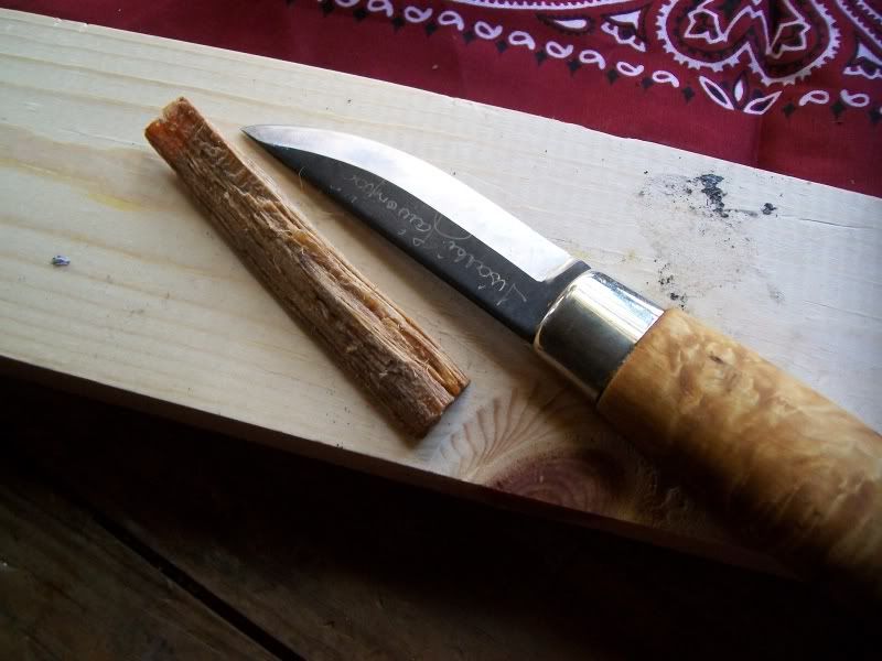

I thought that I would challenge myself with my second tinder and try to use nothing more than a dry stick.
Tinder 2
I tried a couple of different methods; a loose pile of shavings, and a fuzz stick.
Loose shavings is how I normally start fires, but I usually use a bit of magnesium as a primer. I thought that I might be hacking away on my steel to get a coal, and then have to blow it to flame, but after my second strike I got a pleasant surprise.

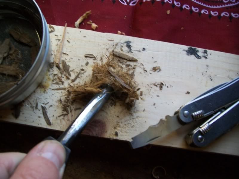

Flame 3

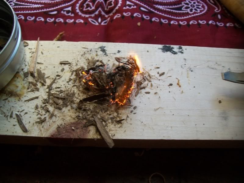

I normally only make fuzz sticks for windy conditions when loose shavings would get blown away. I thought that my success with the loose pile might have been a fluke, but after 4ish strikes I got a flame.
Flame 4
Next time I'm camping in the rain I'm going to try to bust open some logs and try to strike a fire with shavings from the core, (and then pull out some dry tinder from my kit:D).

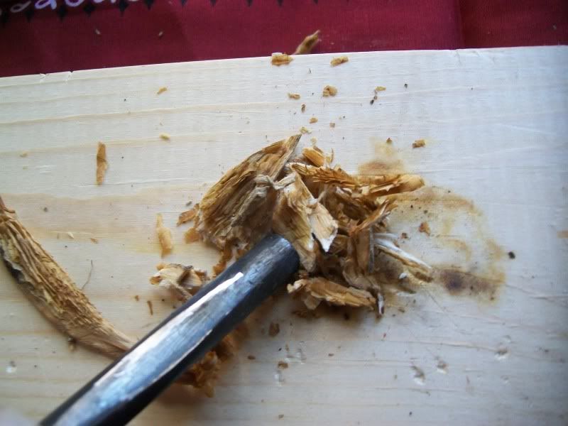

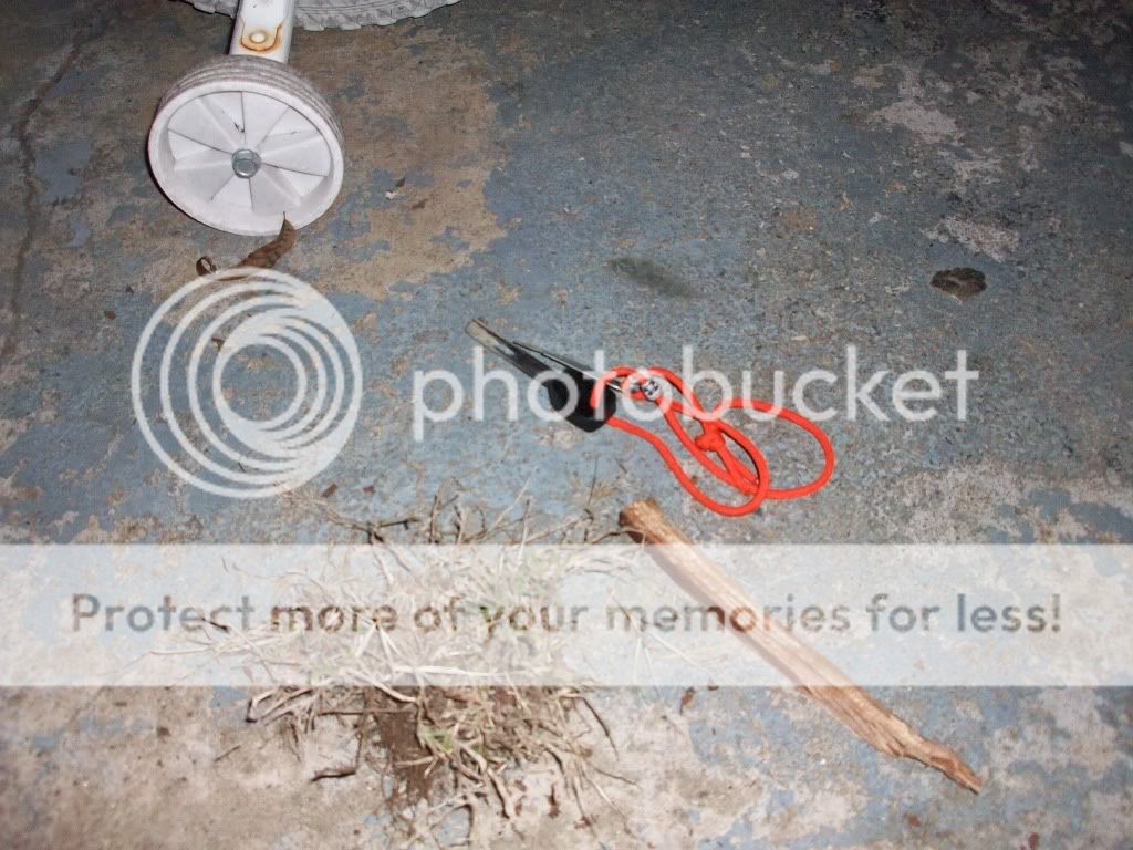

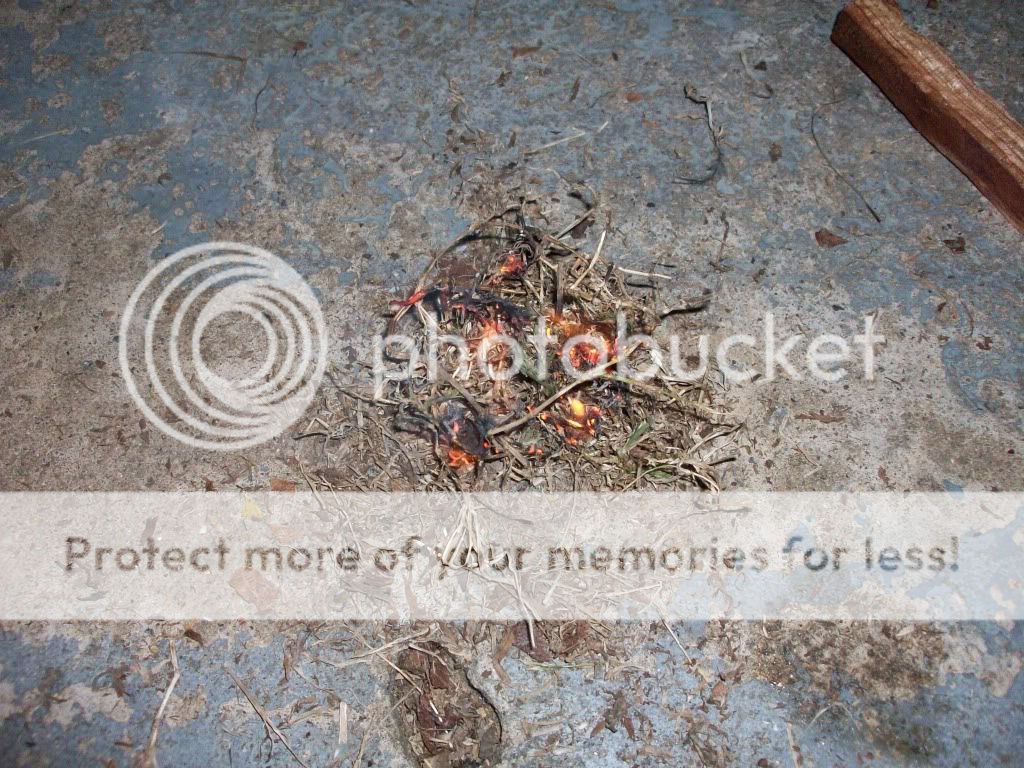

My two tinder for tonight, dry grass (crab, I think) and Red Oak, that been outside or a couple of weeks. Like J Williams, I shave my dry wood for my tinder most of the time. Works well. Here we go:
Grass first, rolled up and made into a ball.
Used my Mora Triflex to make the Red Oak Shavings, a couple of deep cuts and I was in the dry.
Thanks. Moose

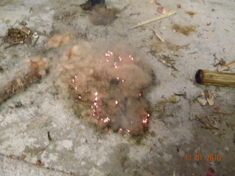

My next go at it, Cat tail fluff. Another flash tinder, but man does it really take off, with the littlest spark! It wasn't easy to catch the flame on camera once, little do it twice!
I know what youre sayin Skab! You gotta be quick on the draw with some of these! Thats where good prep can be the differance between fire or no fire.

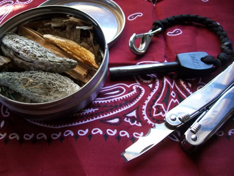

#1 Birch Bark
I rough up the end of the piece of bark to help it catch the spark.
Using one of my ferro rod based fire kits - a few sparks and it's lights.
