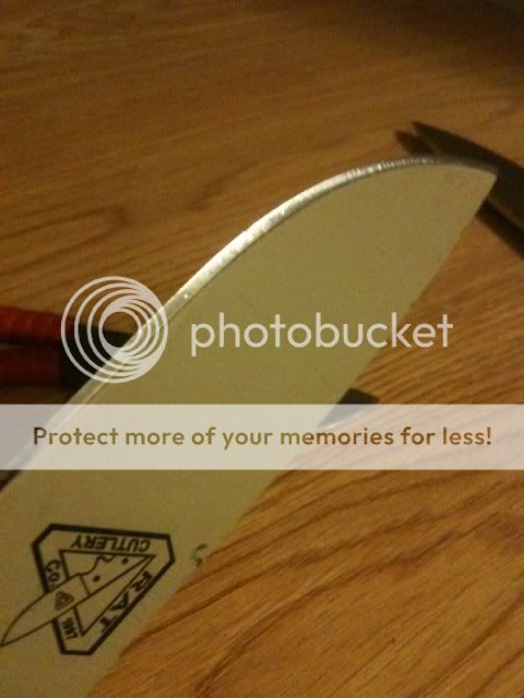

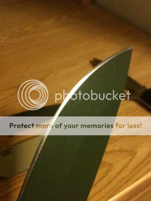

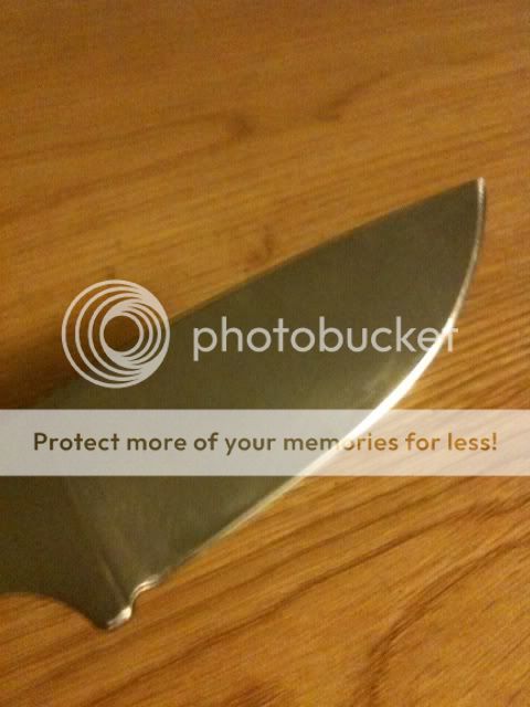

I just finished putting my rat rc-4,5, and izula to the paper wheels. I am very pleased with the result! I wanna thank richard j for opening my eyes to what I believe is the best sharpening system out there :)
