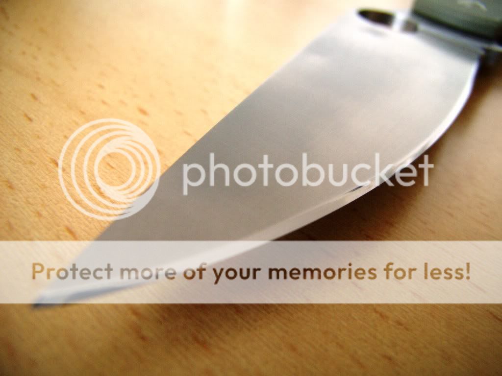

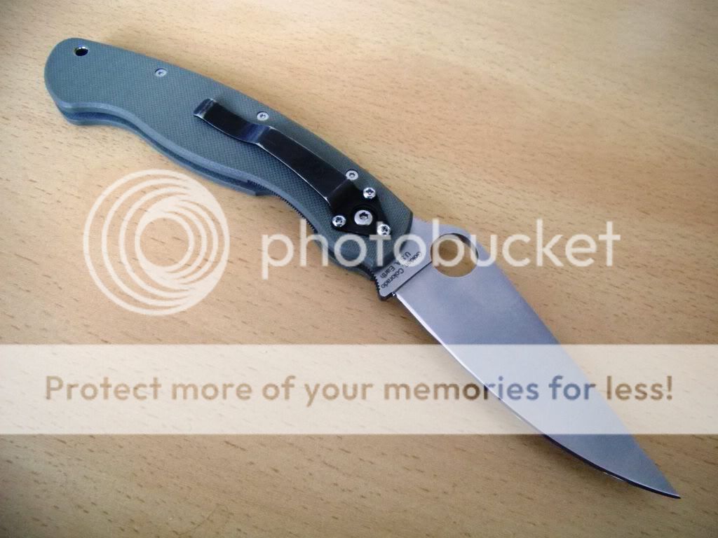

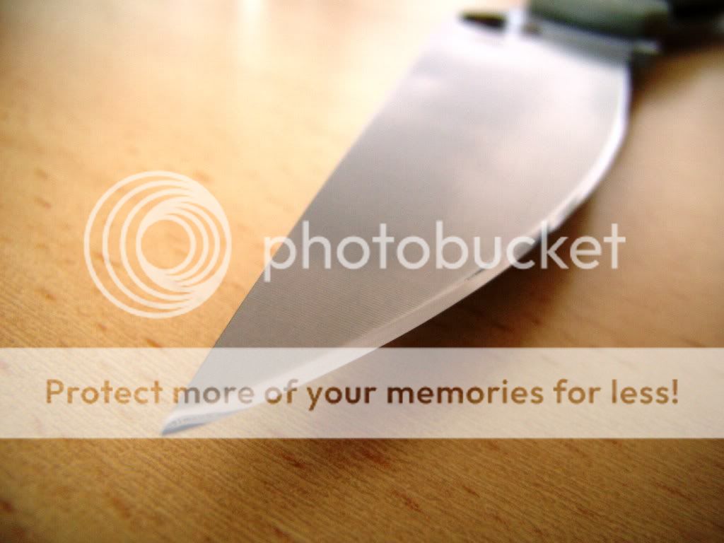

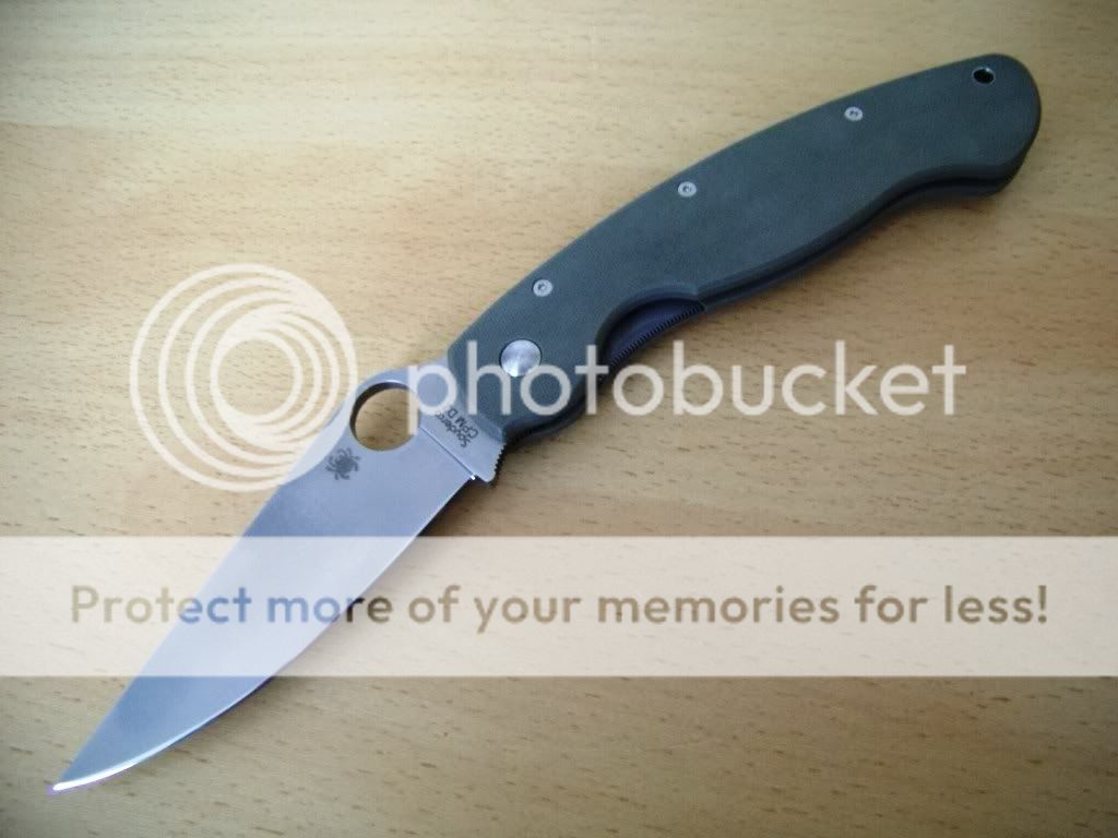

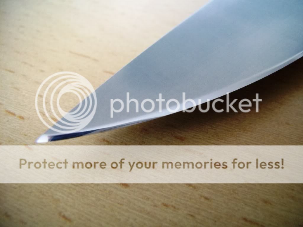

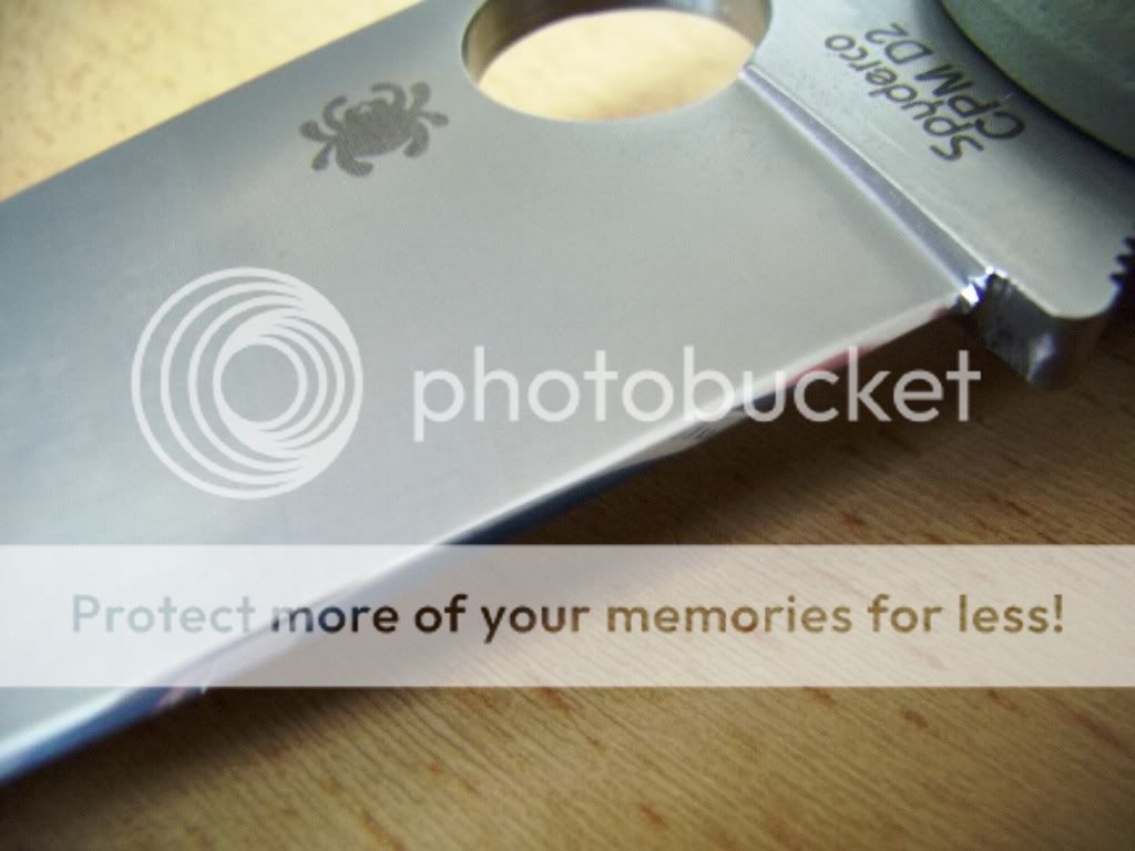

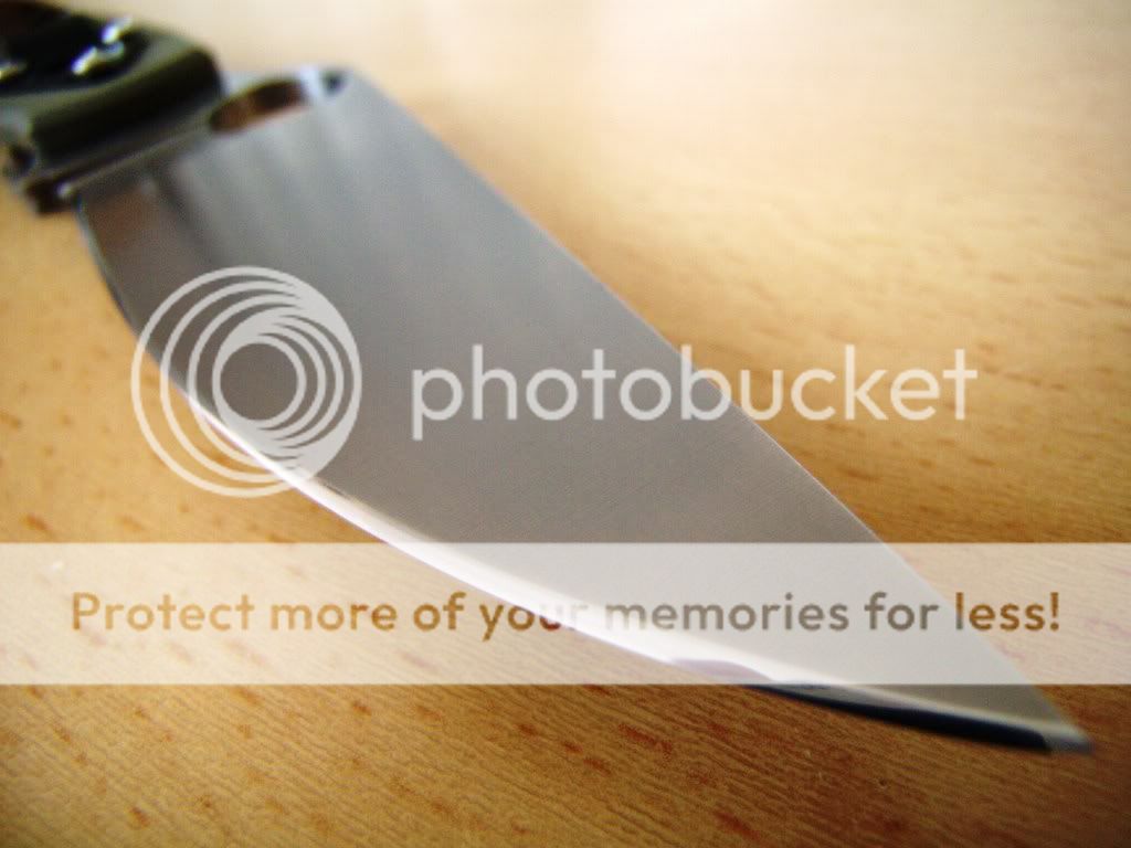

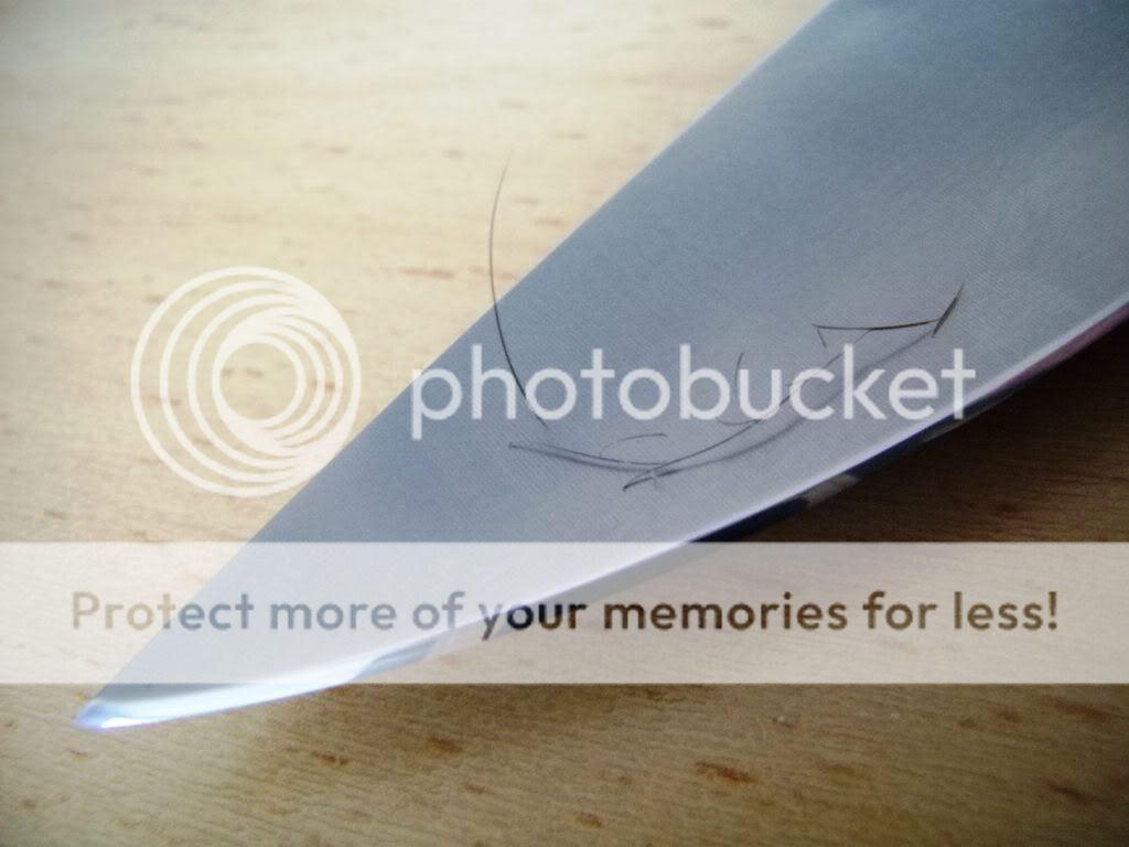

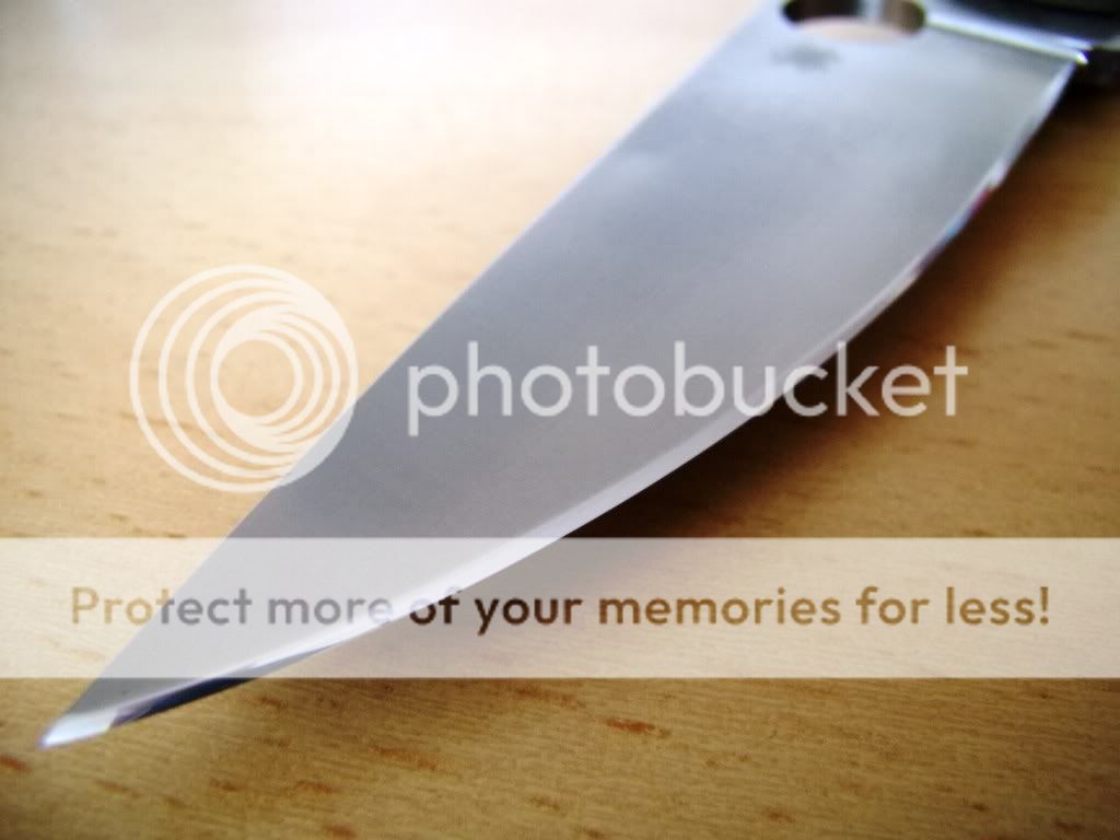

Recently i bought this CPM-D2 Millie second hand as a user.
It had some blade play (fixed it), some discoloration on the blade (left that) and it wasn't quite sharp (fixed that with the Paper Wheels)
Wow, that looks great. How did you like using the paper wheels? I talked with Richard J about them and really like the idea. I just haven't found a motor yet, lol.
there has been a lot of talk about what speed to run the wheels at. i have used the wheels for over 18 years on a 1725 rpm motor even though i have a buffer i can run up to 5.000 rpm. i have tried running the wheels around 3.000 rpm but ended going back to the lower rpm. the lower rpm will also be more forgiving and not remove metal quite as fast should you mess up. i know the website suggests a high speed buffer but there is no need to run them that fast.
