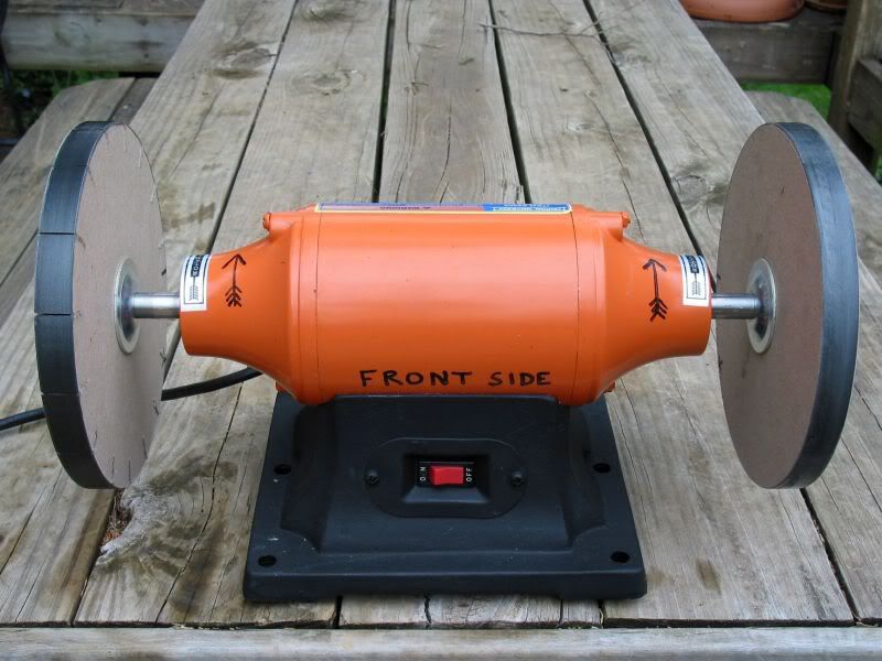

Here's my setup. I got this buffer with these paper wheels. I remounted the motor on the stand so it rotates away from me. It's all good.
Sharp, sharp, sharp!! :)
