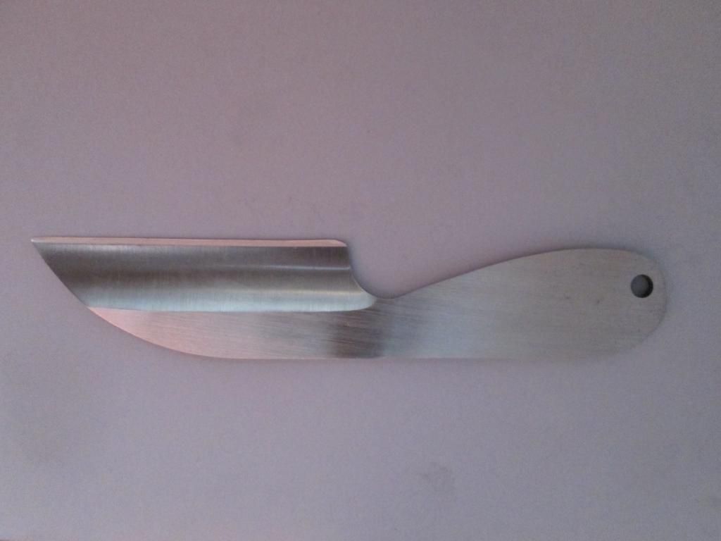

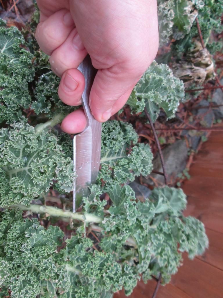

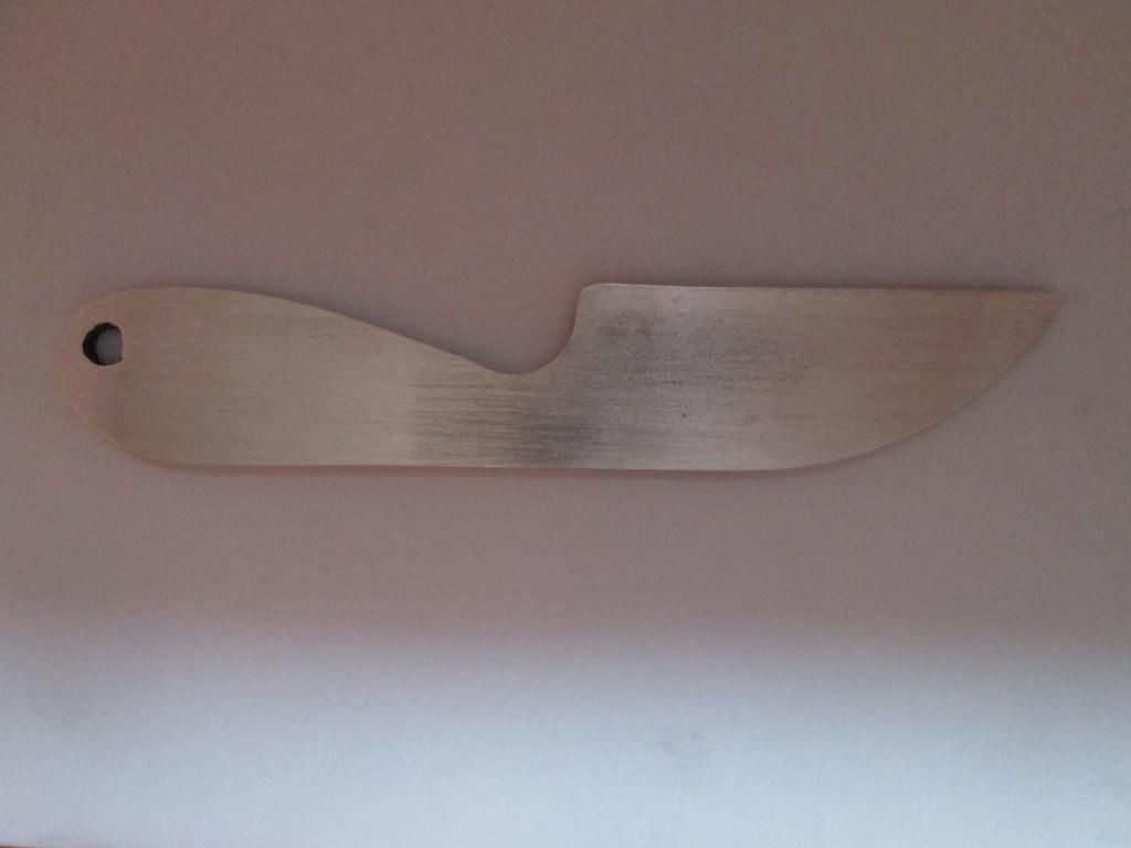

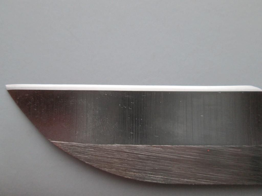

Here are some pics of a Richard made knife he made for me.
Sharp I say.
