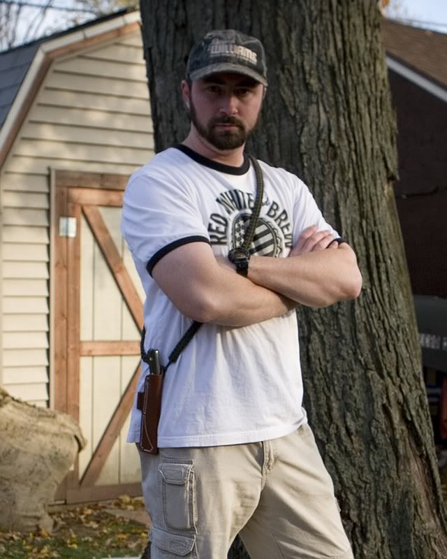

Jeff H helped me figure it out with many links, e-mails and diagrams. I really appreciate it Jeff :thumbup: I figured I at least owed him a picture or two.

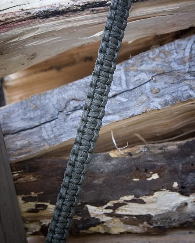

Close up of the knot detail.
I had my son take a shot of it on me. I probably made my a touch "short" but it was on purpose. I experimented with a few different lengths, and I like where this one hangs, even with my thickest jacket on.
When it gets too low, if feels like it is dangling too much for me. Here is my ugly mug with it on.
There is approximately 50' of cord wrapped up in this thing.

It took only a few minutes to measure everything out, and lay it out. Then it took me about 20 minutes of scratching my head and looking at diagrams to try and figure out what I just did :D
After that, the tying seem to go fairly quick. I kind of lost track of time. I am guessing and hour, maybe an hour and half.
Now that I have done one, the whole layout thing seems easy and it would probably go quicker next time......less head scratching, I hope! :D

Kind of. There are two pieces of cord in the center that set the length. Right now there are two equal length loops on either end. You could feasibly start untying one end, cut some cord and button it back up. The overall length would not be changed at all, and the baldric would still work fine. However, one end would have a 3" loop and the other end would have a longer loop depending on how much cord was removed.
I have another tied with a different knot. This one is more flexible, but IMO not as nice looking. This one can be easily unraveled by starting at one end and pulling (no untying). The difference here is that you will just shorten the overall length, but it would still work.

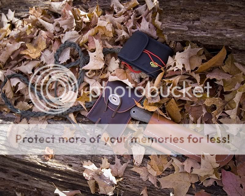

This will help you guys tie one of your own. I posted this a while back and I am sorry the pictures aren't better quality.

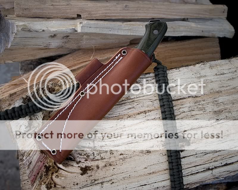

As for the "sort of neck carry," these are stiff enough you can reposition them to stay put.
Next, you can do one of these. It too is one piece of cord but I have SO forgotten the ratio on this one and it is critical to get it to come out right. It's a very simple braid that leaves you a "tail" on each end to tie however you wish and it is light, just wide enough to not cut into your neck (with a light knife) and has some "spring" to it. I owe a cople guys some instructions on this one and hope to get time this winter to do a better job of it than what I put Brian through.

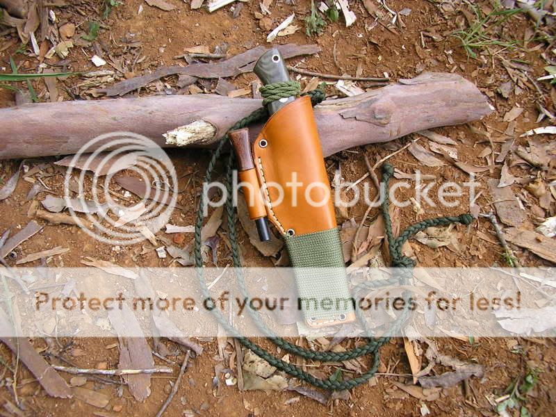

I really like this method of carry. Here is my rig.
