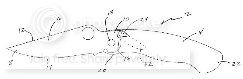

No, Not a Back lock. The "Stop Lock" is a new original locking mechanism designed by Spyderco
I am not sure exactly how it works. However, i think it the Lock is the Stop pin, and a lever shifts the stop pin, to unlock the blade... i think
Here is a diagram:
more information on the Stop-Lock can be found here: (sorry, I cant figure out how to turn on HTML)
http://www.freepatentsonline.com/6918184.html?query=IN/(glesser)+&stemming=on

:eek: Interesting. Is it slim like a linerlock? Can it support open pillar construction? What's the weight? I don't quite get the whole idea, but it looks neat.
if you log in you can see a PDF that explains the lock in more detail. It's sort of like a compression lock, except instead of using a piece of the liner to go between the stop pin and blade tang, it uses a little lever type thing that rotates around the stop pin. It looks like externally it would operate similarly to a back lock, except it should be stronger because a closing force would compress the lever between the stop pin and the blade, rather than applying a shearing force too the lockbar.

The lock bar is pulled upward and away from the handle?
I dont think that I will be interested in that design.

The patent covers the lock mechanism, and allows for different ways to release it. The lifting lock bar is one of 2 described in the patent, and others are clearly possible. The advantage of the lifting lockbar is that it makes it impossible to accidentally release the lock when applying downward pressure.
We don't know what type of lock release mechanism Sal will end up using on the forthcoming Military 2.
