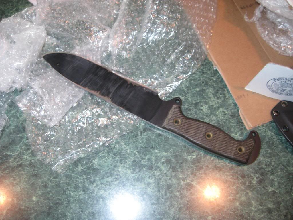

So I finally got these out last night. Both are nothing short of amazing. The SHBA would probably be my favorite Busse that has come through my hands. The hand ground smooth pin handle is so comfortable. It is a thick little beast but has a wonderful flat grind. I am not sure if the finish is just worn off or if it is just naturally patina finished but I love it. Is the SHBA A2 or INFI? The difference between these hand done knives and the CNC versions is amazing. I love both but I really appreciate the work put into these.
Here are a few quick pics. My daughter wanted to compare it against her cupidivore! Dont show any mothers this thread!!!
Thanks,
Zach
SHBA is A2 and it was cold blued some time ago.
SHSH (precious) is INFI.

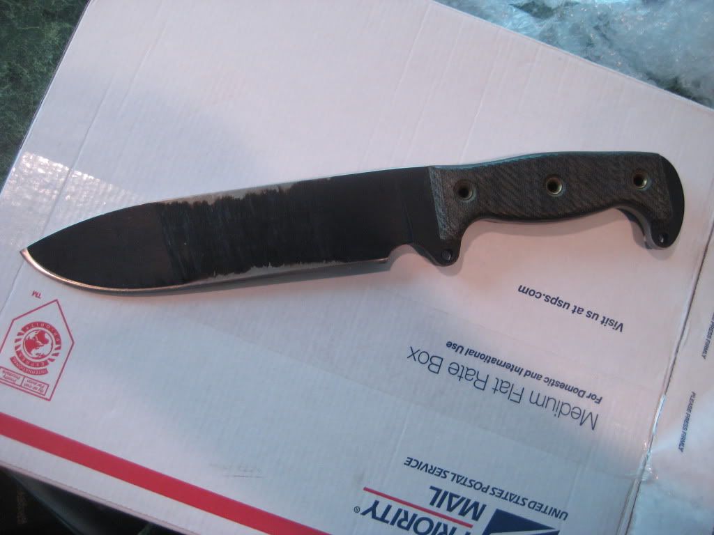

The knife came. Feels great in the hand. Nice sheath, looks like an Okuden sheath to me (never owned one, but that was my first thought).

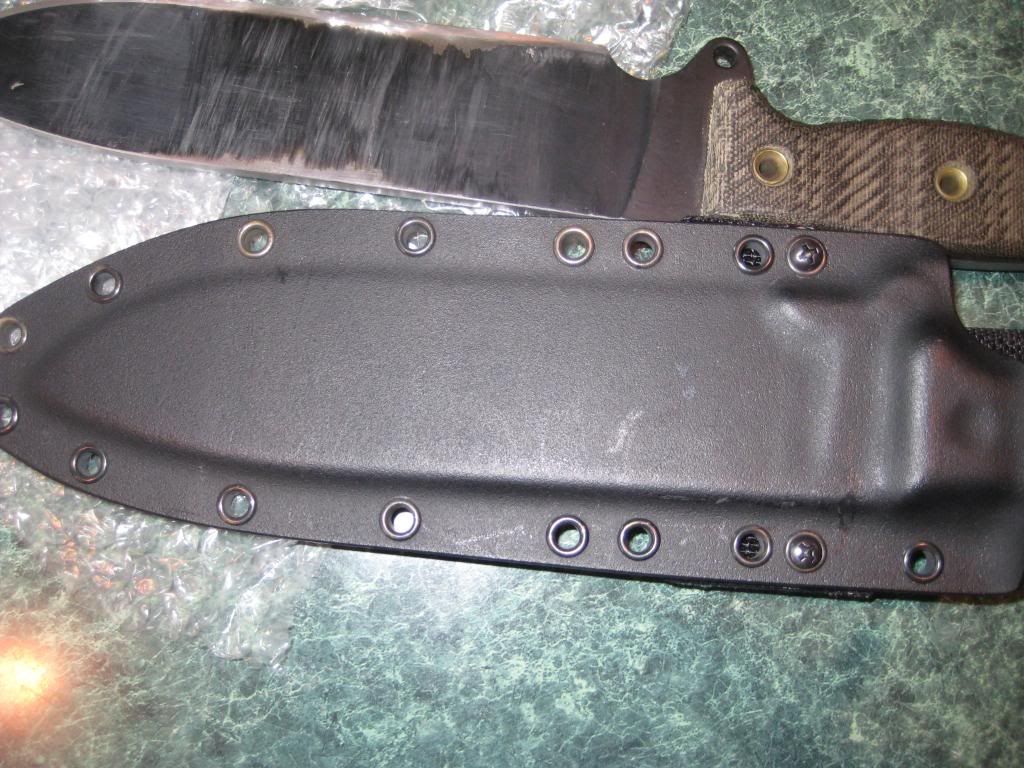

This knife is a user for sure. Here are the "as received pics."
Packed well.

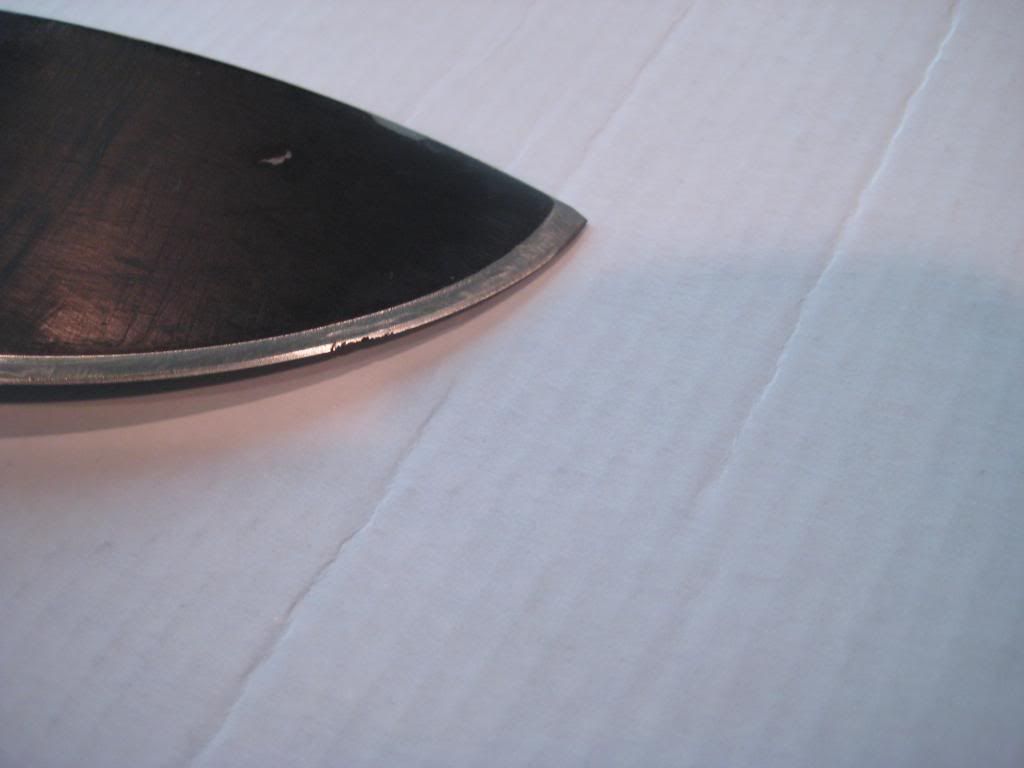

The edge had some rock rash in a few spots.
Other side
There is a ding on the spine on the right side looking from the top. Looks like a rock smack.
The edge toward the tip was a bit uneven on one side. Looks like a higher bevel and then a back bevel. More pronounced on one side.
I love the rope cut handles. I would like to see this as an option on all knives. So comfy in the hand (albeit with no chopping yet).
Overall, very impressed with the feel in the hand. Very different than Ash1CG that I have owned and used. The shape of the handles is flat, with a bit of contour, but fits the hand well.

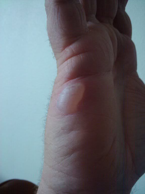

So luckily I did a bit of chopping on Friday because I burned my hand this morning! Stubbed my toe on the corner of the sink counter, and planted my hand on my wife's hot curling iron. My chopping hand!

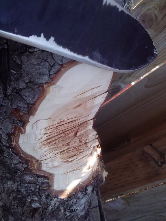

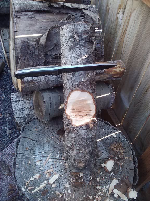

But I did get some pics of some chopping Thursday. You will have to forgive the pics, these are phone, as that was all I had at that time.

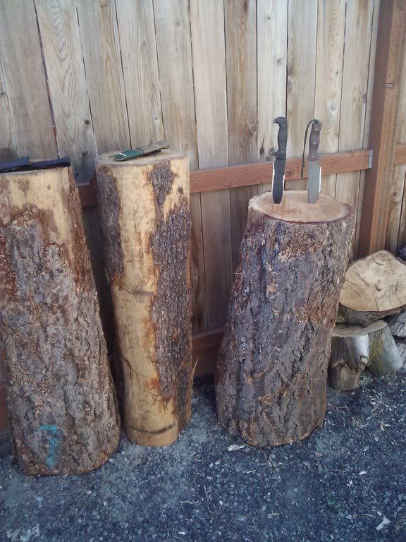

I compared a SarQ, the SHSH, and a Condor Hudson Bay, as these were three that were relative in blade length, but not thickness.

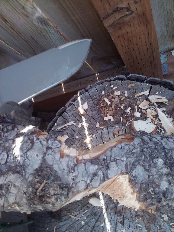

Chopped a bit on a small log. I did not resharpen the knife before chopping. I figured I would take the existing dings out after.
The SHSH chopped better than I expected, even with the dull edge and some rock rash on the edge.
This was the SARQ. It has a sharp polished convex.
On the Right is the notch from the SarQ, and on the left was the notch from the SHSH.
Here is the Hudson Bay from Condor. This is the older version that came coated. I stripped it and did a vinegar patina, and took the convex edge up higher. I mostly use it in the kitchen. The handle is a bit short for all out chopping. It makes a great kitchen knife. Enough Knuckle clearance for cutting on the board. The steel is lowly 1075 or 1065 if I remember correctly, but the edge retention is not too bad for the price! With a tiny bit more handle, it would be even better. I want one a bit taller in the blade, a bit longer, and with more handle out of INFI!!!!! Like a Monster Muck!!!!!

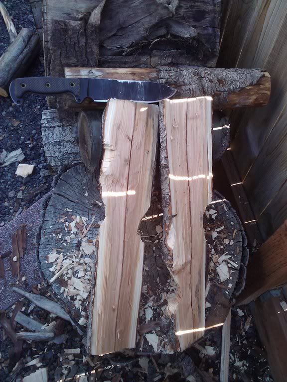

Time to Baton the Big Stick!
Took a bit of whacking, but I got it through.
Overall impression in actual use. The SHSH is more capable and comfortable for chopping than I expected based on the Ash1CG. The extra blade length helps. For some reason, the handle actually felt more "roomy" than the Ash1CG. I think the dimensions are the same? Maybe it was the thinner rope cut handle that made the difference. Or the stripped handle. The finish on the coated CG was rougher before I stripped it on my Ash1CG and that might have contributed to "pinky bite" feel.
The thickness felt just right for this size blade. Heavy enough to chop decent for its size, but not too heavy. It felt better balanced for choppingthan the Ash1CG, but I did not have them side to side to compare.
