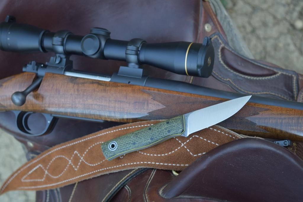

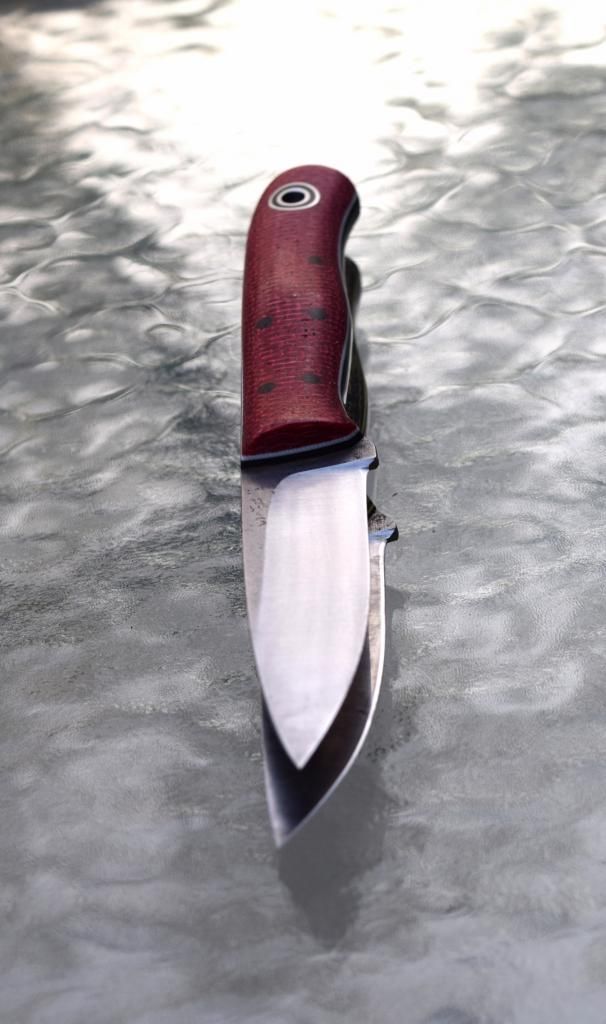

The Patch is a new Fiddleback model that is a scaled down version of the Recluse. It is similar in size to the Hiking Buddy which many of you are familiar with. The Recluse family share the squarer pommel shape, straighter spine, and a nice amount of belly to the cutting edge. The Patch was first introduced on Fiddleback Friday - 07/11/14.
The other model in the Recluse family is the larger Leuku. I don’t have a Recluse, but I do have a Leuku to show for size comparison with the Patch.

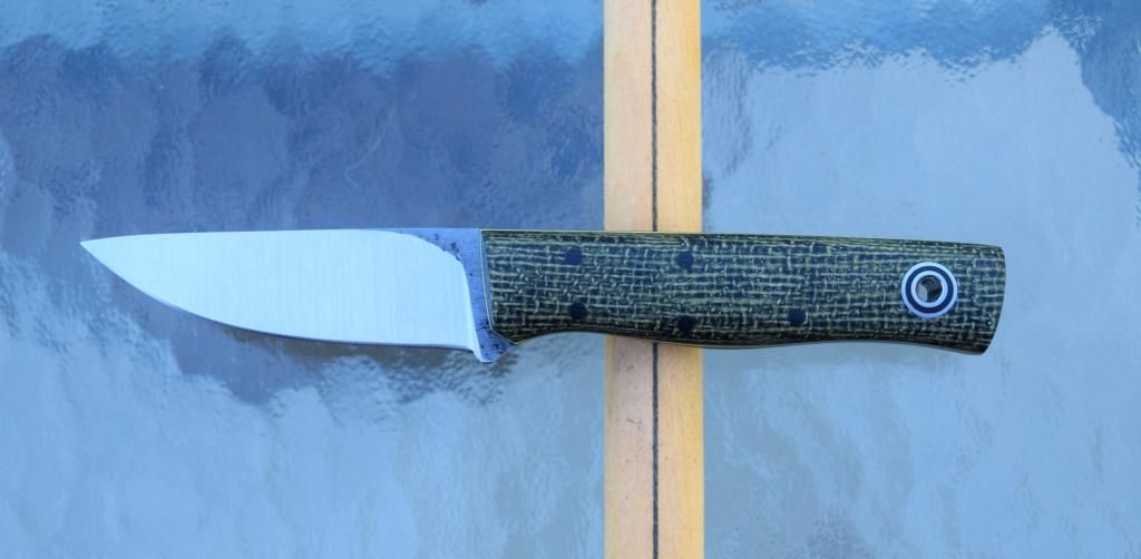

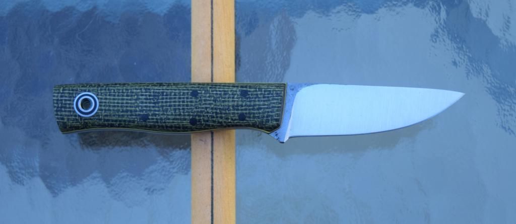

Here a couple of photos showing the balance point:

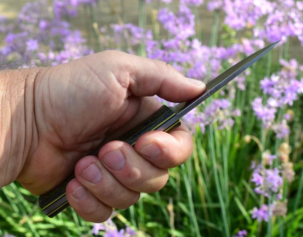

In Hand Photos:

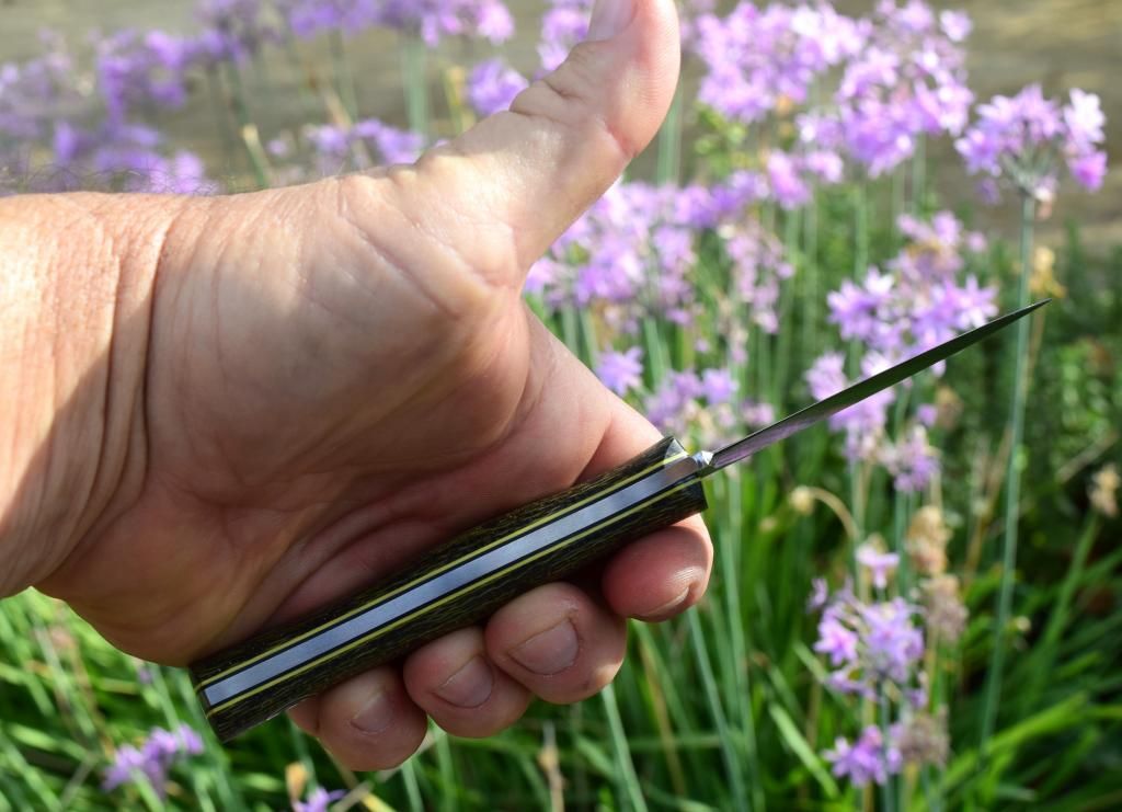

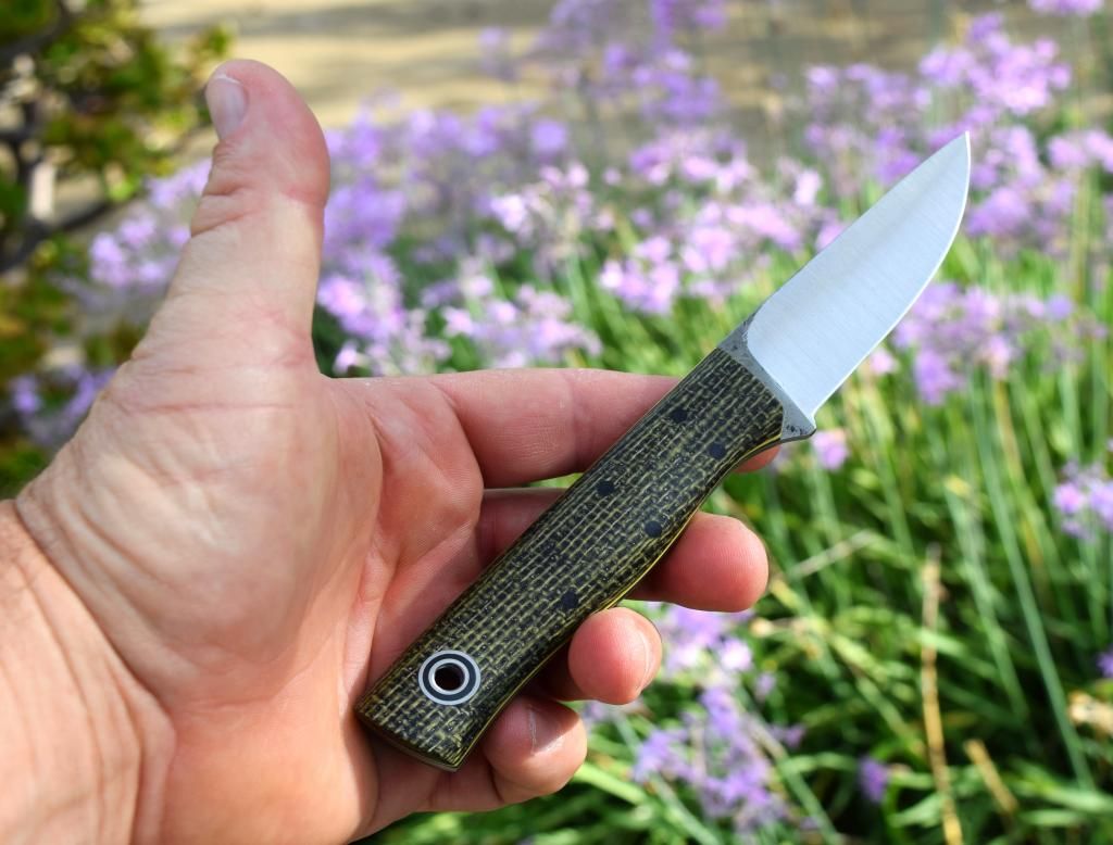

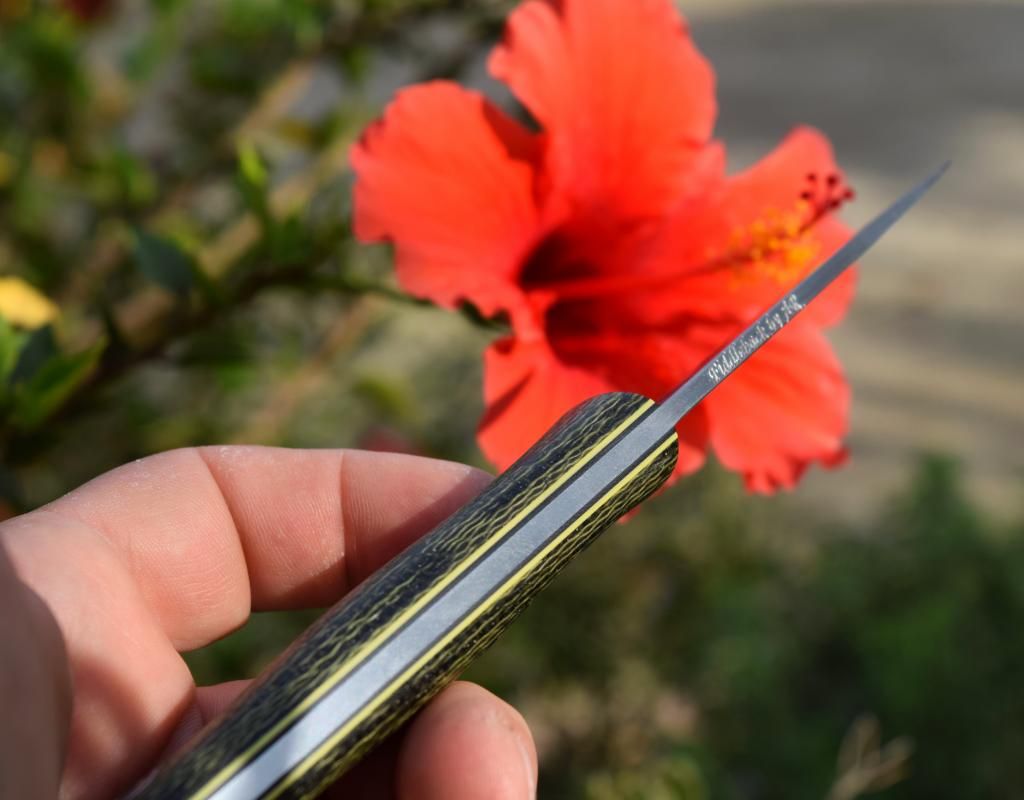

I find in hand photos to be a helpful reference point if I know the dimensions of the hand size. My hands are medium size and measure 3-3/4” wide across my palm and 7-1/8” in length from the tip of my middle finger to the base of my palm where it meets the wrist.
With that reference point, here are my in hand photos:

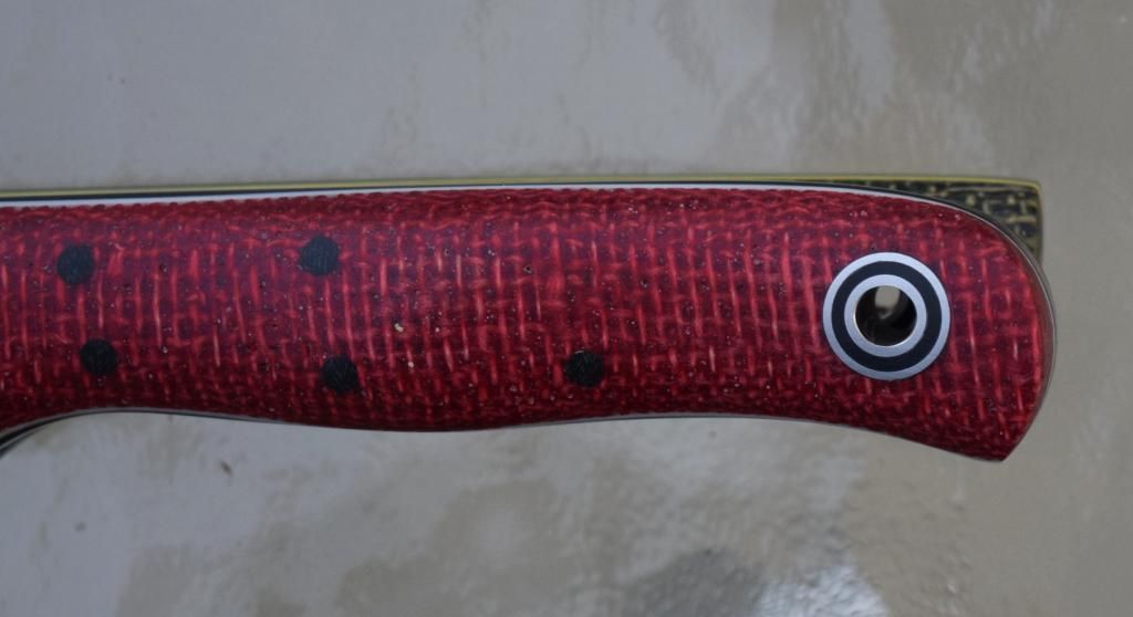

The yellow G10 pinstripe looks really sharp with the Shadetree Evergreen burlap. This color combo should appeal to Green Bay Packers fans.

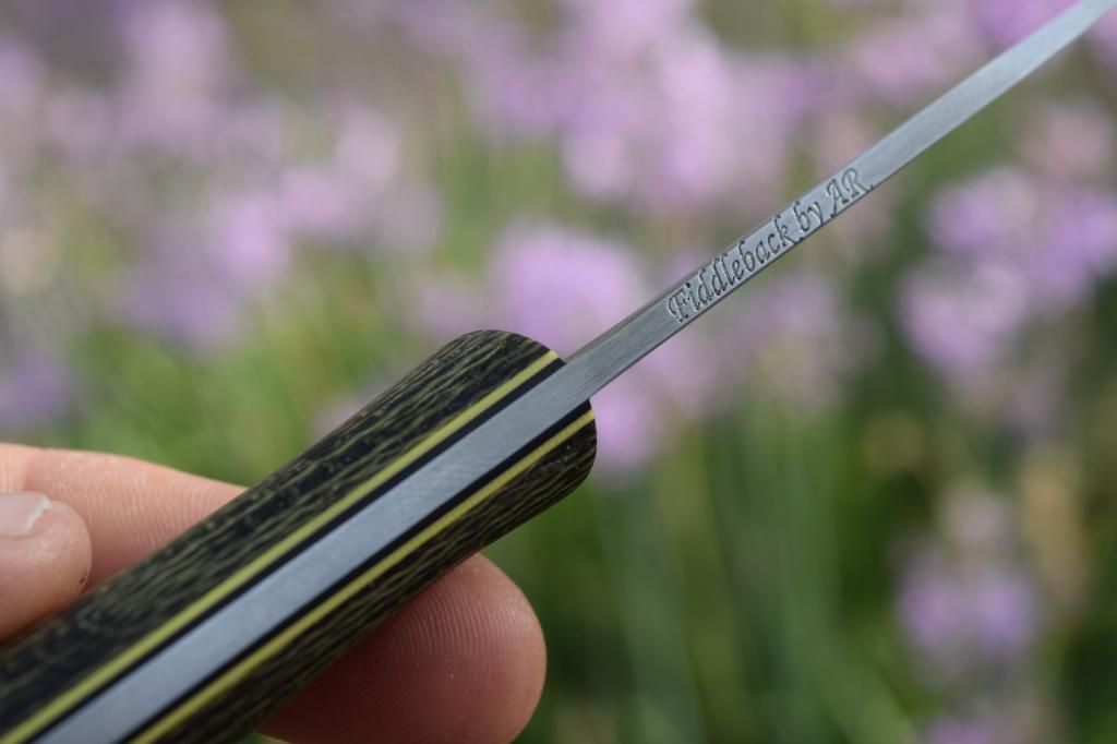

One of my favorite subtle features on Andy’s knives is the positioning of the maker’s mark up on the spine where you see it every time you use the knife. I like the fact that it isn’t taking up real estate on the side of the blade to distract me from looking at the nice grinds and spalting.

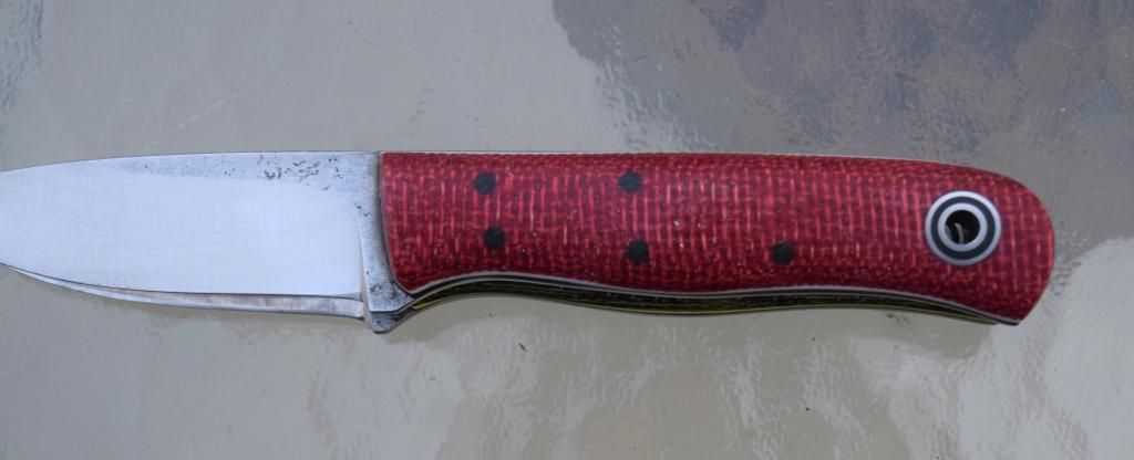

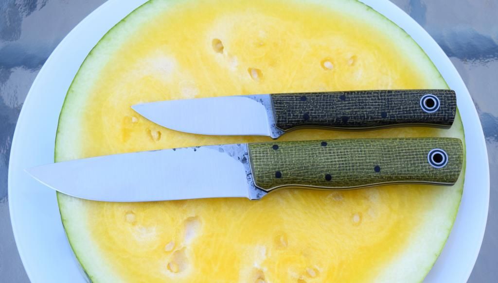

Comparison Shots:

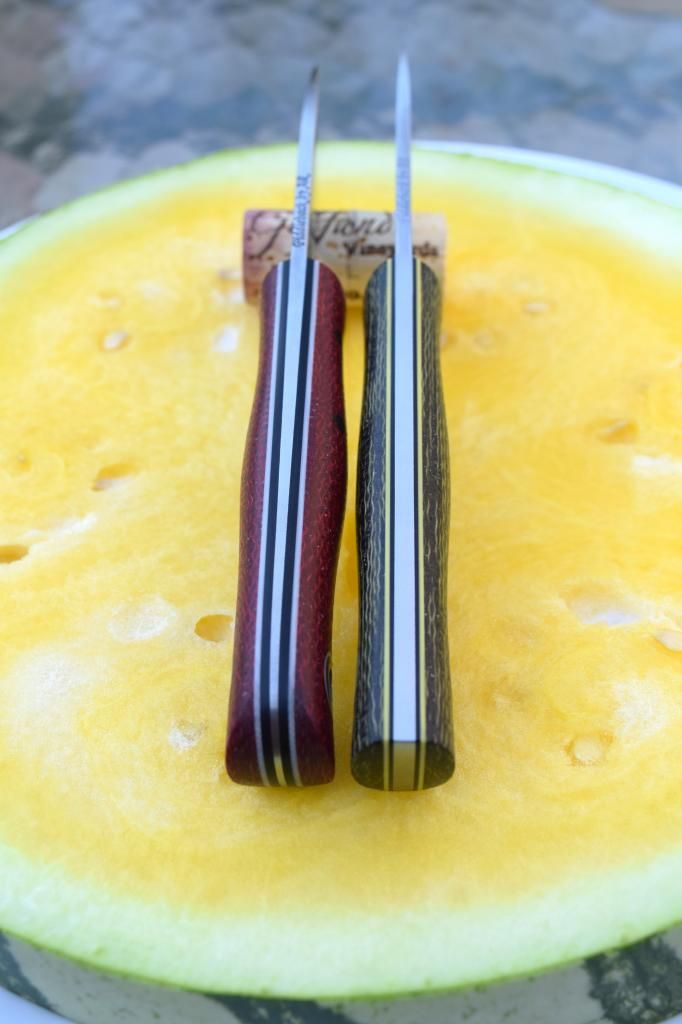

I always find comparison shots to known reference knives to be very helpful in deciding if I am interested in a particular model. The best reference point I have in my collection is the Hiking Buddy. The Hiking Buddy is one of Andy’s most popular 3” models that is designed to fill the small bushcraft / day hike role. My particular example is 1/8” O1 spalted steel, tapered tang, and Shadetree Ruby burlap over black G10 with a white pinstripe. It weighs 3.4 ounces.
Here are a couple of comparison photos:

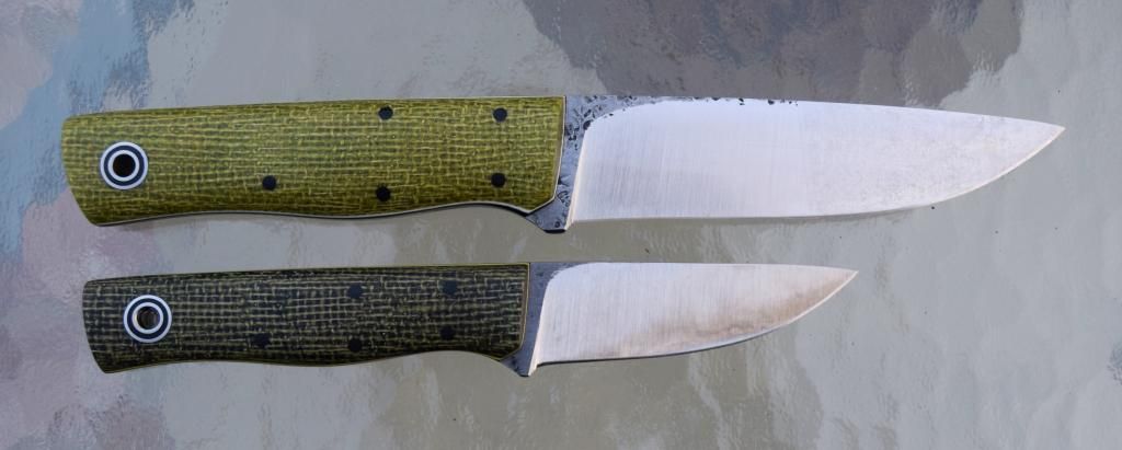

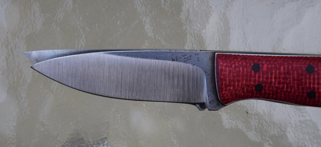

Overlay shots are hard to do right. Even so, I took these photos with the Hiking Buddy on top of the Patch to point out some differences between these two models.
The blade tip on the Patch is higher than the Hiking Buddy.
The pommel end of the Patch is squarer versus the rounded pommel of the Hiking Buddy.
The handle on the Patch is narrower and a little taller than the Hiking Buddy. The blade height at the ricasso is also a little taller on the Patch.
You get more cutting edge area with the Patch versus the Hiking Buddy.
A couple of other observations here:
First, my Patch weighs 3.7 ounces with 1/8” thick O1 steel versus 3.4 ounces for my Hiking Buddy with 1/8” thick O1 with a tapered tang. For you Ultralite backpacking people, I strongly suspect that a tapered tang Patch with 1/8” thick O1 steel would weigh 3.4 ounces with similar burlap handles, maybe less with light weight wood or carbon-fiber synthetic.
Second, the handles have different shapes. The Patch is taller and narrower at the palm swell @ .928” high x .660” wide. The Hiking Buddy measures ..880” high x .730” wide at the palm swell. This may not sound like much, but the different feel is noticeable. Interestingly, the circumference of both knives is identical @ 2.750” at the palm swell. The Patch feels like a long oval versus a rounder oval on the Hiking Buddy. For that reason, I suspect that the Patch may provide better control against torque slippage in your grip.

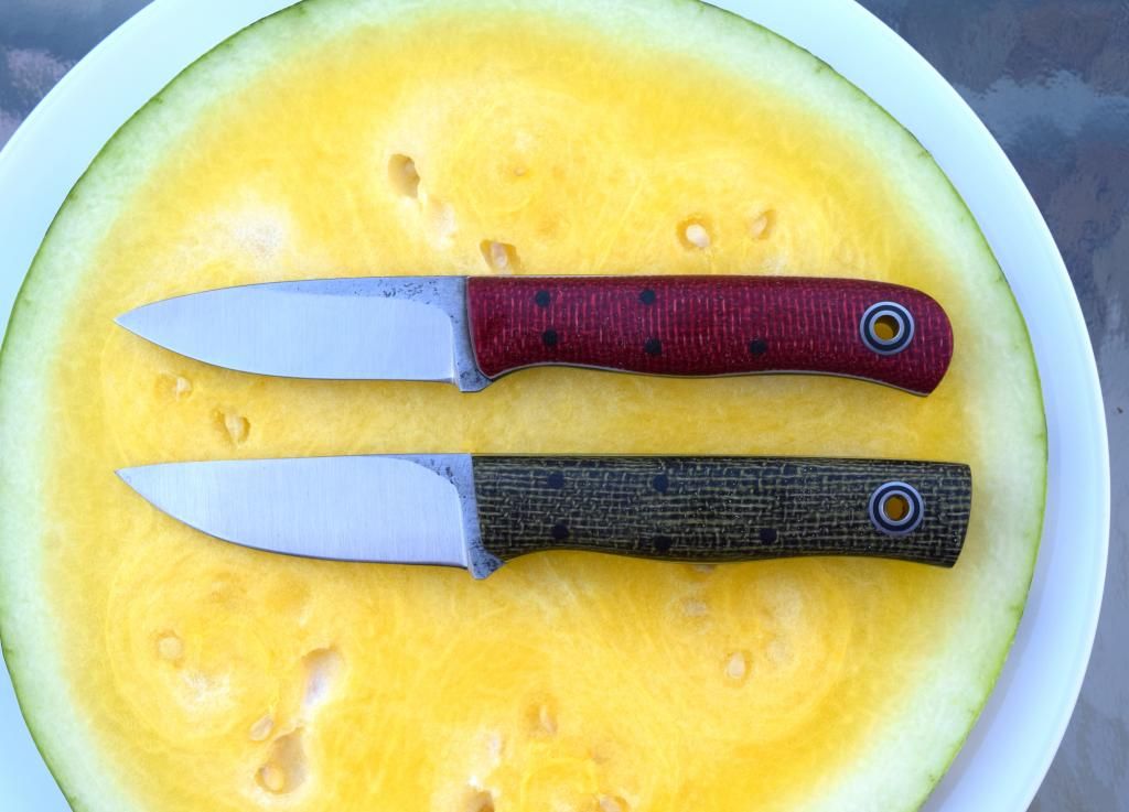

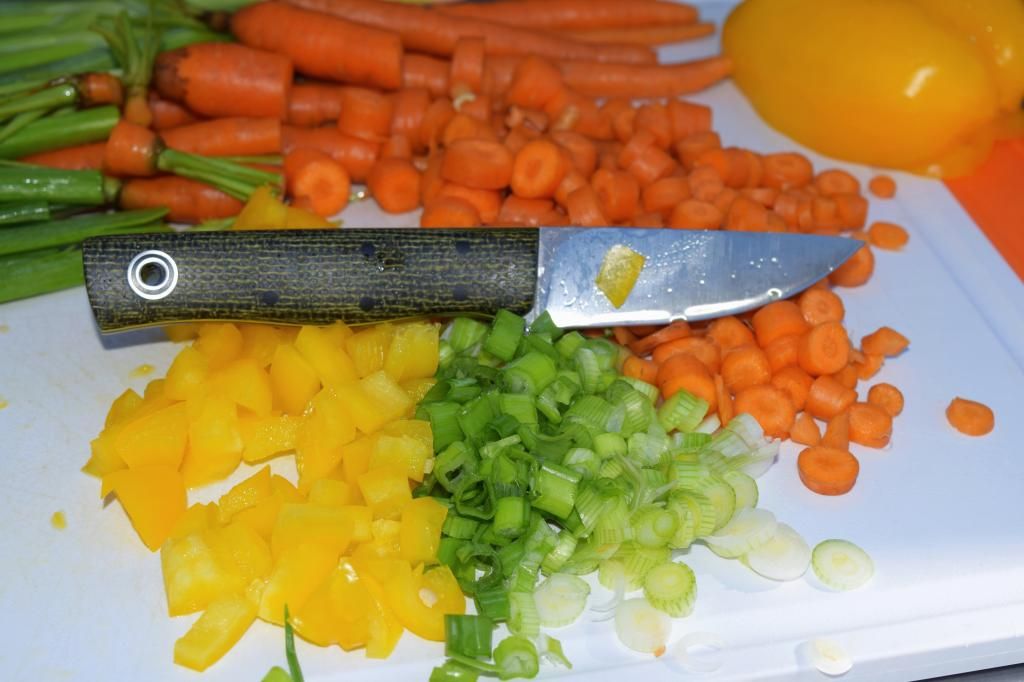

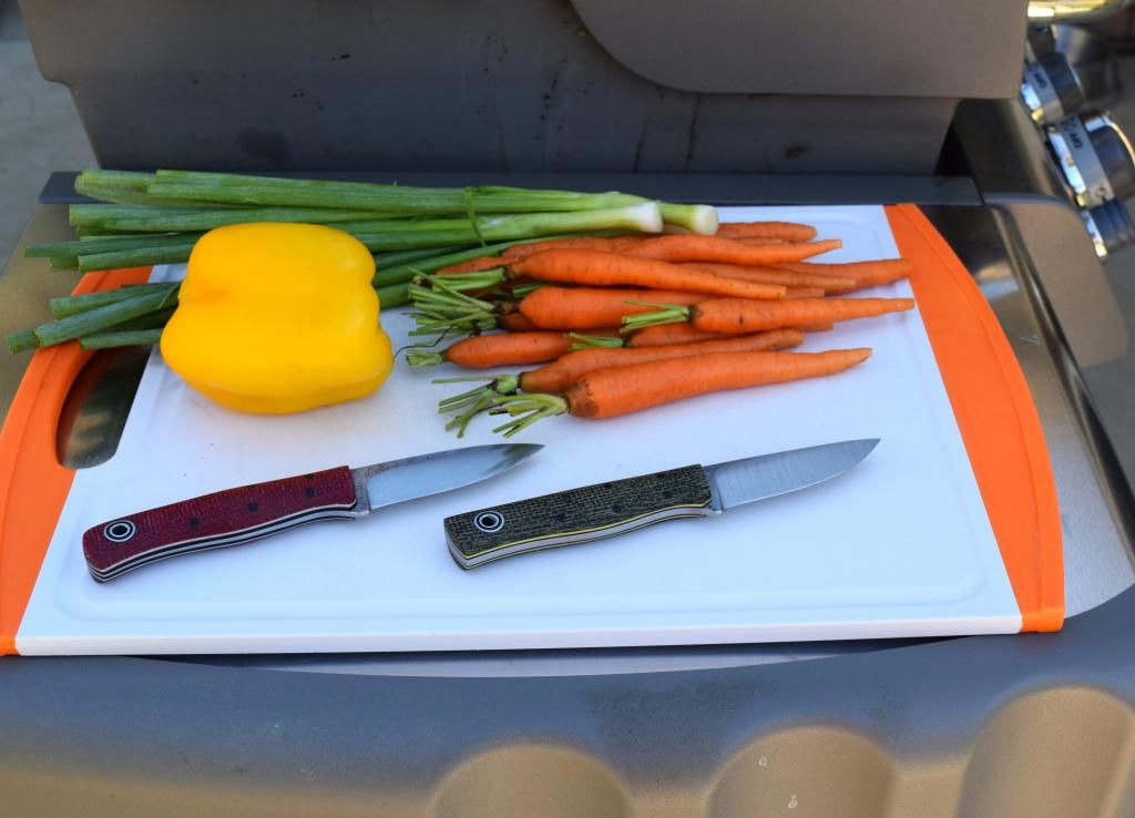

Food Prep Notes:

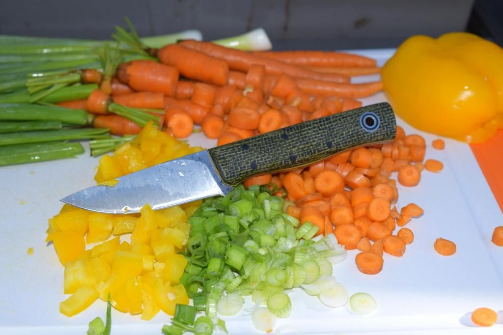

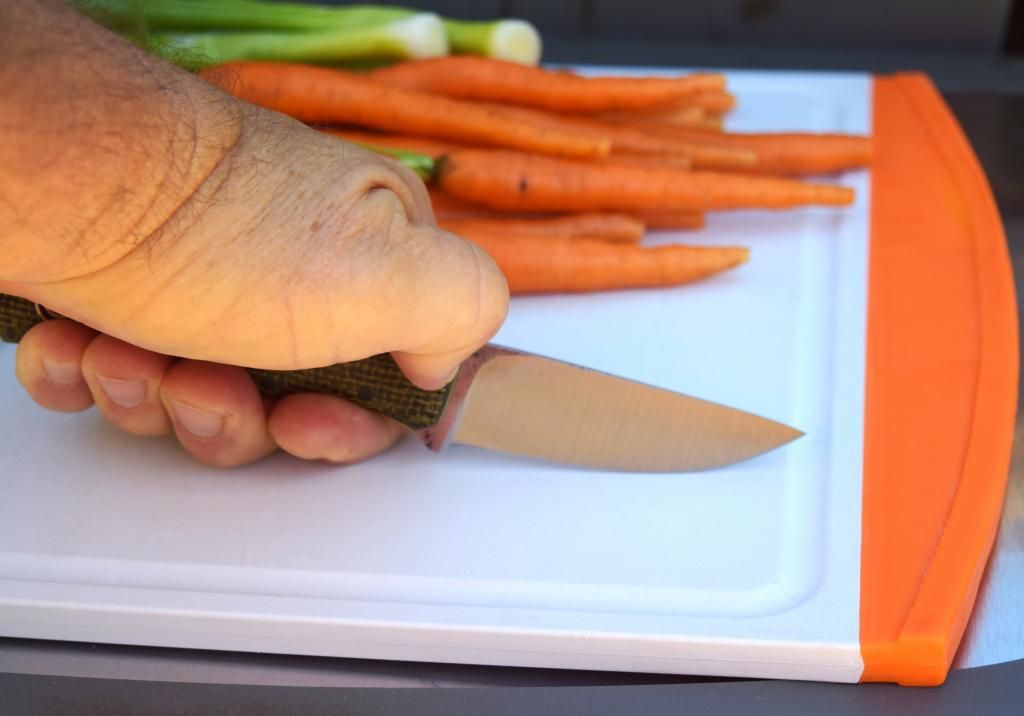

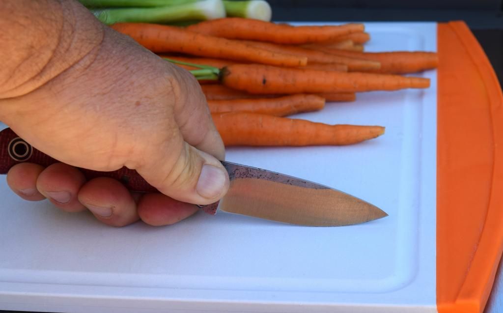

I used the Patch to cut up some small vegetables for a salad to go along with a BBQ. Again, I wanted to compare it to the Hiking Buddy that I frequently use in that role.

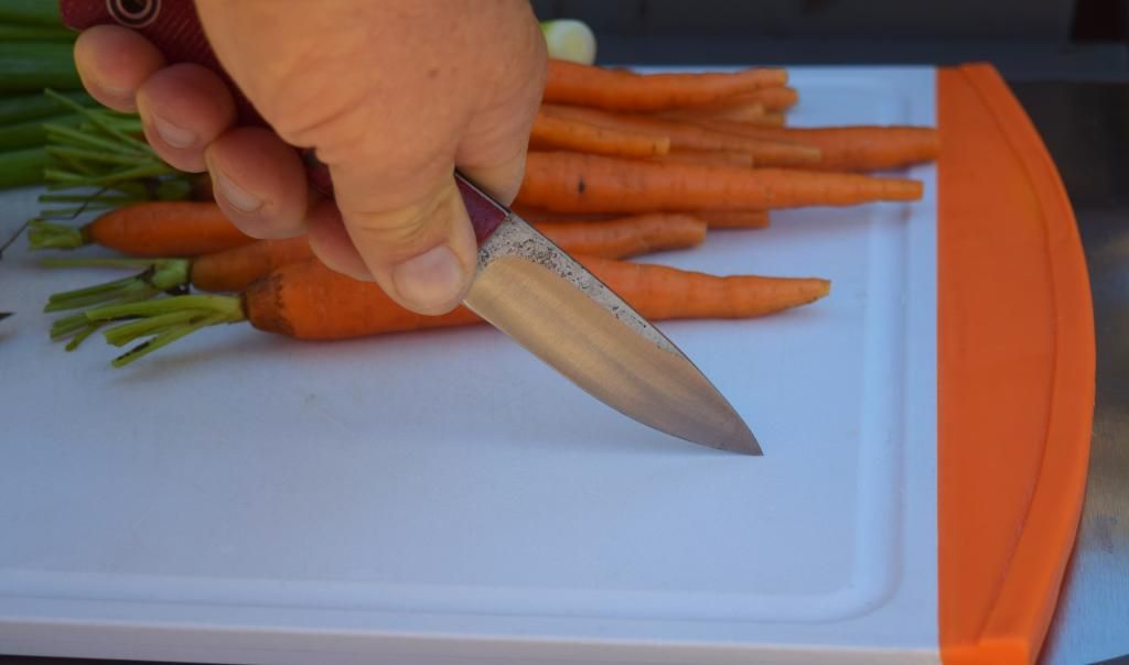

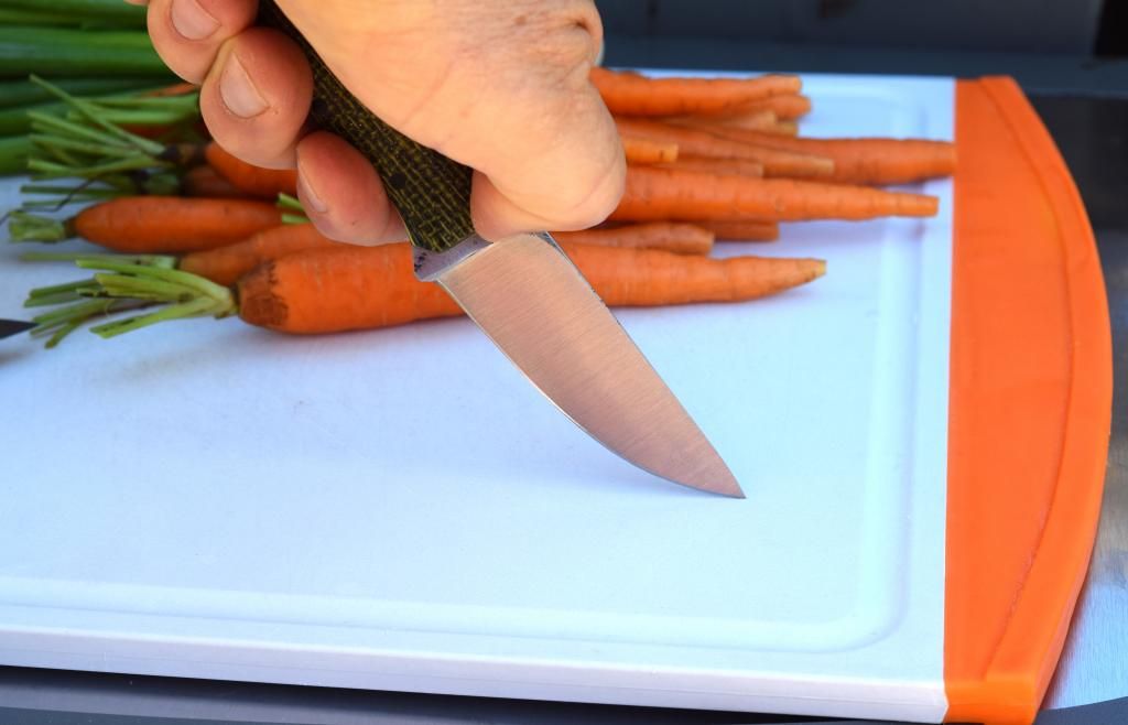

The first thing that I did was to compare what I call the “angle of attack” capability between these two knives. I am not sure if that is the proper term, but I use it to mean how high is the handle when I rock the blade all the way forward toward the tip of the cutting edge. I also considered how far I could rock back before my fingers hit the cutting board while using a standard grip.
Here are some photos to show what I am talking about.
Patch Knife:
Hiking Buddy:
The result was that the Patch allows a higher angle of attack than the Hiking Buddy. Over the full rocking motion, the Patch also puts more edge area to work (1.900” ) than the Hiking Buddy (1.500”.) This is due to the straighter spine and more belly on the Patch. The difference of .400” in cutting area may not sound like much, but it is very noticeable on a small knife.
The Patch did very well in the paring knife role.

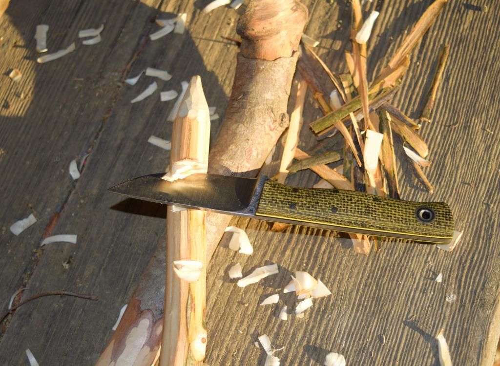

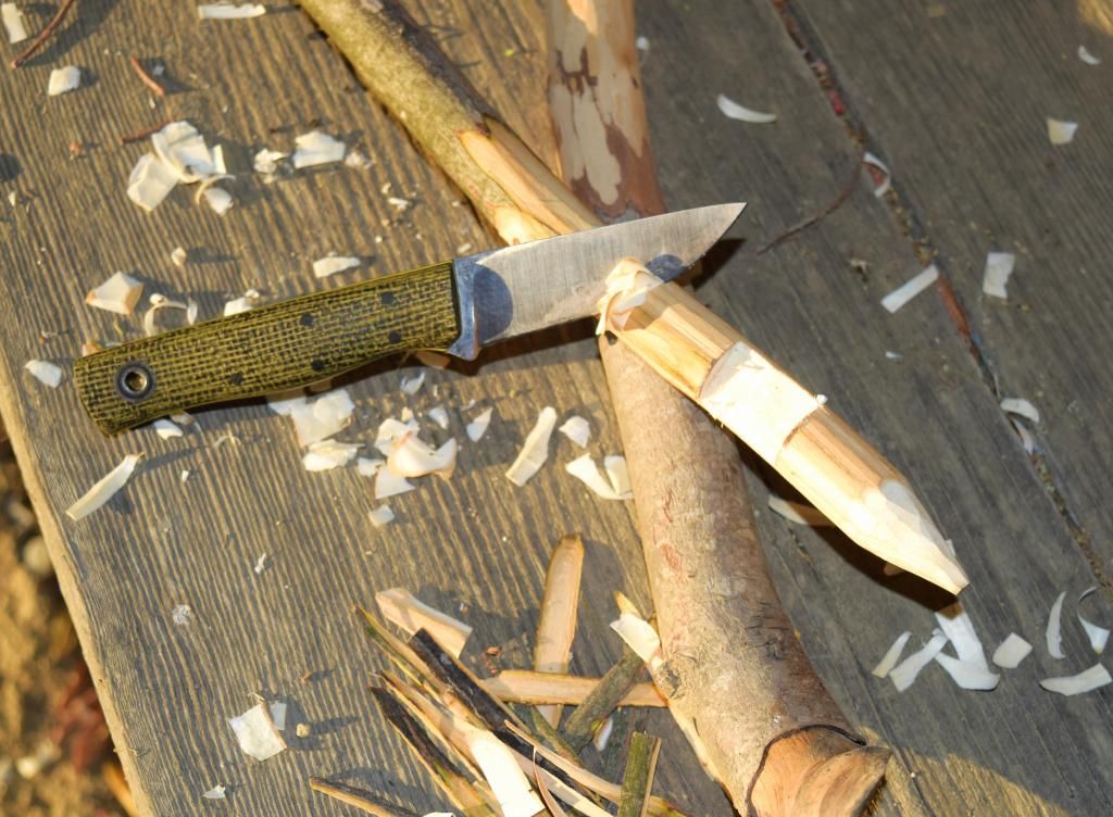

Wood Carving Notes:

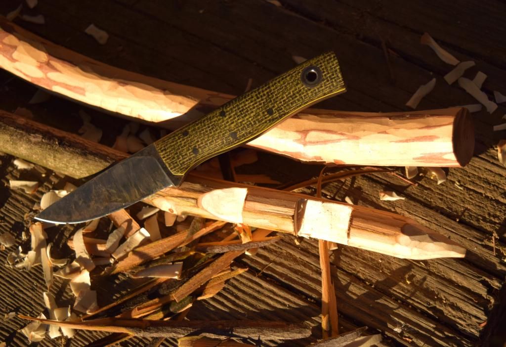

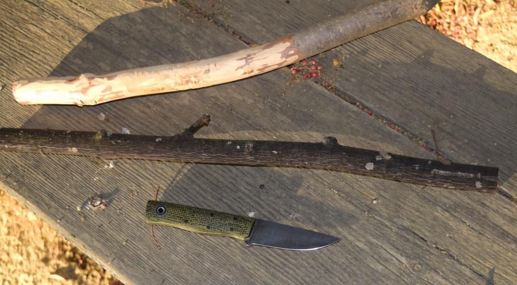

I wanted to try the Patch for a little wood carving. I grabbed a piece of Silver Maple along with my favorite baton stick to use for this. I was running out of daylight when I started this activity. You can see this from the long shadows in these pictures.
I used the Patch to peel bark, cross-baton, carve notches, and sharpen the end of the stick like an impromptu tent peg. None of the these tasks caused undue stress to the knife and it performed admirably in these roles.

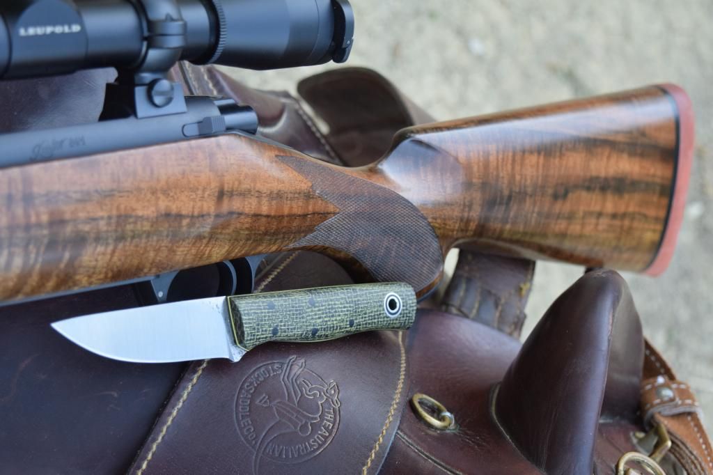

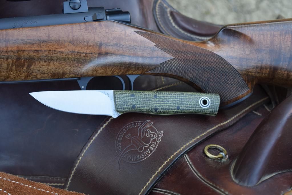

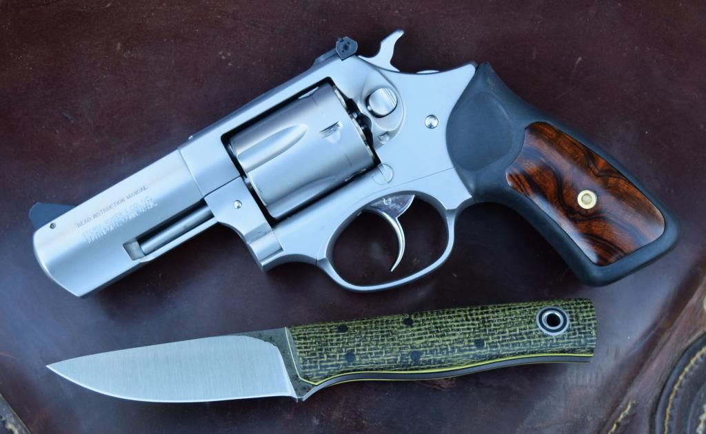

Historical Notes:
As part of my prep for this review, I researched for historical information on Patch knives. What I discovered was that this is a controversial subject with strong opinions on several sides. Some people claim that 1800’s trappers and/or hunters used a small knife like this to cut the excess “patch” material away when they were loading their muzzleloaders. Other people claim that this is BS and that no such specialized knife existed. Folklore or fiction? I don’t know. I could not find a standard pattern of a “Patch Knife” that proved what was true. The romantic part of me says a small 3” knife like this makes a lot of sense whether it is cutting patches or other come-what-may utility chores that occur in the field. In contrast, the critical thinker in me says that a wise trapper/hunter in the 1800’s would have already cut a good supply of patches to hold him through the season. That is not to say that a small practical knife like this wouldn’t be ideal to pre-cut those patches. It really doesn’t matter to me either way because I like this knife either way. I have an excess supply of 12 guage cleaning patches and no shotgun, so maybe I will use the Patch knife to cut them into smaller patches to clean my other guns.

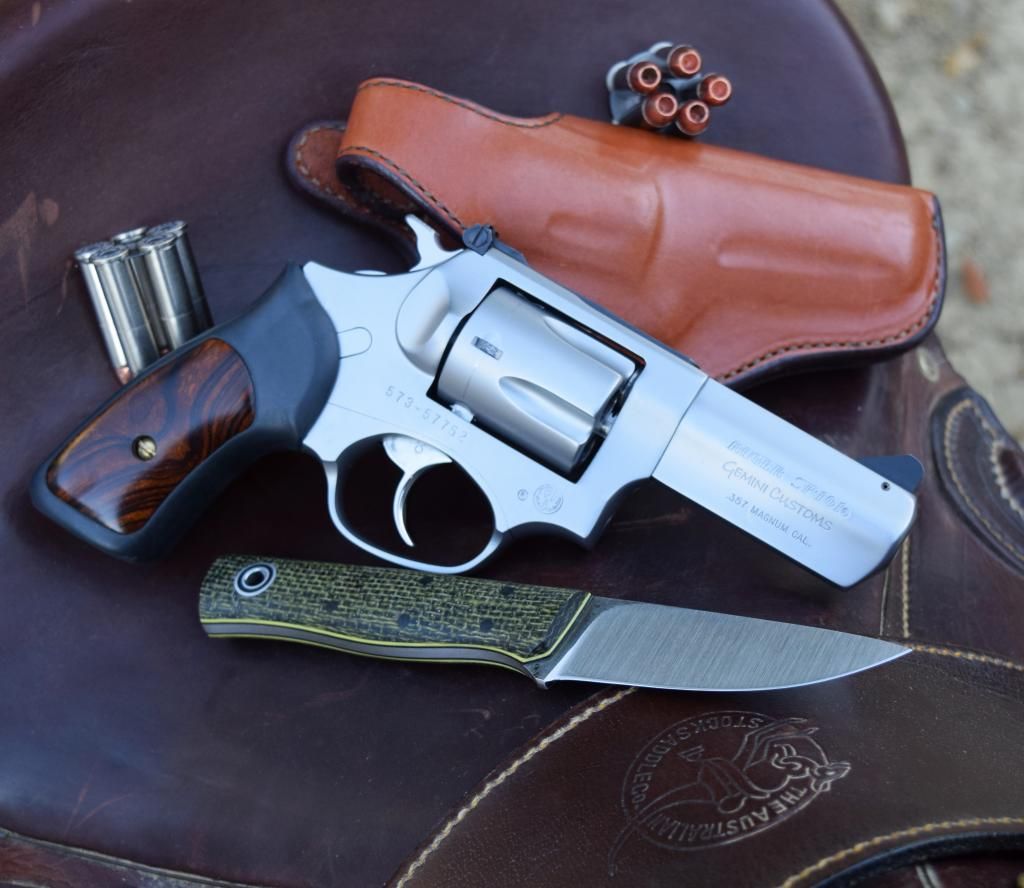

I don’t own a muzzleloader, but I do own a nice hunting rifle. Andy’s modern interpretation of what a classic Patch knife is blends well with a modern classic hunting rifle. I would have no problem carrying my Patch knife as my only knife on a remote camp hunting trip along with my .308 Kimber. Both have classic lines that I don’t see going out of style.
If I am traveling light on a scouting or distant hiking trip, the Patch would pair well with the small .357 Magnum revolver that I carry on those outings.

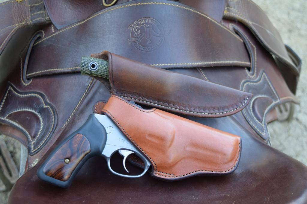

Any sheath designed for the Hiking Buddy, should work fine for the Patch. I purchased the sheath shown here from Talfuchre (Diomedes Industries.)
