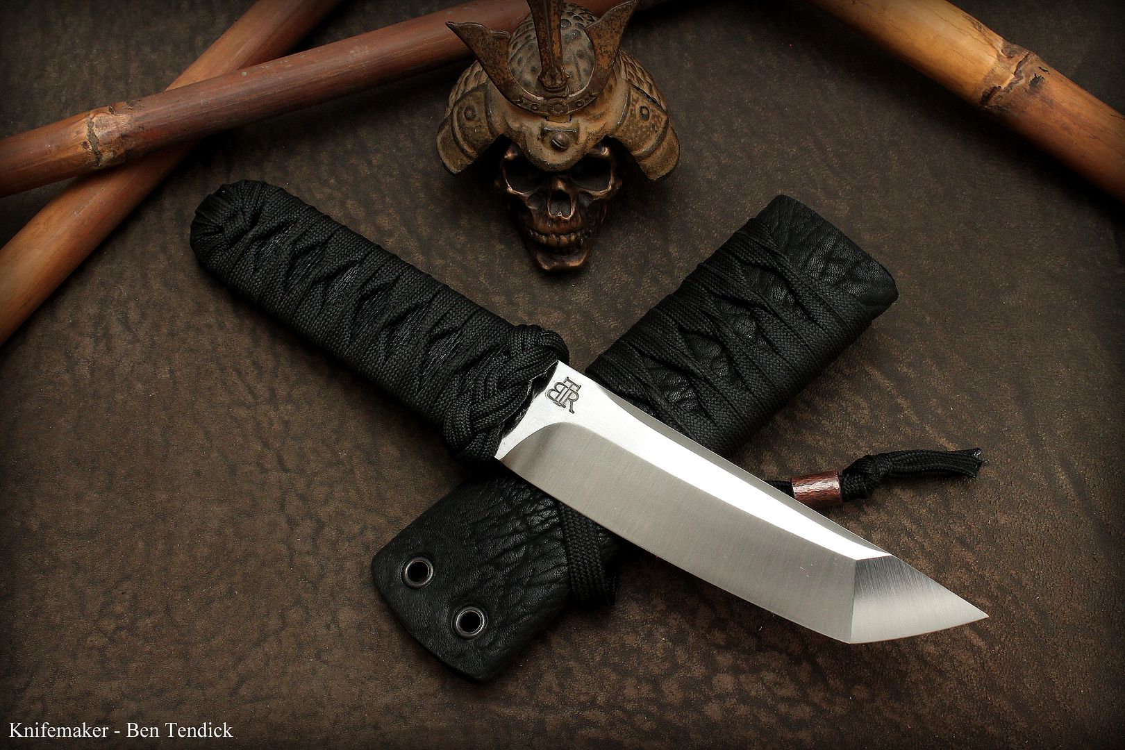

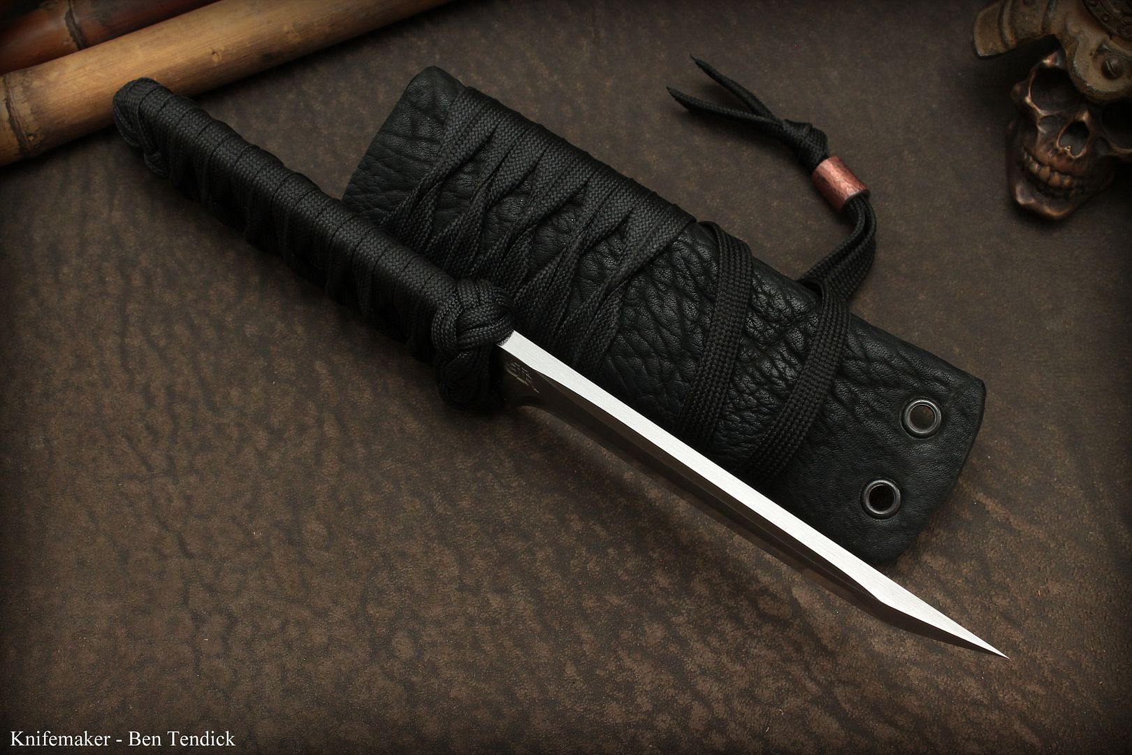

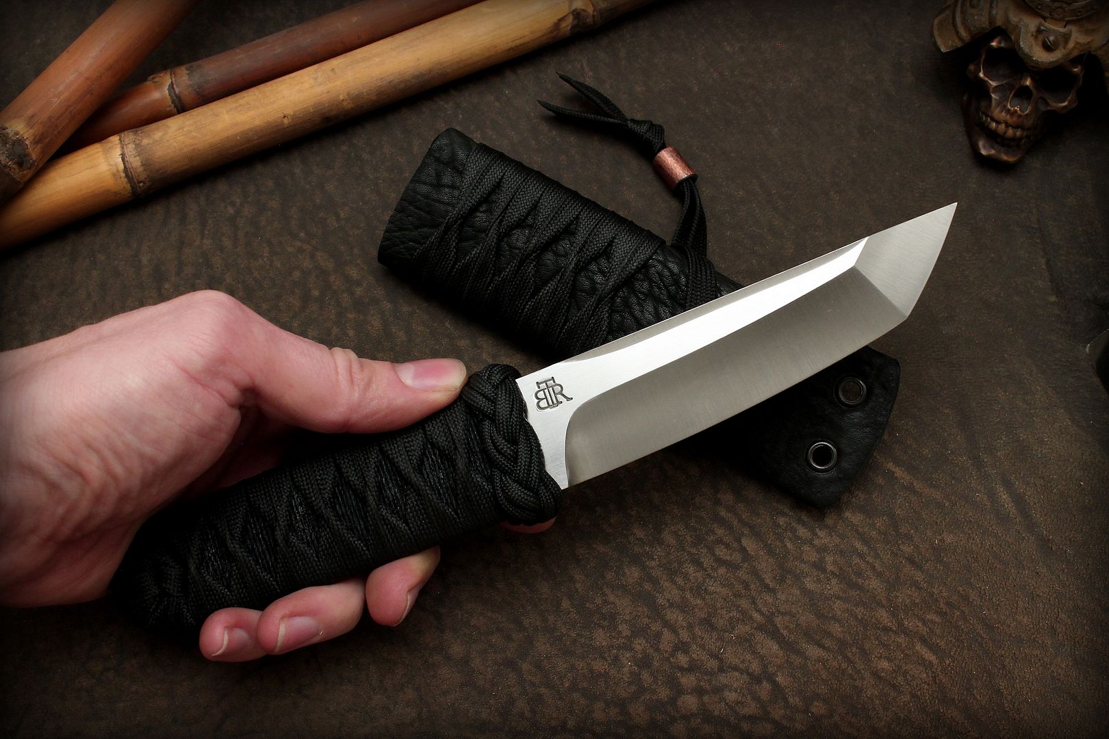

Needs resin, but here's the knife with wrap and turk's head knot:
5.25" blade, 3/16" stock, 4.25" handle, wasp-waisted grip with the last bit of awesome matte charcoal grey rayskin I had. Zero ground and buffed edge. Icky sharp.
Hate working on these knives, as I like sharpening a blade when it's DONE, not partway through the process! Cut myself twice with this damn thing...

All done. Pretty pleased with with how everything came out....
I hard stamped my mark, for that old school PH kinda look. The sheath is suede lined, bison wrapped aluminum.
The steel is .210" Cpm 3v.
