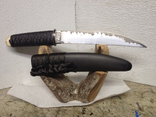

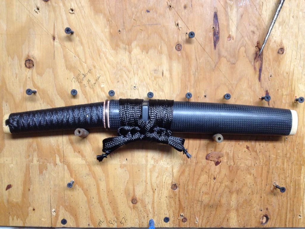

I am going with a more of a Hartsfield-esq finish on this tribute knife for the fun of it.
Sorry, Doug - just caught your question. Unless you're using a water quench, usually there's no sori unless it was formed intentionally when the blade was profiled.
To more indirectly answer your question, and I think address what you're asking a bit better, though, the spine of these knives are almost always dead straight, but the contoured grinds impart a sense of curvature, albeit an optical illusion, however. Is that what you meant?

And you'd be right, but that's only a phenomenon that happens with high carbon steels and water quench. In fact, there's a tendency for the same steel to curve DOWNWARD in an oil quench.
Tool steels like A2 and CPM3V tend to stay right where you left them, more or less. :)

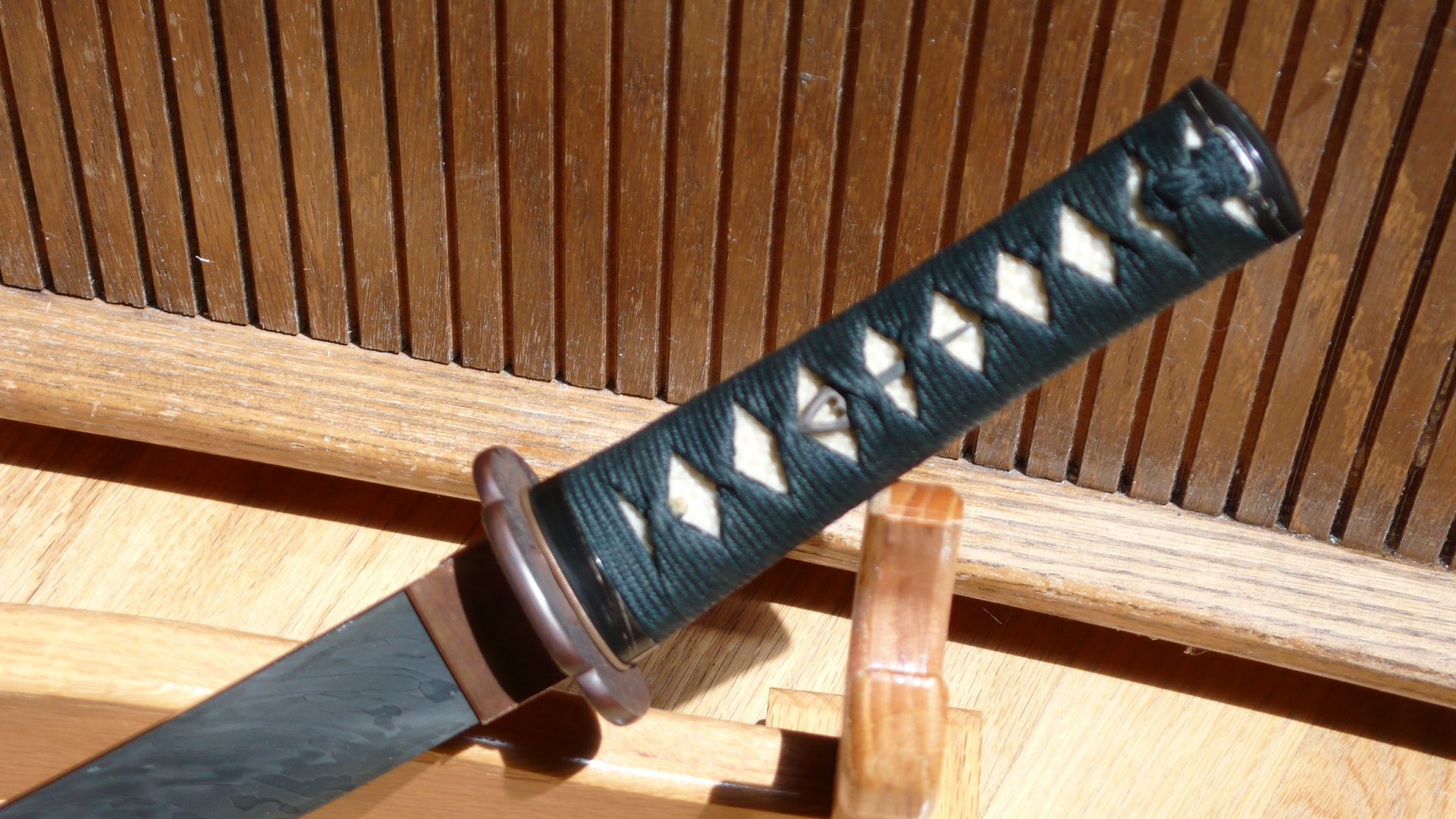

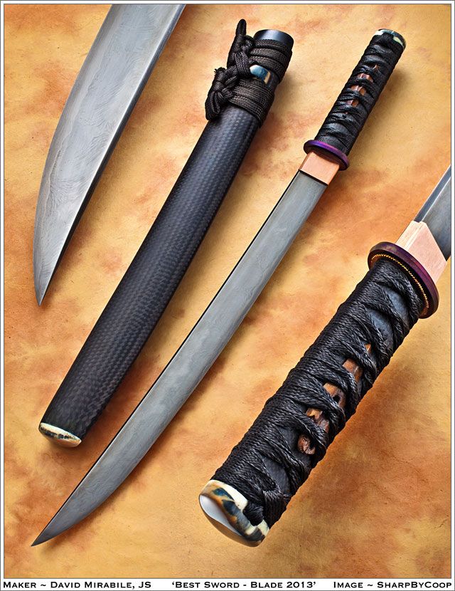

This is a Tanto by David Mirabile that shows what is being discussed I believe
Notice the angle of the handle (Tsuka) to the blade ...... Than add the blade curvature
The Handle looks kicked back so to speak
This is a style that I believe echoes back to 17 Century Japan
At that time is war'ing was business ....... Business was good
IMHO the handle kicked back even though not as esthetically pleasing to the eye does facilitate cutting very well
This pic of it in its saya really shows the handle angle well

And so does this beautiful Wak from David Mirabile
