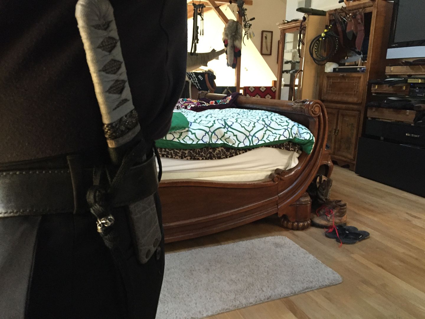

Ha! Thanks again all, I'm sure it's plenty goofy in person. Here's the knife in its sheath. Black deer panels over a smooth cow hide structure, stitched around the edges - pretty much standard, except instead of a belt loop, it just has the triple-ring which is only secured with deerskin lace tied in a bow. :) Can't wait to see the next rendition. Who's it gonna be? :)

Great slim package
You really stepped up and did a great job
I believe you grasped what I was trying to say about what this style of knife is and what its carry ability is all about
In addition
Imho you do not want a loop or a belt strap
To really carry well they need to be sash or iwb carried and it has to be a floating system
It must be able to adjust and go from cross draw to behind hip to IWB to sash with out unsnapping anything
If your Sageo is long enough to tie it in place for vigorous movement and at other times act as a static line than you have nailed the sheath concept and the only thing I would question is the rigid ness of the sheath

Thanks much and the pleasure is mine. A slim package is my favorite, and the soft "stickiness" of the deerskin makes it nice to keep close and helps keep it in place. The rings are attached so loosely precisely because I figure they would be removed! :D The sheath is not very rigid, but they do get more stiff over time. Maybe a soaking treatment of some kind for the inner hide to make it more rigid would be an improvement, but I have visions of these lined metal sheaths dancing in my head.

Ben- Will you line your Kydex?
rolf
Depends, I personally prefer unlined kydex for the small fixed blades I carry. It's easier to keep clean and doesn't trap moisture. I also prefer to carry week side (strong side has the boomstick) inverted for an icepick grip draw. So I like a snappy retention on my sheaths.
The metal sheath I made is suede lined and leather wrapped with holes in the tip for a static line as well as having an Ito style sageo wrap.

fwiw, I like the wooly Velcro that C4 uses to line his sheaths with. This material breathes and can be cleaned. And of course, these sheaths can be taken apart.
One of my favorite Kydex sheath designs comes from the late Ed Halligan. He used a roundhead screw, screwed in the blade where a guard would be, and that screw snapped into a divot inside the Kydex sheath. A very nice design, indeed.

Ok guys, here is a teaser pic in the sheath.......
Suede lined, bison wrapped.

You took all my suggestions and Phills influence and really did great

Carrying a knife this way just works
You can go IWB
Sash cross draw or behind him
When it's free floated it moves and positions naturally
When you need to tie it in
The metal is so secure and safe
This type of carry has so many perks
