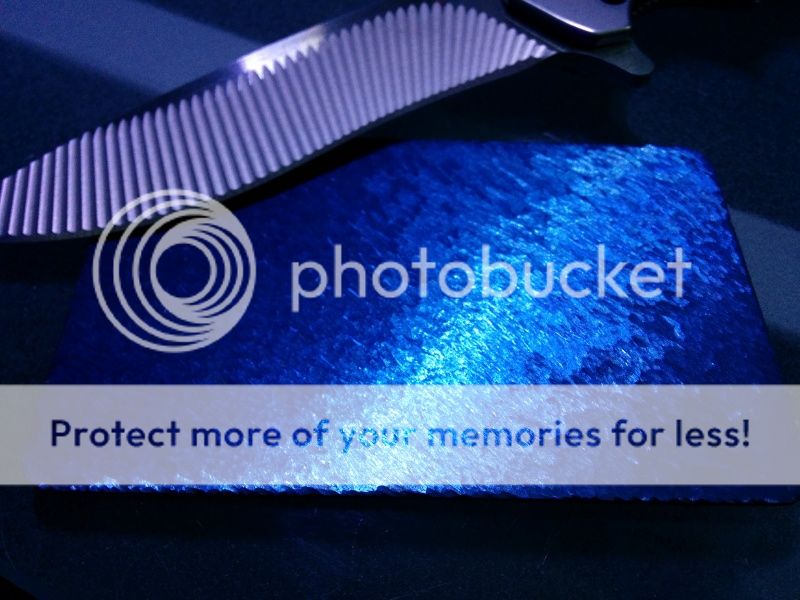

Not really a customized knife, but this is a DIY titanium credit card that keeps my wallet from flexing and bending my cards. This is my attempt at Todd Begg's "Cracked Ice" finish on titanium. I'm not sure if I'm confident enough to try it on one of my many titanium knife handles but I'm thinking about it.
What was your process to get that finish? I really dig his cracked ice, and I haven't quite seen anything else like it.
[video=youtube;ld7Kf1MnmyE]https://www.youtube.com/watch?v=ld7Kf1MnmyE[/video]
Watch closely at about 3:54 in to the video. They're using a small rotary disc cutting tool with light tapping motion in a random pattern. It's not difficult, but it was time consuming to do all the whole card.
Thanks, looks like I'll be doing some experimenting today!
