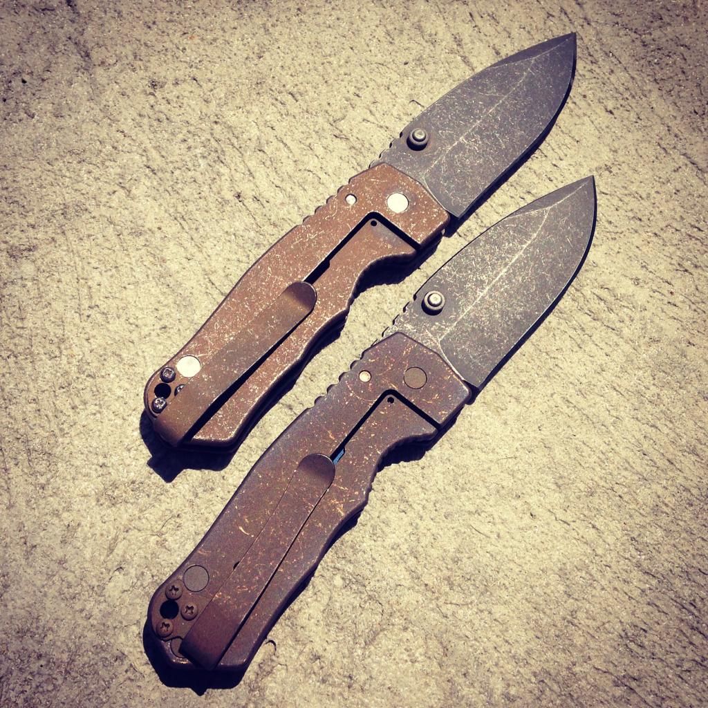

Pics of customized production knives

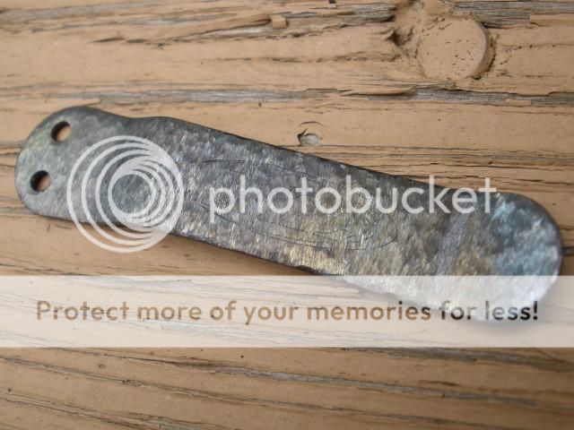

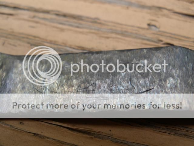

Watch closely at about 3:54 in to the video. They're using a small rotary disc cutting tool with light tapping motion in a random pattern. It's not difficult, but it was time consuming to do all the whole card.

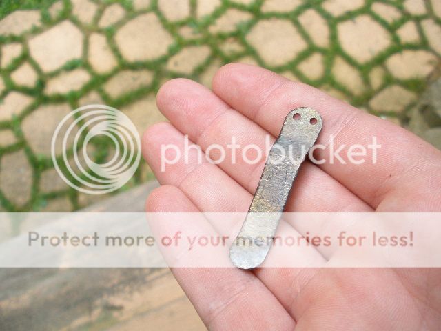

I got bored so I took a spare clip and did the cracked ice finish then I heat anodized it :D I'm probably throw it up on the bay to help fund other projects :D

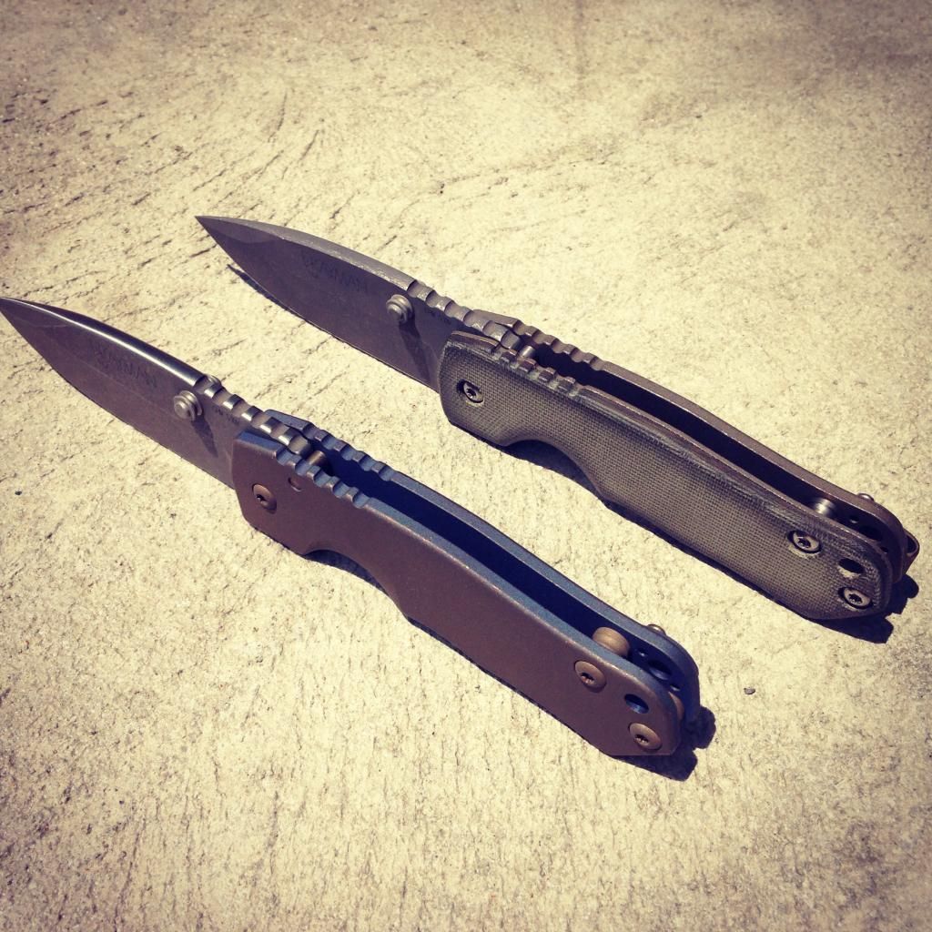

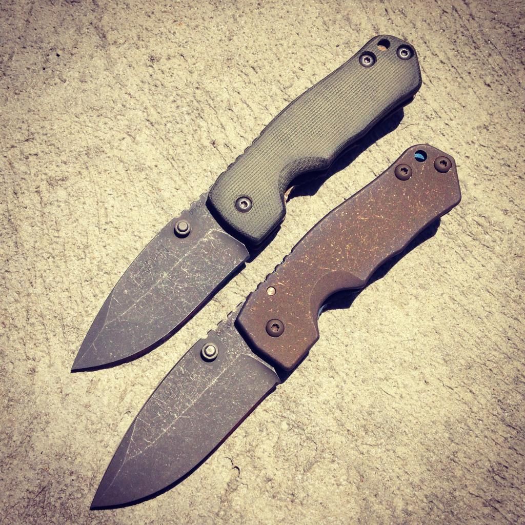

Orange Mini tuff lite with a deburred serrated blade swap and a clip flip. I used old laptop plastic case screws.
how do you inlet the holes in the scales for the screws?
I counter-bore or counter-sink using step bits when possible.
If no step bit is available......I drill a pilot hole ......drill my counter-bore then drill my through hole.
