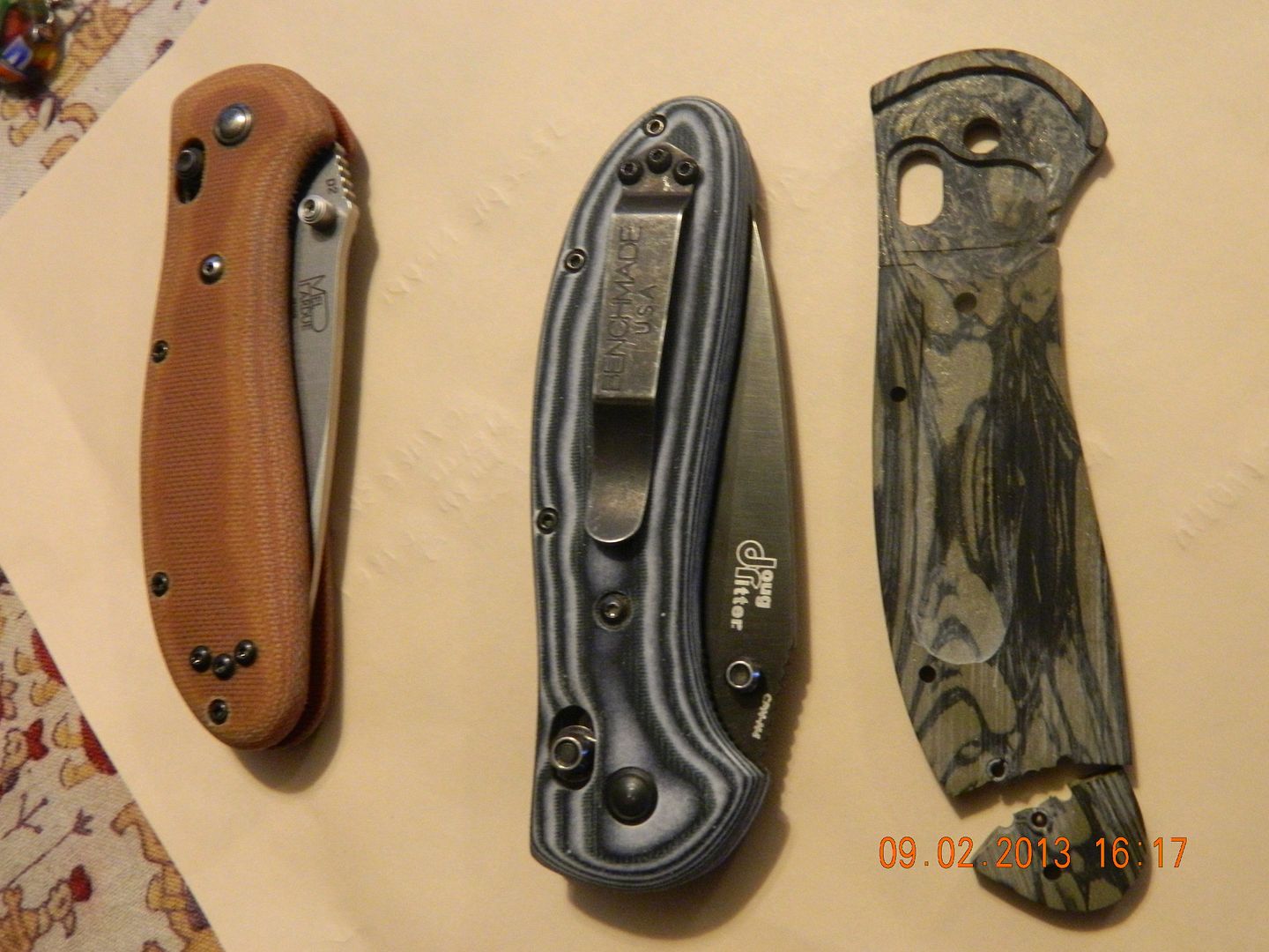

First and second attempt at modifying knives.
Acid stone washed the blades, liners, and pocket clips.
Oxi-Clean boiled and stone washed the titanium scales.
Reshaped the 0801 into a wharncliffe styled blade.
^^^Those look like Barrage Liners. Way to recycle designs.
Now that I'm looking at the blade, it also looks similar to the Barrage. It looks like they changed the grind slightly, reshaped the G10 over the same liners, and called it a different knife.
I had to glue it together with acrylic glue. If you look close you can see the line. I am going to try and make my own with epoxy and glow powder someday.
Here's what I had to re-create on the back side of the scales...

The inside of the scale picture is the factory scales, not mine.
Those scales are enroute to the customer.
So, I am unable to show what the back side of those look like.
Mine don't look just like that, but when hollowing out G10, kirinite, or juma they do come out very clean.
Micarta, TeroTuff and Damagrip is very fiberous, so cut's are not as clean.
I use a tile cutting bit.
They last longer than most of the others I've tried.
However, one must be very careful when using a fresh/new one; the are very sharp and can easily rip the matreial you are routing right out of your hands.
Once the bit dulls, a bit, it is much easier to control the feed.
