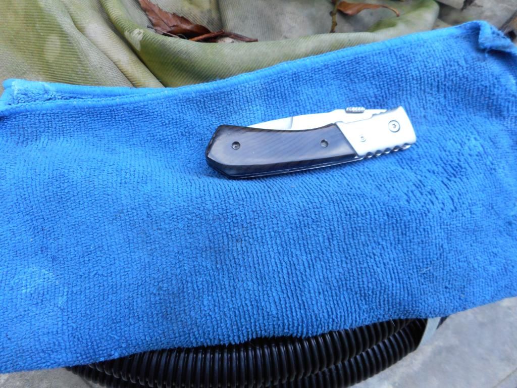

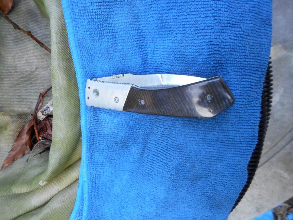

The knife is nothing special but the handle wood comes from the ship wreck of the MV Malabar what was built in 1925 in Scottland and then in 1931 sunk off the east coast of Australia. The ship was suspected of bringing opium in to Australia for the opium dens in China town Sydney. The handle wood was under water for around 80 years. I dove on the wreck a couple of years ago and salvaged one smallish piece of timber from a hull stay ,I dryed it out for a couple of years it was very brittle so I stabilized it with a couple of coats of resin .I couldn't think of a better thing to do with it than trying to make a knife with it.
Awesome handles, even more awesome story.

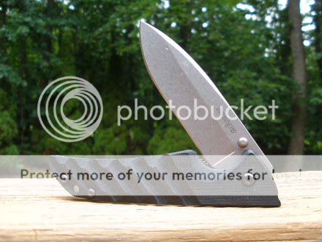

Cold Steel Recon 1 Tanto
My first customized knife. Quite alot of work in this one. All of it was the first time I'd done the work.
For the vine on the lock and back of the knife as well as the anso pattern I used a dremel. After the initial pattern I remove the dremel sand paper and wrap duct tape sticky side out around the sanding drum so that I can attach my own sand paper. Sanded both to 2k grit and buffed with mother's. And turtle wax on the scales. Polished the blade and all other metal components.
Doesn't seem like a lot of work written out like that but I bet it took 6 hours or so to polish the blade, around 7 to do the vine pattern, and 3 or 4 to do the scales. Maybe more, I never kept track. A few late nights into it though

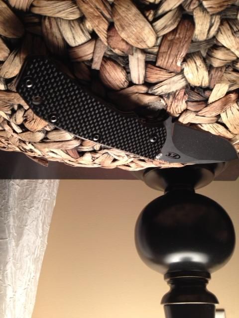

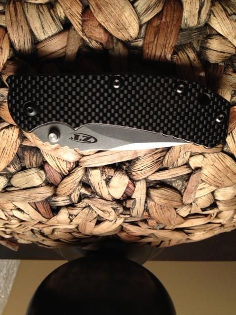

Decided to start making custom scales just as a hobby, might start some selling them soon. All hand made, just need to prefect some things, let me know what you think,

Looks like a nice start. If you really want to sell, you need to take better pictures. Can't see any details. Oh, and you'll have to upgrade your membership to 'knifemaker/service provider'.

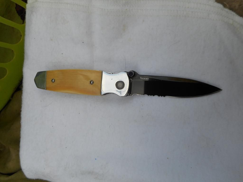

A hobby of mine: turning old M7 & M5 bayonets, jet pilots knives and USMC fighting utilities into something a little more interesting. I mostly sell them on ebay or at local knife and gun shows. Note the colored spacers on one of the 1917 Knuck Knives: the colors of the VietNam service medal.
Sooo cool!
Im doing an old m7 atm, did you weld more tan g to yours for the pommel? Cuz my tang is only a few inches long..
