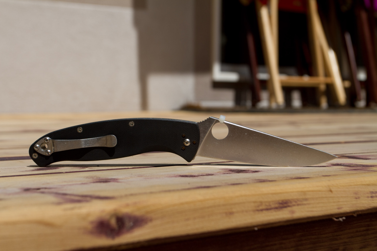

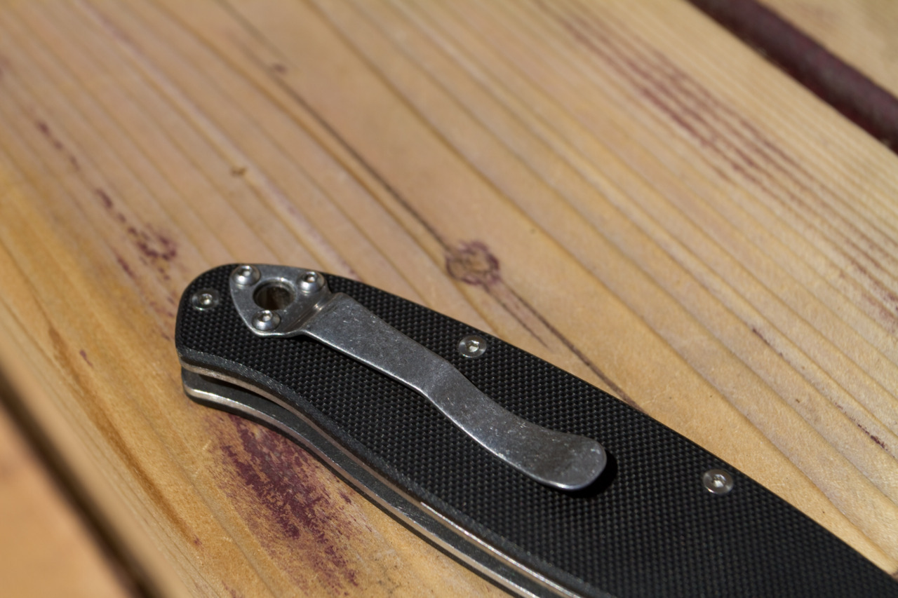

This is an awesome thread. Very inspirational. Here's what I did with my Spyderco Resilience:
I reshaped the blade.
crowned the spine (this was way easier than I thought it was going to be)
stonewashed the blade, liners and pocket clip
This was my first time doing anything like this, and although not perfect, I'm pretty happy with the way it came out.
for reference, here is an original resilience:

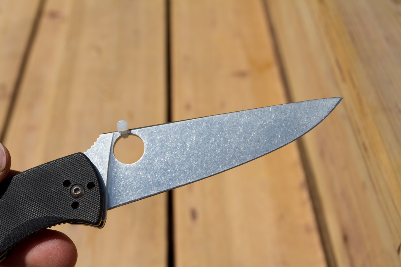

How did you do that stonewash? Looks great.
Hey CrimsonTide, it was super easy. The first step is to find a bunch of smooth stones of various sizes and put them into a container that is large enough to accomodate the blade and whatever else you want to stonewash.
Then spray a liberal amount of WD40 onto the rocks (I don't know why you need to do this really, my guess is to reduce friction)
drop in the blade and close the lid. Then you have to shake it for about an hour or more.
-What I did was wrap the container in a towel and put it in the dryer with a bunch of other towels, to prevent damaging the dryer, and let it spin for an hour. Much easier.
Then you just have to resharpen the blade.
Be careful with higher carbon steels though, like tool steels because they may chip if you are not gentle enough.

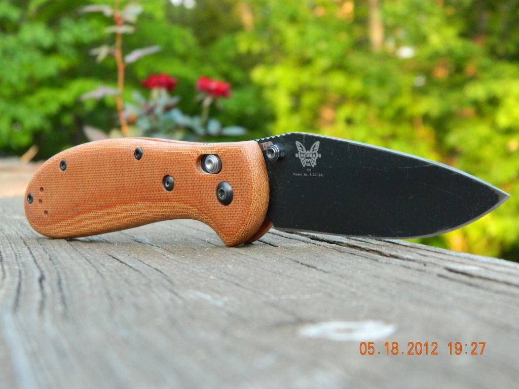

Here is my Benchmade Mini Warn. I removed the tanto, and reground it into a full convex with a BM Stryker profile.
