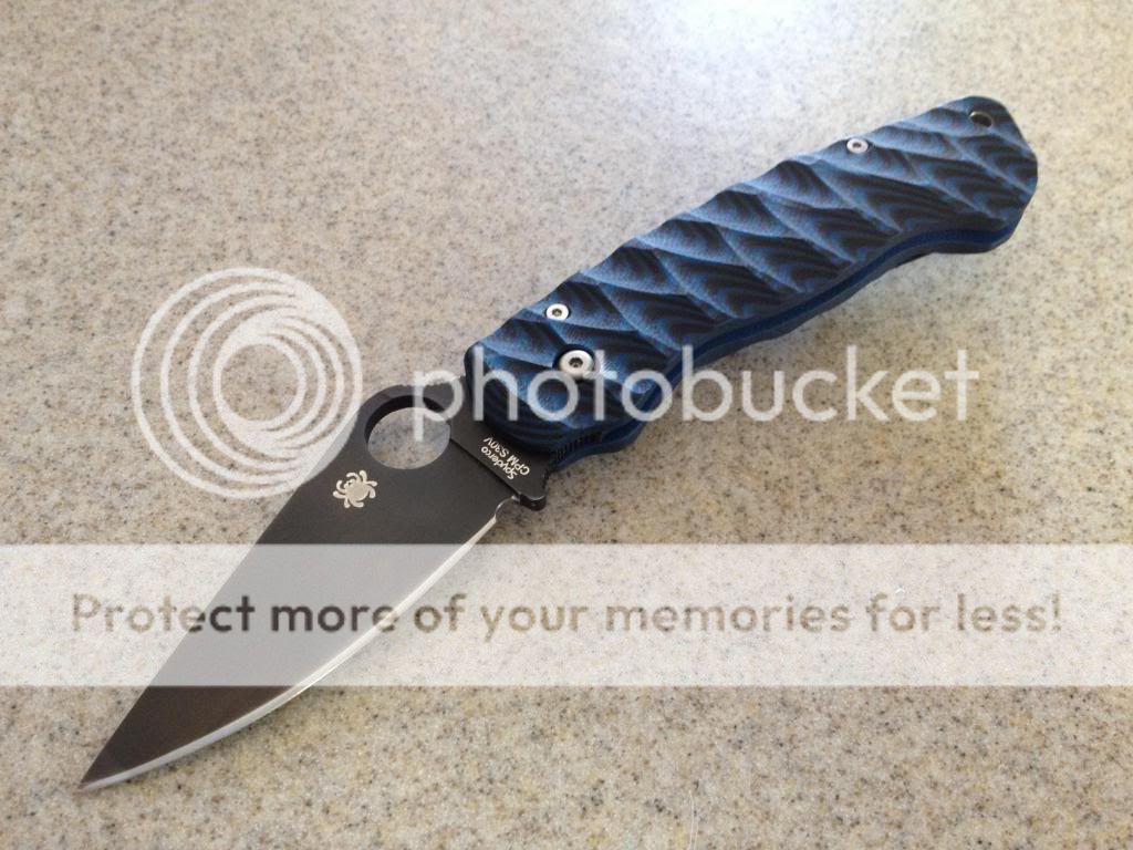

Did a little bead blasting today.
atony,that looks good.The pocket clip is the only thing I even slightly dislike about the Southard. I am going to give this a try.

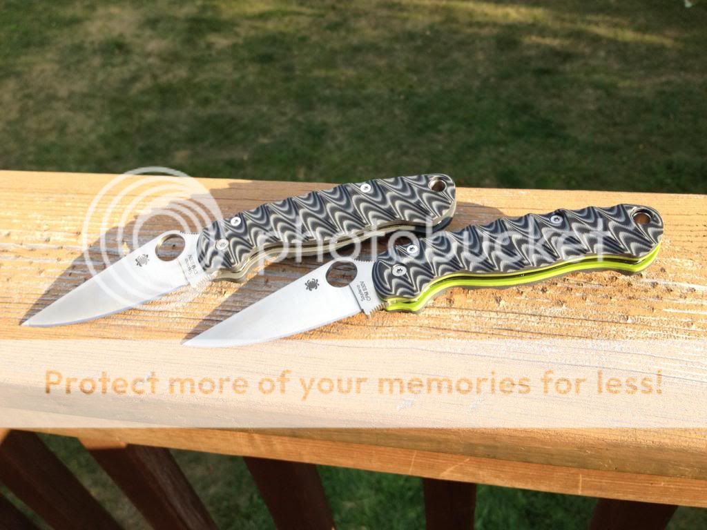

I did the same with a green-scaled Tenacious. The first knife I bought that got me back into knives was a Smith & Wesson that had green scales & black blade & hardware. I used than one 'til it died, and I've always wanted a knife along those lines that was a nice reminder of the first one. I just didn't want to spend any money on an S&W.
I actually like the look of the blue scales & black blade & hardware better. I'll have to do that one next. :thumbup:
