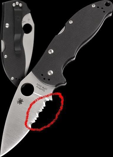

LOL who cares what it looks like?! One of the points of S30V was to be able to support edges like that, since ATS34 and such couldn't. And from most accounts, it can't. I just think many people expected to much from a stainless. It holds an edge longer than the other super steels in rough materials, but other than that is pretty much the same as other larger carbide steel. Good steel, when its 15 deg or thicker. Any thinner and it seems your playing Russian roulette.
looks like the knife was used instead of wire cutters (wire cutters being the RIGHT TOOL for the job). Nasty knife abuse there......wonde rif you can sharpen dents like that out? :eek:

What did you do to that grind?:barf:
I changed the grind to be optimized for cutting applications I regularly preform. That is the function of a knife. This knife cuts better than my Opinels.
Right tool for the job? In the review this was done to see the limits of S30V. I stated I thinned the edge out like this and experienced no durability issues in anything I cut on a regular basis, so I purposely took the edge to more damaging media to see it's limits and how it would fail once reaching said limit. With the intentions I had in mind, using wire cutters would of been the wrong tool for the job, unless I wanted a reference point to compare the UKPK to. I did this for the same reason I've chopped wood with Opinels, to see how the knife, and in particular the steel and geometry used, handles the task at hand. I prefer more concrete results regarding what my knives can and cannot do rather than basing my opinion of such on the second hand experience of others.
I wouldn't call cutting household coax cable abuse. If it's copper core it won't hurt anything at all, seems that it was some steel core stuff, even then I wouldn't expect that level of damage to a hard knife edge.
Correct, it was some sort of steel core. I've cut other cabling with the same knife without issue. Also note how other knives in tougher steels with thicker edges didn't really do any better except the Mule.
